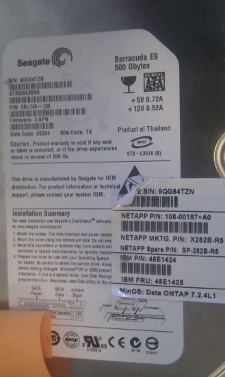

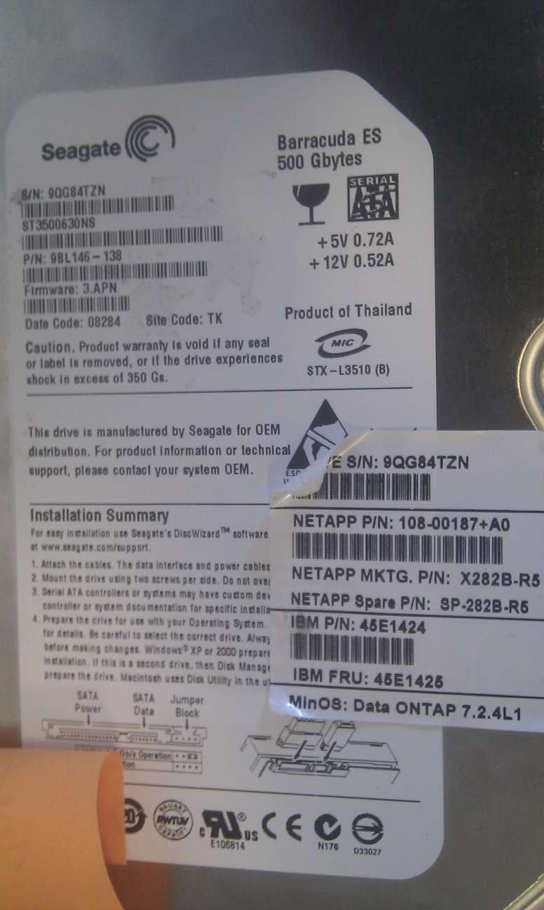

In one of this HDD, there is a label over the segate label where it's writting
DRIVE S/N 9QG84TZN (same as seagate)
NETAPP P/N : 108-00187+A0
IBM P/N 45E1424
IBM FRU :45E1425
MinOS : Data ONTAP 7.2.4L1
Do you think it's possible IBM or NETAPP rebrand seagate ?

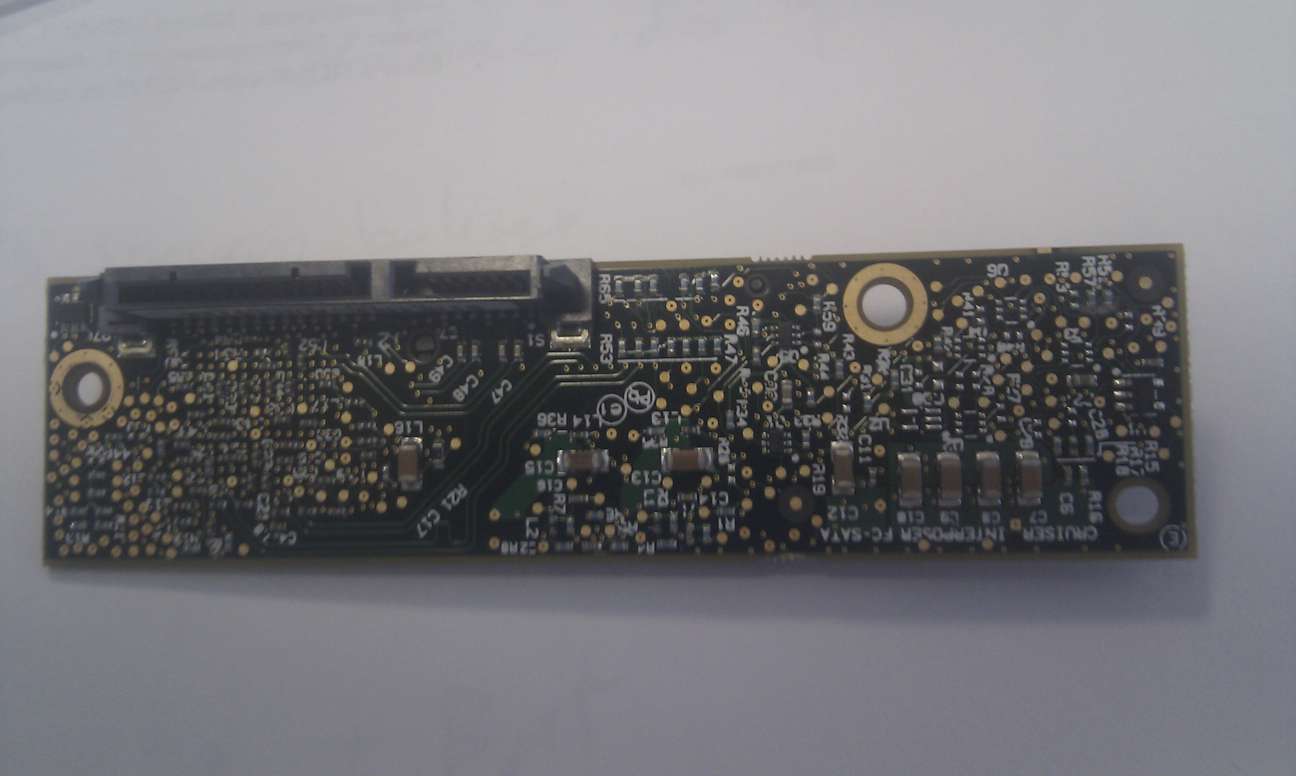

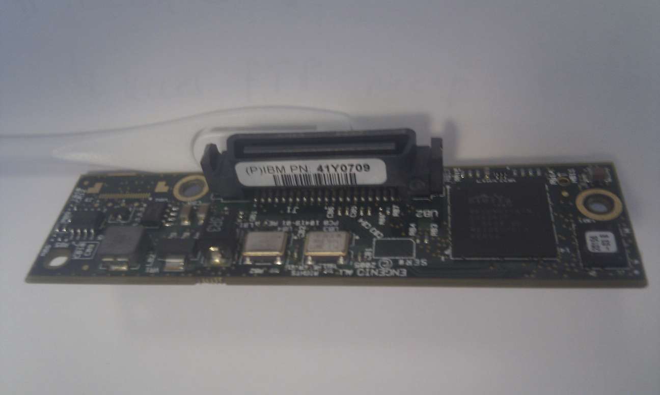

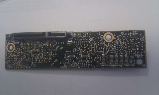

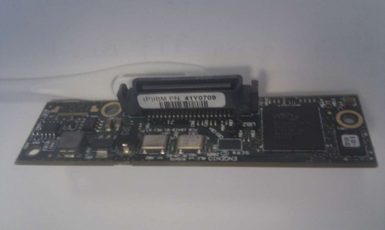

for the interface, it not a simple passive connector I attemp to put picture just after
I know the usb sata interface limit, with all my other HDD I was around 20 MB/sec
with another HDD from the same sas but labelled IBM (and inside label another label seagate e-server) i have around 20MB
but with this particulary model only 7MB I really don't understand
I don't need 500go more storage, I don't need this HDD, but i wan't to understand why this limit..
If it's not from firware,where it could come from ?
thanks

front interface
 Post subject: Re: Seagate ST3500630NS Barracuda Es 500Go low transfert sp
PostPosted: September 19th, 2014, 4:04
Joined: September 16th, 2014, 3:11
Posts: 20
Location: somewhere
rear interface

the 2 label (originally ibm label was over seagate)

As for the "Cruiser Interposer FC-SATA" adapter PCB, it appears to be similar to the following "Emulex/LSI Logic SATA to Fiber Channel HD Interposer Board, P19510-02-A":

hello,
Yes it's look to be the same adaptor.
My problem is simple, but perhaps is the solution i dream is bad:
I have 4 hdd from an old sas
all the 4 have the adaptor sata->sas
2 of this drive are rebranded IBM (originnaly seagate e-server 500go)
2 of this drive are rebranded .....like picture not really a new brand but NETAPP is writting on.. originaly seagate barracuda ES 500go
when I plug the "e-server" to sata to usb adpater, i have aroud 20MB/s
when I plug the "barracuda ES" to sata to usb adpater, i have aroud 7MB/s
I test it with lot of adapter and lot of pc
I my mind, problem come with the firmware 'netapps' but perhaps it's a mistake?
PostPosted: September 26th, 2014, 15:41
Posts: 16960
The adapter is FC-SATA, not SAS-SATA.
http://en.wikipedia.org/wiki/Fibre_Chan ... _connector
I have no idea whether 3.APN firmware is OEM or retail.
