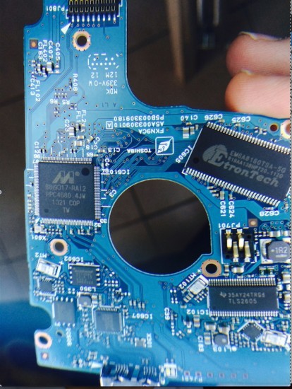

einstein9 wrote:
have an idea here for you
can you post the image of the PCB here?
:wink:
not yet have a photo because not opened the case ... so I put here in open forum

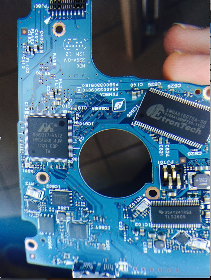

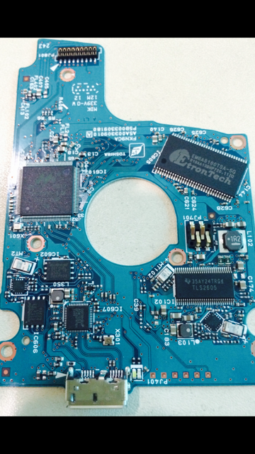

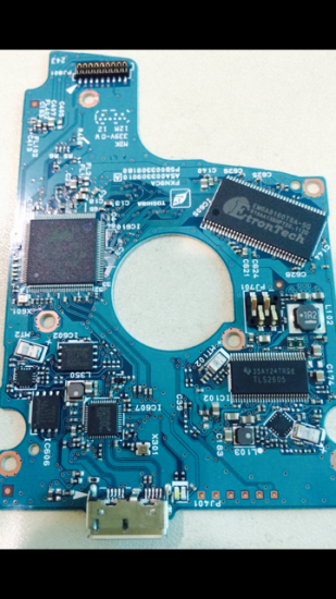

 Post subject: Re: HDTD105XS3D1
PostPosted: September 17th, 2014, 8:15
Posts: 1060
sempre wrote:
:wink:
new photo!!
Нет ничего невозможного
PostPosted: September 17th, 2014, 14:22
Posts: 17215
AIUI, you can access the drive's security settings in terminal mode. If you don't know the location of the Tx/Rx pins, then you could experiment with the obvious candidates, or you could obtain a SATA board with the same MCU and locate the Tx/Rx pins on the MCU by working back from the known Tx/Rx jumper pins. Now locate these same MCU pins on your patient and trace them to your likely suspects.
:wink: :idea:
