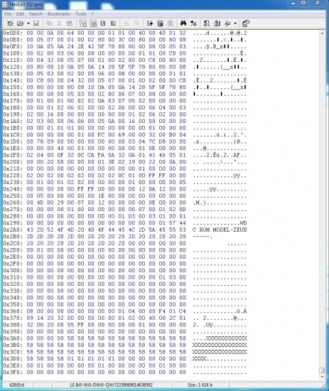

I'm having strange issues with this one. Maybe someone with more experience with this family can help.
I'm working on a Zeus family, 8 head, rampless nightmare. The drive comes ready but just shows "Zeus" as Model and "XYZ" serial and shows no capacity. It can however read modules/tracks just fine from both head 0 and 1 (reads them fast actually, not typical of head damage). It can even read the MBR at sector 0 in sector edit.
I first tried hot starting it by disabling all heads in RAM except 0 or 1, but same result. I even tried disabling all heads in ROM except 0 and then 1 - same result.
Then I attempted to smart hot swap (before I realized this family won't go to sleep). After writing all tracks to the donor and using patient PCB, I attempted to start it up but even the donor ID's the same way - no capacity or ID. I've done module checking in the module table, all pass except a couple log files (which are listed as un-important and I tried replacing from donor)
I'm pretty sure this rules out the heads as the issue, since the donor does the same thing.
Any Ideas?

Update, I'm thinking this drive was sabotaged.
I checked module 2 and found that it doesn't even contain the drives serial number, model, etc.
I replaced it with module 2 from a donor, and now the drive shows capacity, has sector access, reads/writes data just fine, but it's all blank except for the very last sector (EFI Information) as far as I can tell.
My guess would be someone or some virus did a number on this one. Anyone ever heard of a virus that can tweak module 2 of a hard drive??? Only reason I ask is that the guy swears he didn't take it anywhere but here.

What did module 2 look like? Are you aware that there is sometimes a backup copy in module 802F?
FWIW, people often use HDDHackr to modify their drives. HDDHackr makes changes to modules 02 and 0D. Specifically, HDDHackr changes the firmware version in 0D and the model number, serial number and capacity in 02. This doesn't explain the null data, though.

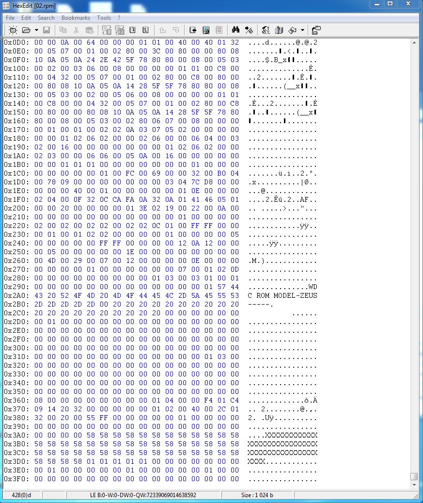

Here's the original Module 02 before I replaced it. Doesn't look like any I've ever seen for Zeus, but it almost perfectly mimics a drive with bad heads.

I see now that the drive is an older model with 2-byte module IDs. HDDHackr only works with ROYLs. Sorry for wasting your time.

The drive works flawlessly now that I replaced module 2 (shown above). Imaged every last sector. I can't see how a hardware malfunction could remove the model/serial # and capacity from module 2. Just seems like sabotage to me.
Plus the first half of the drive appears to have been zero filled, another indication of intentional tampering.
