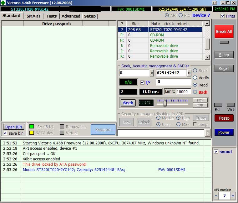

Does Victoria work on Windows 7, 64-bit? I keep getting portIO errors and I can't enter the password to unlock it.

This is what I see on my Victoria:
File comment: This is my Victoria Screen, after ignoring all those error messages.

Spildit wrote:
I don't think that the PortTalk driver will work on 64 bit machines. At any rate try to copy the drive to the system32 folder.
Again i don't think it will work because the requirments of 64 bit OS regarding drivers....
You will need to use another machine or boot from a Hirens Boot mini windows XP.
Ok, thanks. I'll use a Windows XP machine.
