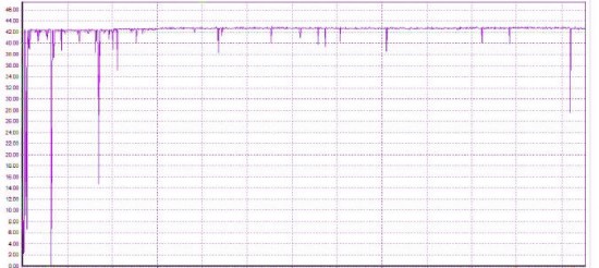

We have made a case study about this. I can't share the entire document, but in a nutshell, we took a drive (in this case a WD Tornado 320GB) and ran a surface scan. This is initial result:

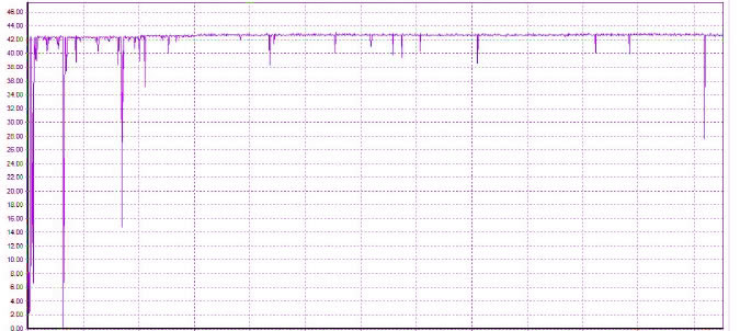

Then we opened drive in clean room, let it stand there for 30 minutes, closed it up and ran the same scan, in the same area of the drive. Here is the result:

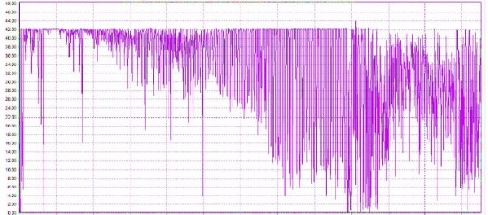

Finally, we opened drive in our workbench, let it stand there for 30 minutes, closed it up and ran the scan again, in the same area. And...
Out of curiosity, we let the drive run for as long as it could take. In another 15 minutes one of the heads died.
