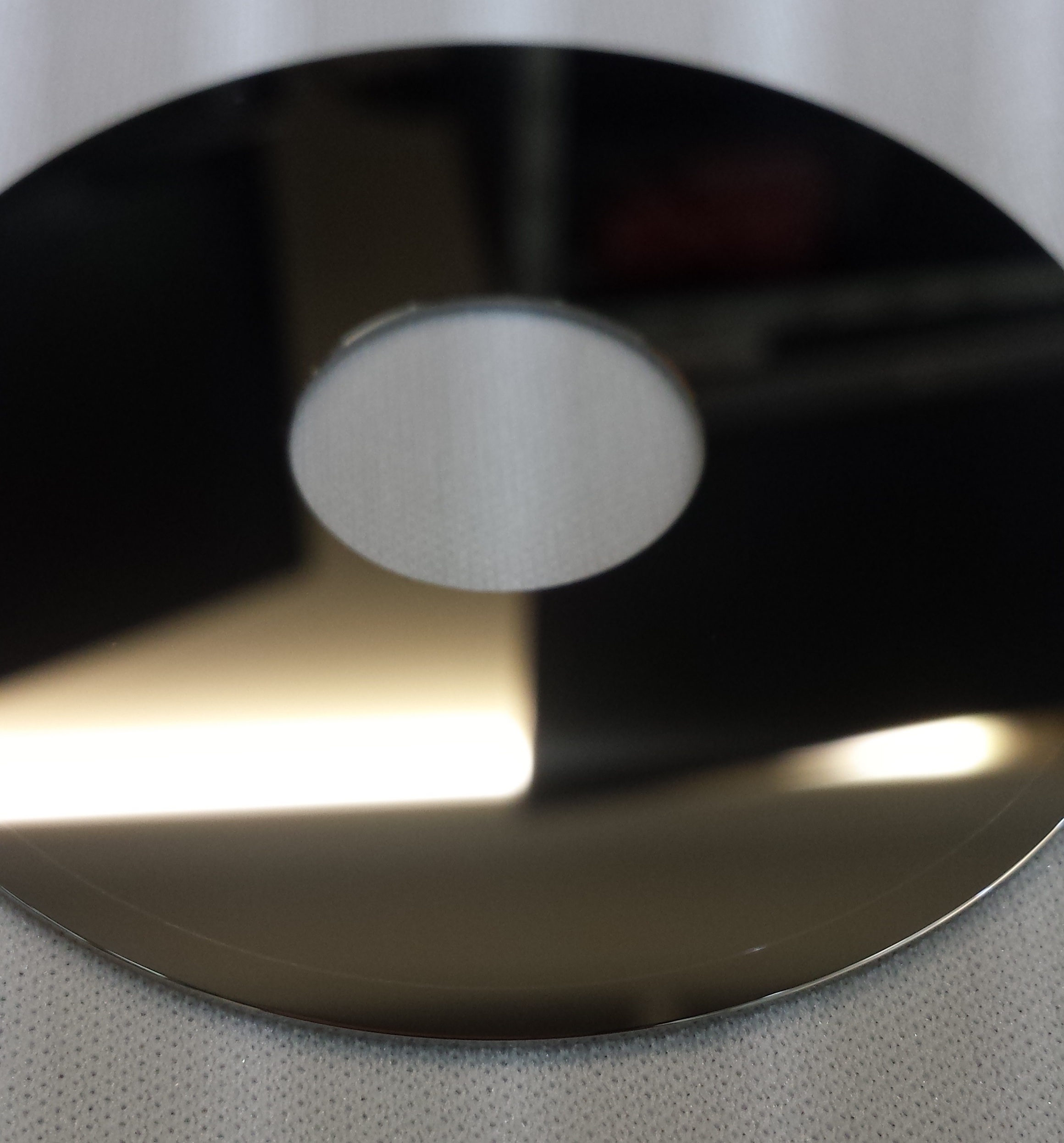

Hi All
I have a 1TB toshiba external HDD. I suffered a head crash, which has caused reasonable platter damage. What I wanted to know is, do you think recovery of the data is possible? There is possibly only 50B worth of data that I care about on the drive, the rest is essentially worthless.
I've gotten one quote for recovery from a lab, and they told me that it was unrecoverable, however their only explanation seemed to be that there is platter damage (I don't think they were even willing to try - risk too high). I've attached a photo - do you think it's worth getting more opinions? Or is the platter likely just a fancy coaster now and there is literally nothing left that I can do. I'd be interested to know if there is any way of recovering the data whatsoever, even if only a partial recovery (and even if a very pricey job).
Any input would be much appreciated. Thanks!

I think 1TB Toshiba has 2 platters. If media damage is only on one surface that there is a possibility to recover partial data from other 3 surfaces. Theoretically it could be about up to 70% of files (depends greatly on file types and condition of other surfaces, sometimes it's 0%)
The only problem now is to find a DR company that would bother(and have a knowhow) to recover from a drive in such conditions (disassembled). Also keep in mind that original flash chip is vital for recovery and original head stack is preferable.

thanks for the info doomer - that photo was provided by the original guys that said they wouldn't do it. I presume they are able to reassemble and keep everything aligned when they provide me with the drive again, otherwise why on earth would they go and do something like that? Apart from the damaged head and platter, I believe everything else is fine. It's a pretty large and reputable firm, so I don't (think) they are bullcr*ping me...

May well have been more easily recoverable before they took it apart, as the damage doesn't look that bad.
But now they've disassembled it (why???) it makes matters considerably more difficult..... :-(
Would you care to name the "lab" that took it apart?

Alignment for this model is not critical, so as long as it's assembled properly and doesn't have fingerprints it's OK

Hi all. Just a quick update. Kroll gave me a call yesterday to talk about the hdd in more detail. Essentially, they've said the data on their is completely unrecoverable. Although only one platter is damaged and it's not too extensive, the damage is in a super critical area of the drive making it impossible to recover from at all. Which is disappointing to say the least. They have assured me there is literally nothing left that can be done. Looks like I've got some fancy new tabletop coasters then...

"The most critical area" is system area but fortunately there are two copies of it on Toshiba drives, located on different surfaces, so, once again, if damage is only on one surface it is still possible to recover the drive. But, once again, it is pretty hard to find somebody that would bother to try to recover from this drive.

There is a possibility that they don't know how to disable a bad head and that's the reason why the drive refuses to work all together and they can't get to the other surface.
There is also a possibility that there is media damage on other surfaces.
