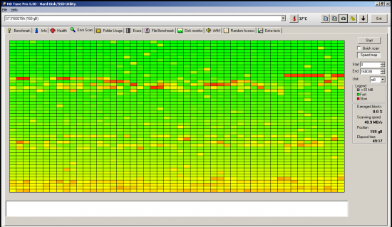

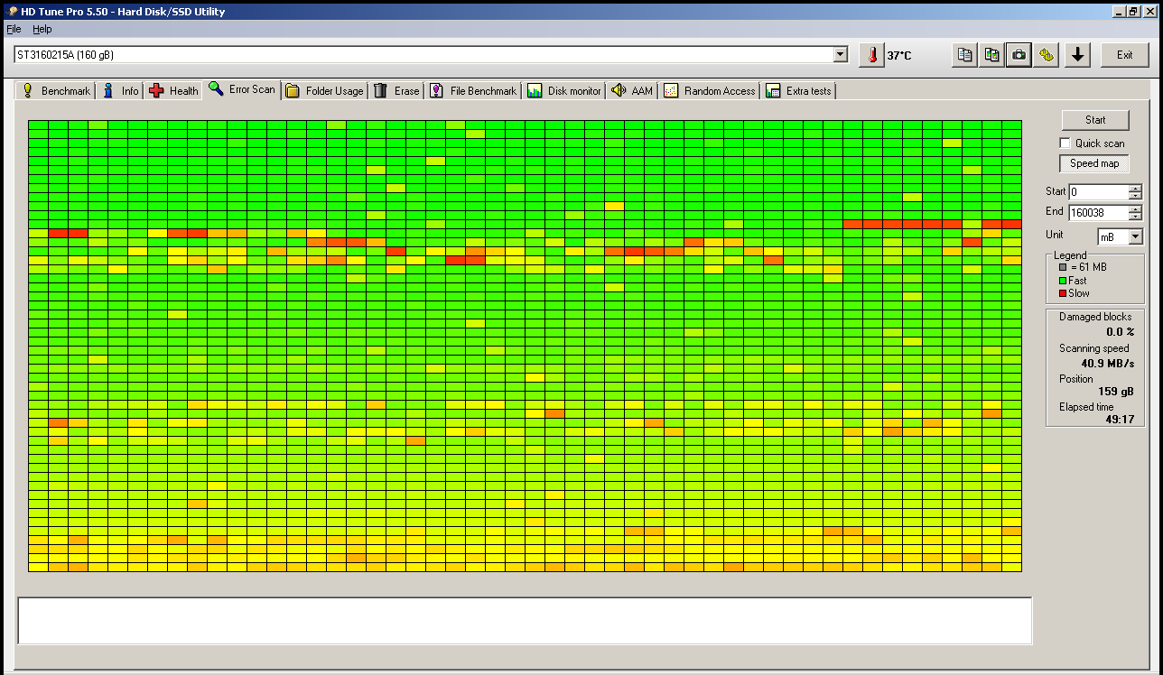

 Post subject: What the F*#@ is wrong with my Seagate ST3160215A.. Pls help
PostPosted: March 27th, 2015, 16:17
Joined: March 27th, 2015, 16:04
Posts: 5

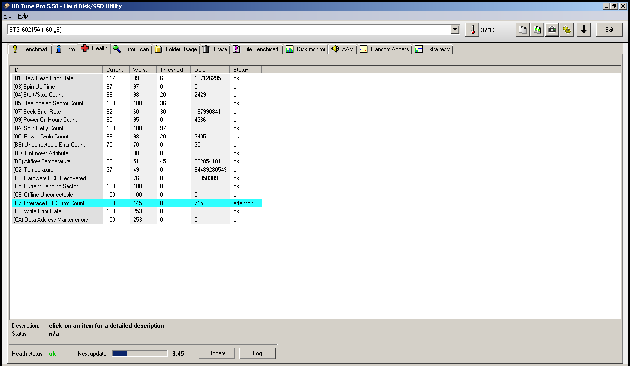

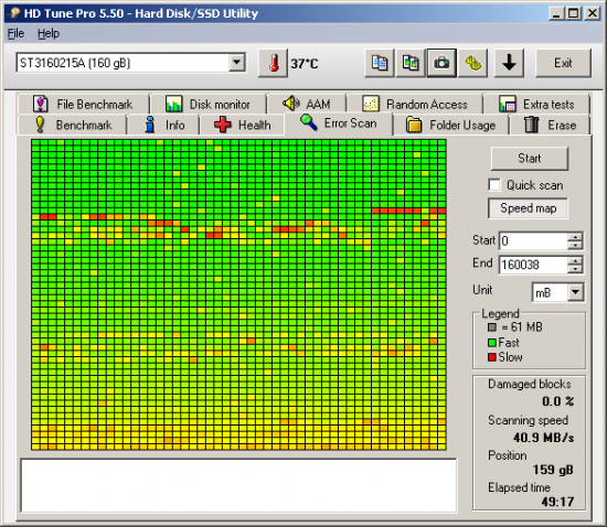

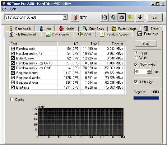

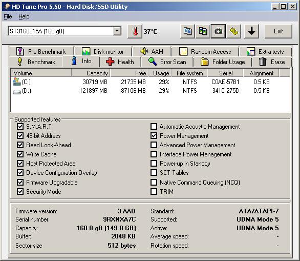

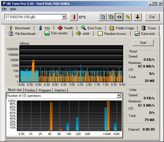

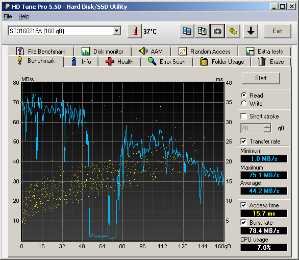

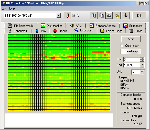

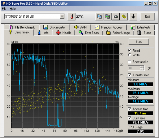

The Max. file transfer speed is a ridiculous 10 MB/s.. The manual says that theoretical should be about 78 MB/s, if properly configured.. The DRIVERS, BIOS & Settings are absolutely TOP-NOTCH..
Please go thru' the HD Tune Screenshots..
Any help is greatly appreciated.. THANKS!!

I would test your file transfers on drive C: rather than D:.
ISTM that you have a bad section between 50GB and 80GB. Try to replicate those results with MHDD under DOS.

Wherever I may copy, C or D.. after jumping robustly to about 50 MB/s, the disk i/o suddenly drops down to around 8-10 MB/s.. sometimes even as low as 800-1200 KB/s which makes me wonder which year am I living in.. So any inputs Plz ??

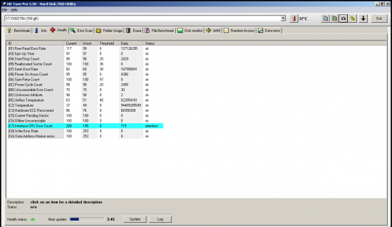

Say in this image here :http://forum.hddguru.com/download/file.php?id=9745&mode=view, what does Interface CRC Error Count is unusually high ?? what exactly is this Interface CRC Error Count.. ??

Wherever that I may copy, C or D drive.. After jumping to a robust 50MB/s, the disk i/o suddenly drops to about 10 MB/s.. On occasion I had to withstand even 800-1200 KB/s.. Grrrrrrr.. Yeah tearing my hair out..
In one of the screenshots above, "INTERFACE CRC ERROR COUNT" shows a large deterrioration of about 200 errors.. Exactly what is this "INTERFACE CRC ERROR COUNT" ??

i think we are talking here of some wear and tear... i see you have a lot of slow reading sectors...i have a hdd that also has some slow reading sectors and although the theoretical speed it's 100mb/s it barely goes to 10 and in my case the answer it's wear...and judging by your sectors i would presume the same.

The UDMA CRC Error Count reflects SATA interface errors. I wouldn't blame the drive for those.
Windows tools would be affected by interference from background tasks, so a DOS based surface scan would be more reliable. If MHDD confirms the existence of the bad area, I would create 3 partitions and confine the bad area to the middle partition. Then you could use the HDD for non-critical storage.
The following article tries to explain the SMART attributes:
http://en.wikipedia.org/wiki/S.M.A.R.T.
