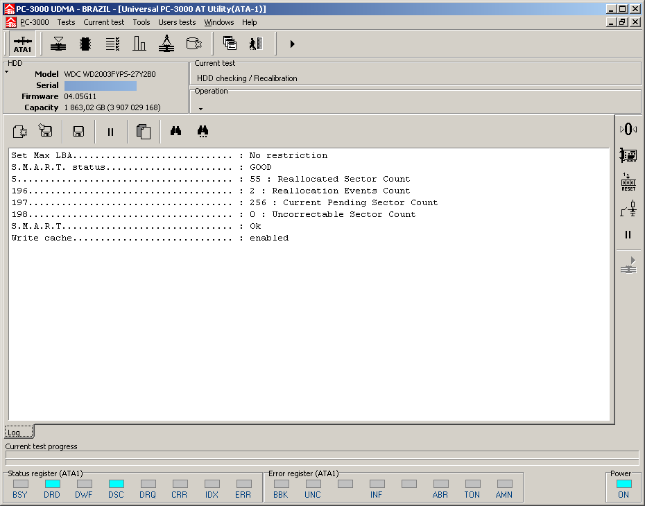

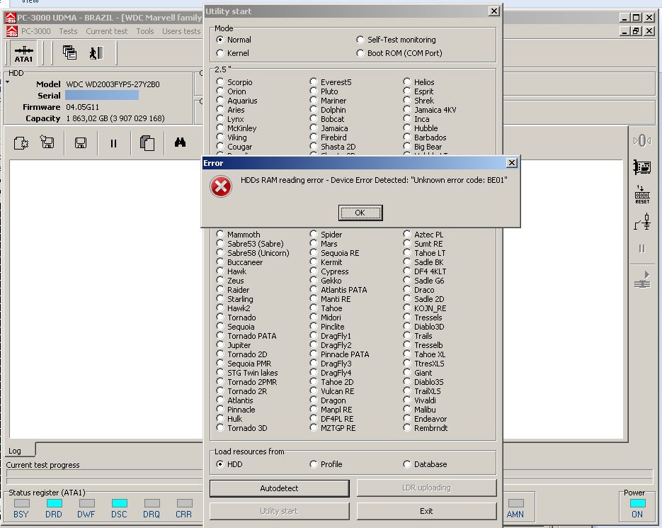

Hi.
Has anyone faced this error before ?
HDDs RAM reading error - Device Error Detected: "Unknown error code: BE01"
Model: WD2003FYPS-27Y2B0

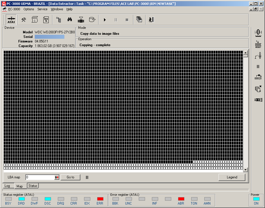

HDD detects model and size but all sectors returns ABRT
Can´t gain access SA neither in normal or kernel mode.
Manually selecting DF4PL RE as family also won´t help.
Screenshots attached
-BR-
File comment: WD utility fails family autodetection

File comment: Universal utility normal HDD detection
File comment: DE - all sectors black
