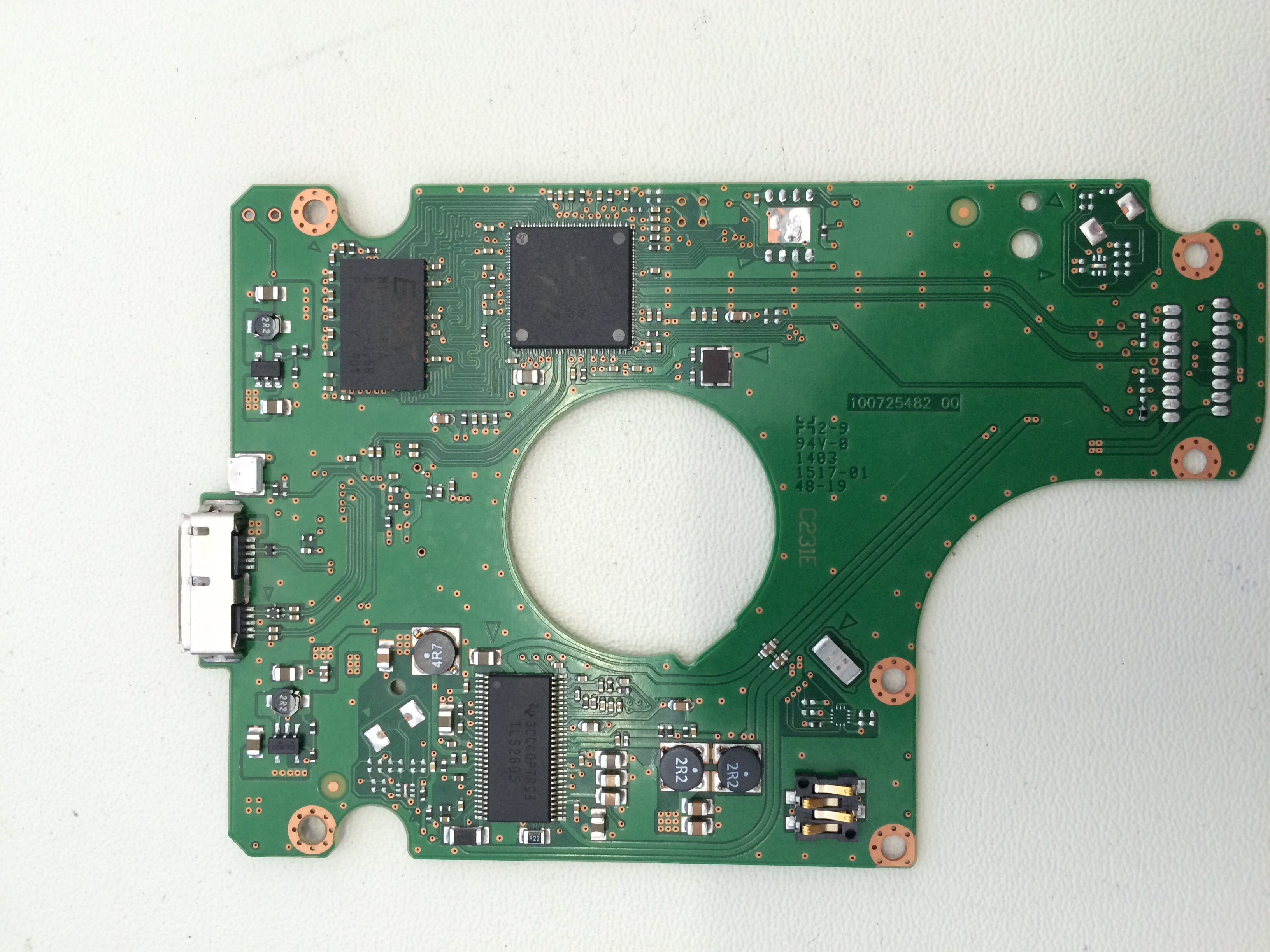

I'm having some difficulty sourcing a conversion PCB for a 2.5" Samsung ST1000LM025 USB 3.0. Can anyone offer any suggestions?

Find a PCB with the same MCU and motor controller.

ISTM that you have a fundamental lack of understanding of PCBs.
1/ Samsung PCBs have a BF41 part number printed on the artwork, at least prior to Seagate's acquisition.
2/ I hope that you are experimenting with your own drive, not your customer's, because a dissimilar PCB can have disastrous consequences, especially if the HDA connections are different.
3/ You need to understand what a SATA conversion really is. A USB drive is actually a SATA drive with a USB-SATA bridge tacked onto the front end. It is just an external drive with all the bits on the same board.
    HDA <--> HDD PCB <- SATA -> bridge <- USB -> host
A SATA conversion involves either of two approaches. The first is to tap into the SATA Tx/Rx pairs between the MCU and the bridge IC. The second is to find a SATA PCB that is as close as possible to the USB PCB between the HDA and the bridge, then transfer the "ROM". This means that the MCU and motor controller should be identical. A different MCU may not be code compatible with your ROM, and a different motor controller may also not be code compatible.
4/ ROM code is matched to SA code, especially the MOVLY001 module. You need to transfer more than just "adaptives", assuming that your drive has any (?).
My searches for ST1000LM025 turn up a part number (aka Samsung model number) of HN-M101ABB and a PCB number of BF41-00373A.
http://ep.yimg.com/ay/yhst-144375849714 ... 6013-7.gif
The MCU is 88i9322-TFJ2 and the motor controller is TLS2602.
The 100720903 PCB has an 88i9422-NDB2 MCU and TLS2605 motor controller, plus it looks nothing like the BF41-00373A. Obviously this is unsuitable.
http://ep.yimg.com/ay/yhst-144375849714 ... 4141-9.gif
However the BF41-00354A has the same MCU and motor controller as the BF41-00373A, plus it looks very similar. It would be my choice for a potential conversion.
http://ep.yimg.com/ay/yhst-144375849714 ... -fw-11.gif

Your search brought up an old PCB, mine is 2014 and has no BF41, instead it's 100725482 00
Thanks for the detail fzabkar.You raised some interesting points... I will research both PCB recommended and post back with my results and findings.

I suspect that the new drives have 1.8V I/O. If you have a 3.3V TTL adapter, then that could explain why you aren't seeing anything on the serial port.
Detailed photos of both sides of the PCB would help. A simple measurement of the at-rest voltages at the serial Tx/Rx pins would also help.

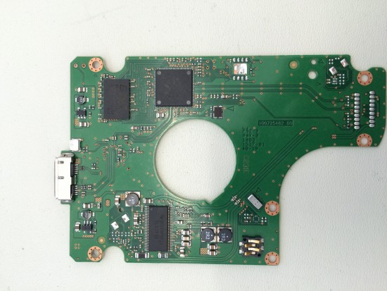

Fzabkar: interesting, your search for the ST 1000LM024 brought up a totally different PCB . Here is what the source drive looks like.
I do have the bf41-00354a board you suggested in stock but the MCU does not match source. It's same as the other pcbs I've tried. It won't spin up even with the hda blocked.
Source pcb:
