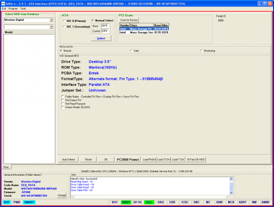

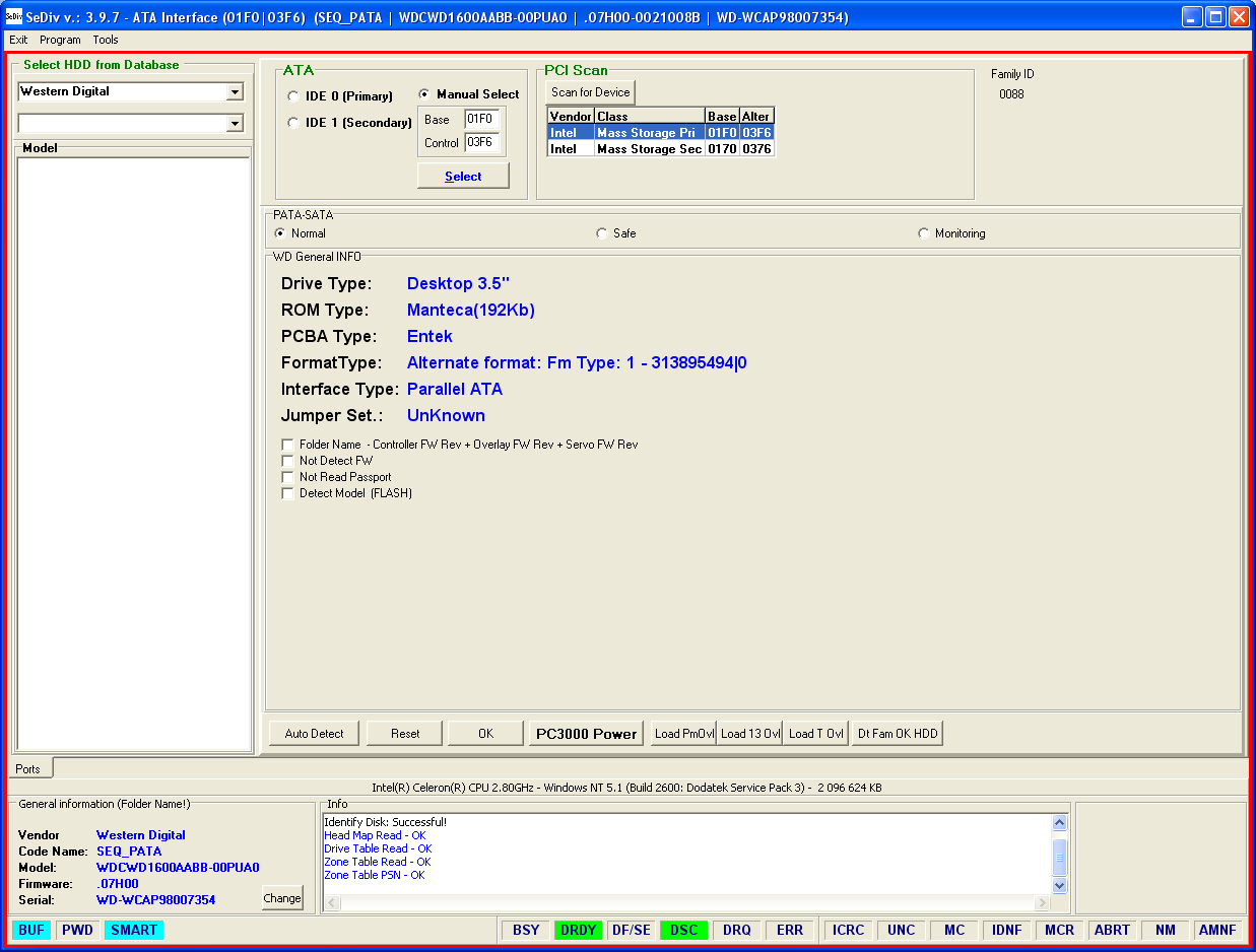

Spildit wrote:
Download modules from the drive with SeDiv DEMO.
Then you have to find correct Modules (SA) that you download with SeDiv (the ones with the adaptives - copy of Rom modules) and PATCH your ROM file with the correct info on SA to re-build original ROM :) Then you write that to the PCB and you will hopefully have original ROM :)
I ran SeDiv and was able to detect disk. All time I practice on the donor disk.
Where to look for the appropriate option to download the ROM from SA?

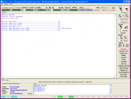

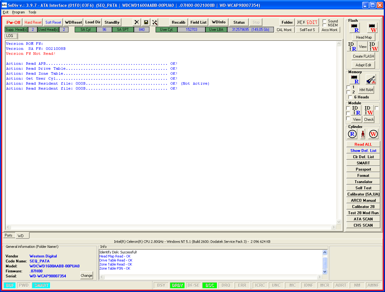

Spildit wrote:
Try to press "Ok" ?!
Also you want modules from platters on the "samaged" drive so that you can create comaptible/initial ROM with those modules.
I was able to do so have already come but the second screen is black magic :(
