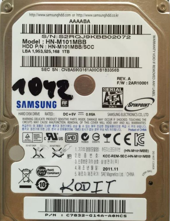

Hello. My name is Dawid and I'm from Poland.
I'm looking for a Samsung hard drive to recover my files. In my Samsung the main head just dead. After this, I can recover only ~3/4 of my files. To recover all files I need to replace first head. I'm looking for a disk with specs like on the photo in annex. Do you know where I can get this?
File comment: All selected must be the same

Fempter wrote:
I'm looking for a disk with specs like on the photo in annex. [/attachment]
This details are not enough. This family uses four types of preamp and some of them are not compatible each to other.

 Post subject: Re: Need Samsung HN-M101MBB/SCC to replace first (main) head
PostPosted: June 5th, 2015, 5:25
Posts: 331
Post the P/N number of the drive. It's under the lowest EAN code.
I use the middle four characters of P/N number for HSA donor match. The manufacturing date and model number is important too.
For HSA exchange you need proper tools, clean room, and much practice! Without these your success rate is under zero.
PostPosted: June 8th, 2015, 10:49
Joined: June 1st, 2015, 7:59
Posts: 5
Actually you don't have to match all 4 of them.
Totally agree.

this drive
MindMergepk wrote:
http://www.donordrives.com/samsung-1tb-st1000lm024-hn-m101mbb-scc-fw-2ar10002-sata-2-5-hard-drive.html
was manufactured more than a year later from the OP drives
IMHO it's a very long time to match this kind of drives
(although there could be surprises, but i doubt that such surprises happens on ST drives, (you never know until you try))
