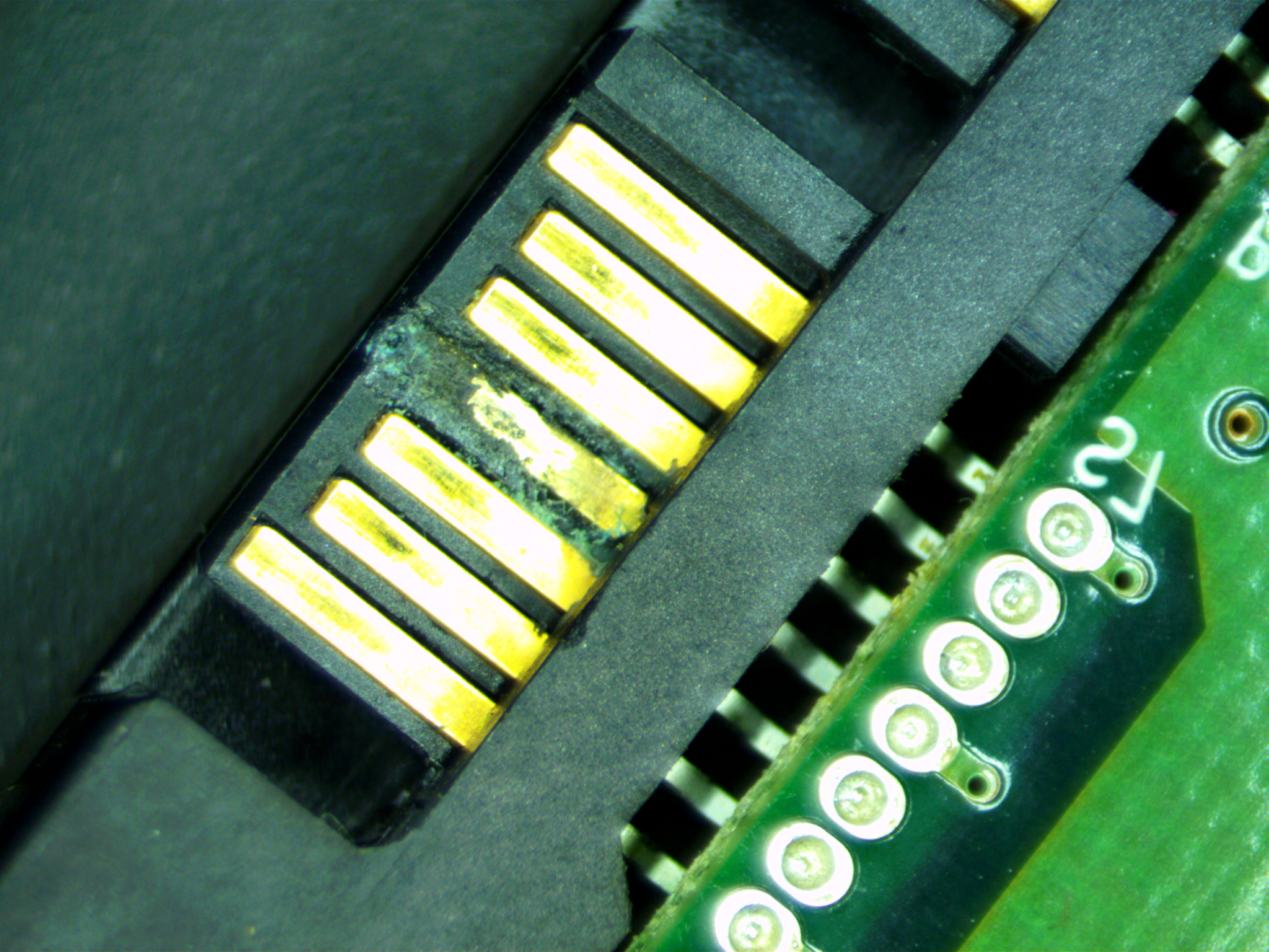

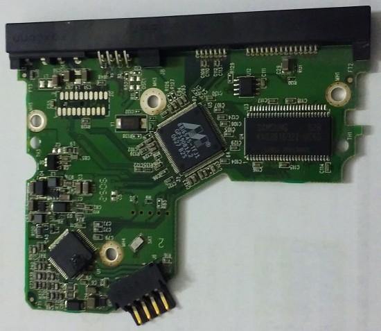

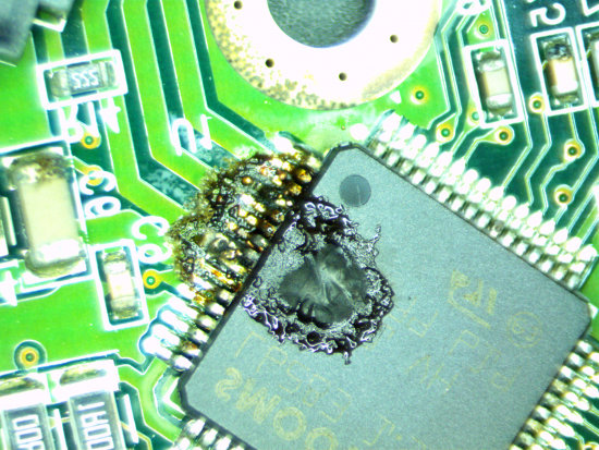

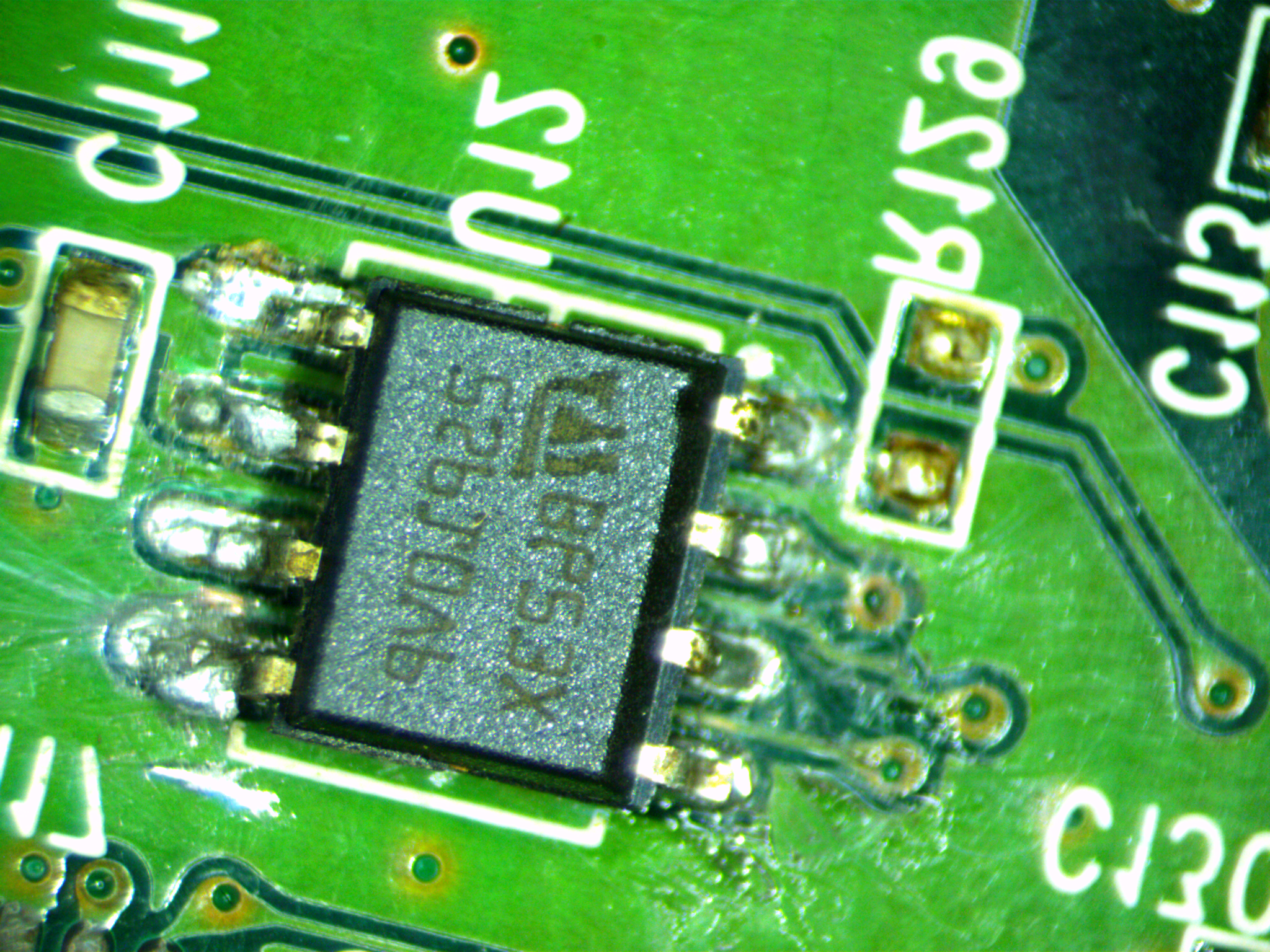

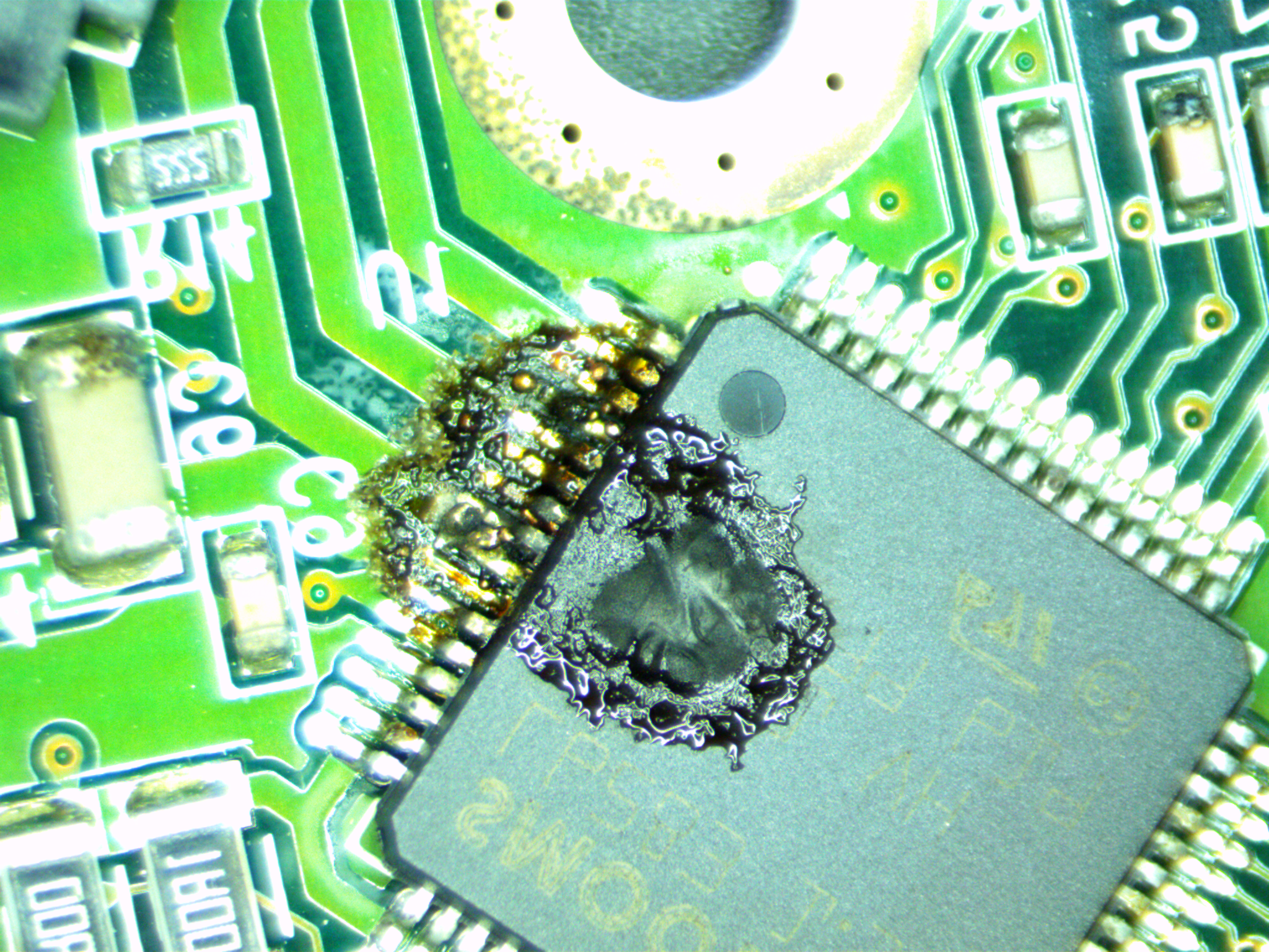

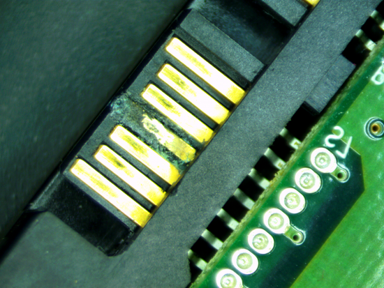

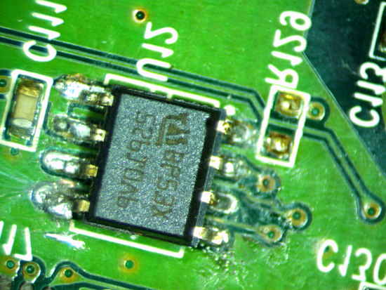

PCB damage as shown. I've ordered a replacement board, and i'm 98% sure, but i thought i'd ask anyway, the U12 chip is the one i transplant right?
Does anyone know if the motor/heads might be damaged from this?

 Post subject: Re: WD3200KS-00PFB0 damaged PCB
PostPosted: June 30th, 2015, 6:58
Joined: March 6th, 2010, 3:46
Posts: 627
Location: Kolding | Denmark
U12 yes is the one to move
Motor damage, not likely
Heads maybe
PostPosted: June 30th, 2015, 15:44
Posts: 17324

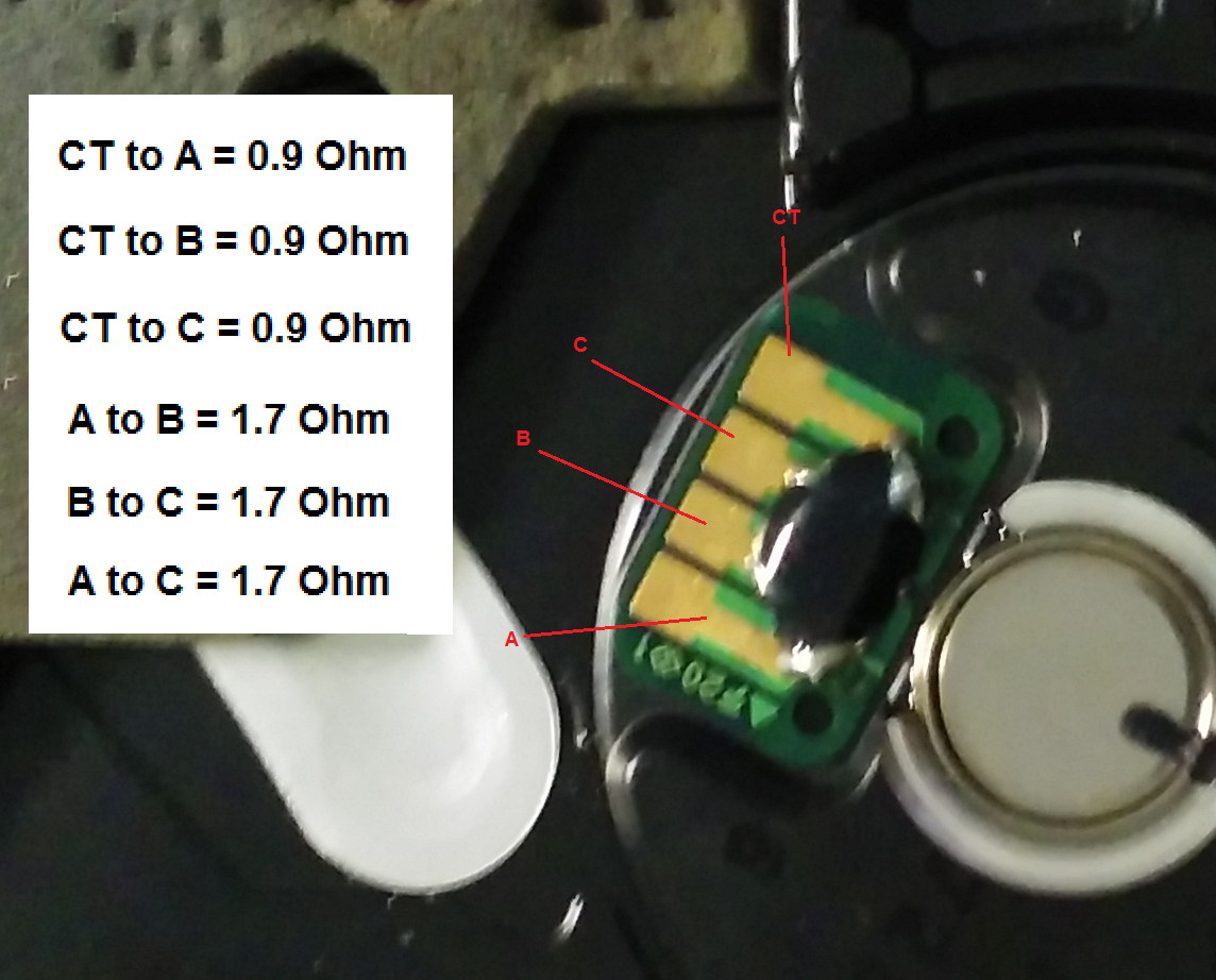

The damage is on the motor side, most likely due to an overvoltage on the 12V supply, in which case the preamp will probably have been untouched. Measure the resistances between the motor terminals just to be sure.
PostPosted: June 30th, 2015, 23:21
Joined: August 21st, 2014, 3:29
Posts: 43

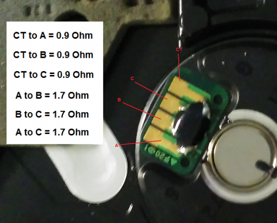

Resistances came up normal. *breathes sign of relief*
thanks fzabkar
File comment: My meter is +/- 0.1 accurate cuz i'm cheap..
PostPosted: July 2nd, 2015, 9:30
Posts: 4848
There must have been some really bad cabling around this drive if so much current flowed through the sata shielding... :o
PostPosted: July 2nd, 2015, 14:52
Posts: 17324
@CleanestRoom, this article shows you what happens when the overvoltage is on the 5V side:
Catastrophic failures in Western Digital PCBs:
http://www.hddoracle.com/viewtopic.php? ... 119&p=5033

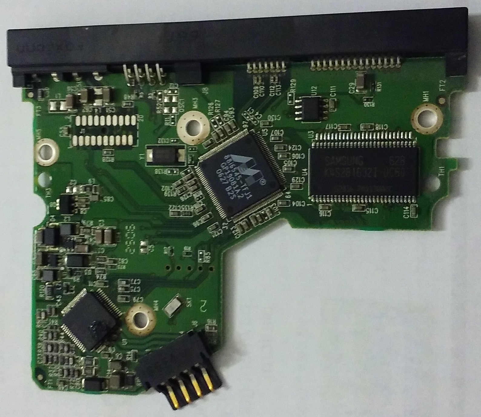

Solder job went okay.
Plugged drive in, it started spinning unlike before then...
click, click, click, click, click, power down. The entire time the BSY registry was turned on.
I guess this means the heads or pre-amp is destroyed?
I guess i should also tell the customer to get a new psu or surge protector board. :S
File comment: Pls don't make fun, i'm learning!
PostPosted: July 14th, 2015, 10:32
Are you taking pictures through a mirror or something???? Why is everything inverted, it's making me dizzy.
PostPosted: July 14th, 2015, 11:00
Posts: 43
I have no idea what's going on with my pictures. :lol:
PC3K support had a look at it. Tried some different head map configurations, then some different utilities, then a custom loader..
Final diagnosis is head failure or media damage.
Case closed! :mrgreen:
