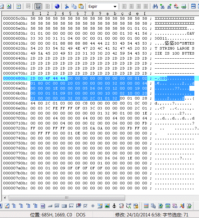

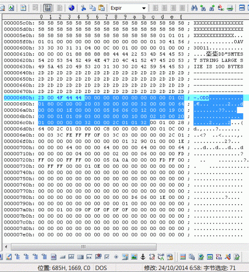

Last night when I had a look at Fzabkar's slowfix solution. I am not 100% sure it will work on my HDD, because in the sample MOD 02, address of flag "ODD" is not the same as mine, and I don't understand how the script clear that single byte.
Meanwhile I found a topic in a Chinese forum. They clear all the bytes to zero from flag "ODD" to "01 00 28" in MOD02( please see pic).
From the two solution, I am quite sure at least one will work. So I tried the Chinese solution using WDR5.3 first. And it works!
Now I am backing up bloody 1.6TB data to another wd element. It will take about 24 hours. Hope the old wd element will not brake down again.
And I am quite interested in what's the reason of slow wd, and why clearing MOD02 will fix it. Can any Guru explain?
Thanks a lot FZABKAR.

My script is independent of the actual location of the relevant section within MOD 02. Also, instead of deleting this section, it merely disables it by writing a zero to byte position #02 within the section.
Perhaps the following article will be of help to you.
Analysis of Western Digital ROYL firmware MOD 02:
http://www.alexsoft.org/viewtopic.php?f=59&t=821&p=3191
