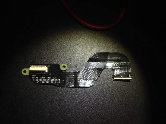

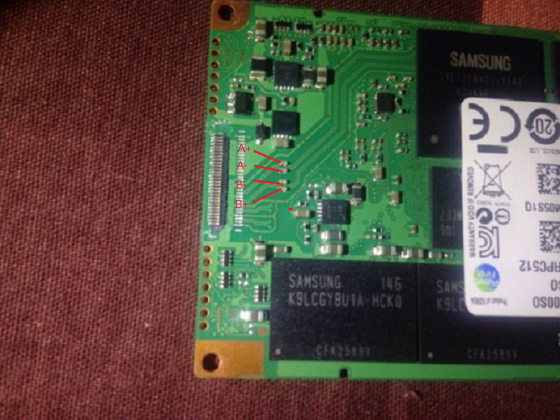

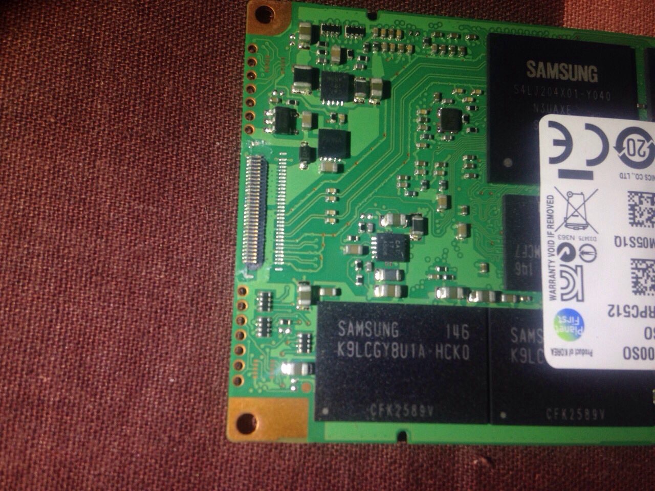

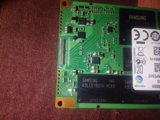

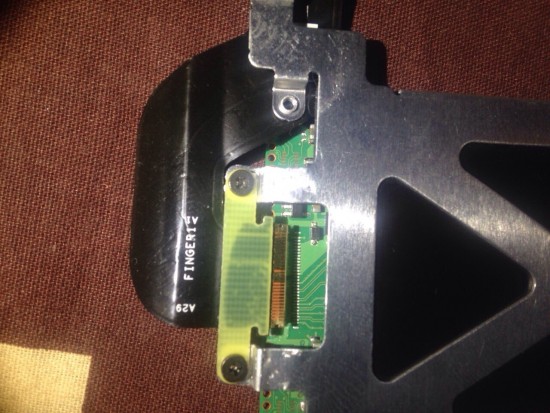

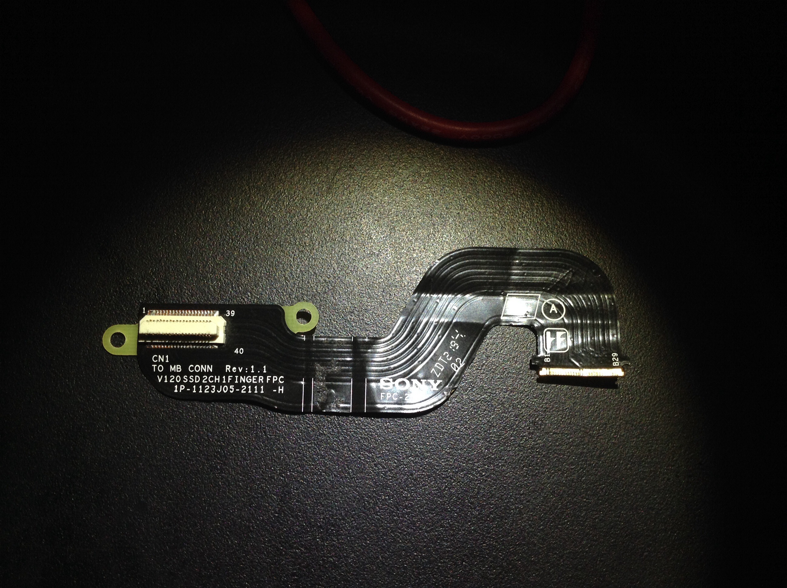

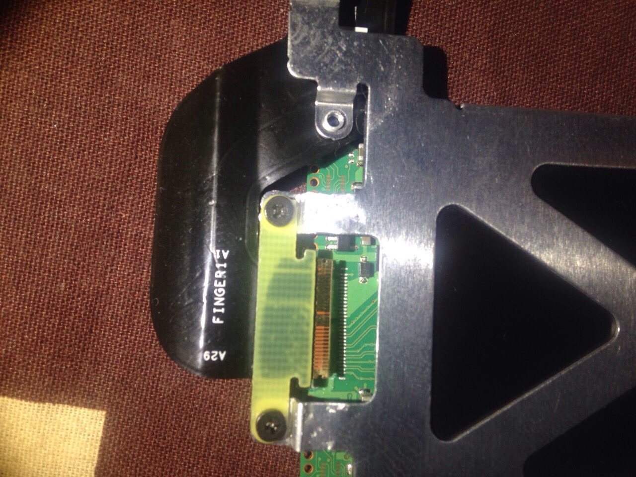

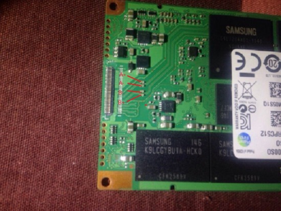

hi, I apologize for my poor English. the problem is this - the laptop sony svs13a1v8r broke the ribbon cable and then the connector. schematic of the plume. can be experienced?

need cable diagram. maybe someone can help?

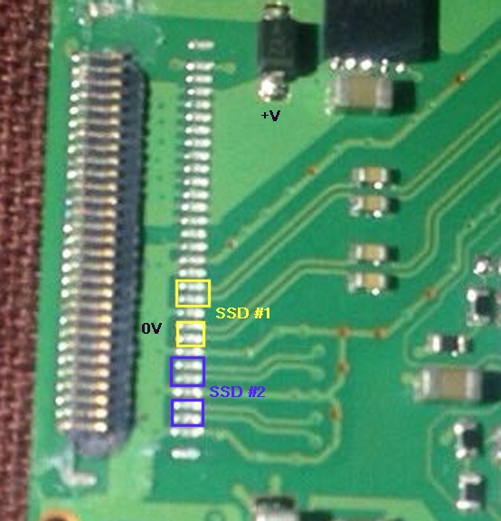

Here is the Sata pinout

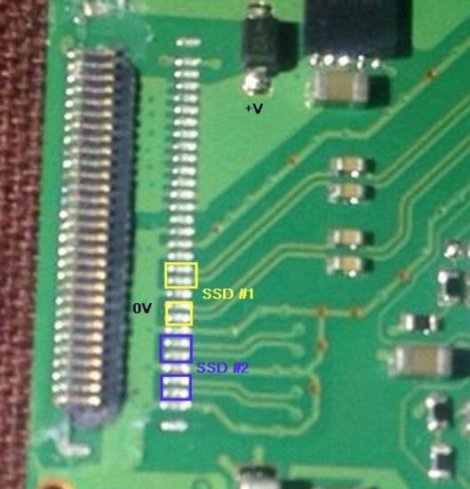

ISTM that there are two separate SSDs, one on each side.
 Post subject: Re: sony svs13a1v8r died ssd 128gb
PostPosted: August 3rd, 2015, 4:03
Posts: 17324
viewtopic.php?f=1&t=18418&start=60
Here is a regular single SSD using the same flash controller (S4LJ204X01):
http://www.storagereview.com/images/Sam ... CB-Top.jpg
You can see how the SATA Tx/Rx pairs are wired to a regular SATA connector.
