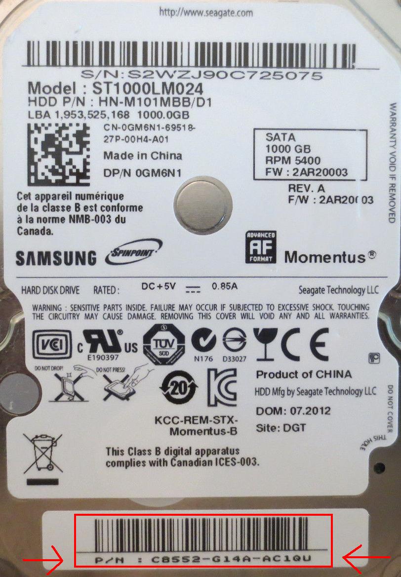

what's the part number, i mean NOT HDD Part Number, (bottom sticker)

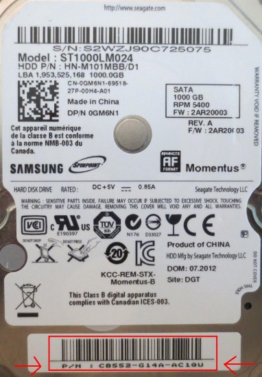

jerovsek wrote:
Hello Jermy,
thank you for your replay
patient pcb sticker:...
i'm not talking about the PCB i'm talking about the barcode on the bottom on front

Thank you Kum Rusvelt and Jermy,
PN patient:F2083-G94A-A2JDY
PN donor:E9203-G14A-A05R5
 Post subject: Re: Samsung ST1000LM24 head compatibility
PostPosted: July 31st, 2015, 11:13
Posts: 331
Hello jerovsek!
These drives are not compatible for head donor.
