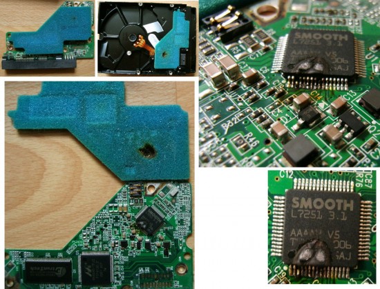

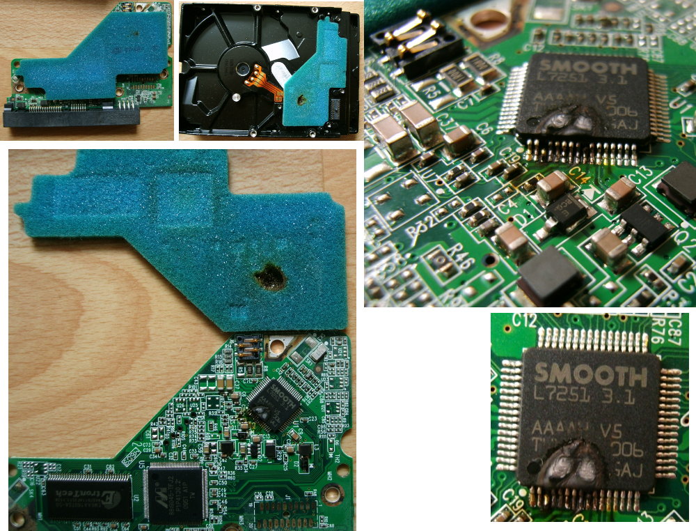

Hi!
My 5yo WDC SATA disc failed at its new owner's site.
Then he sent it back and wants that we both pay half of the damage.
When I used it the last time, smartctl did an "extended offline" test, that "completed without error".
Then I put it in one of those silverish bags and stuck it in Amazon's plastic hard disc holders (one for each each end) and put it into a parcel.
After a week the buyer told me, that his first attempt to power it up resulted in an unresponsive computer. The hdd never spun up. Then he undertook several other attempts (including a SATA-USB thingy).
When it came back, I found that it smelled slightly fishy.

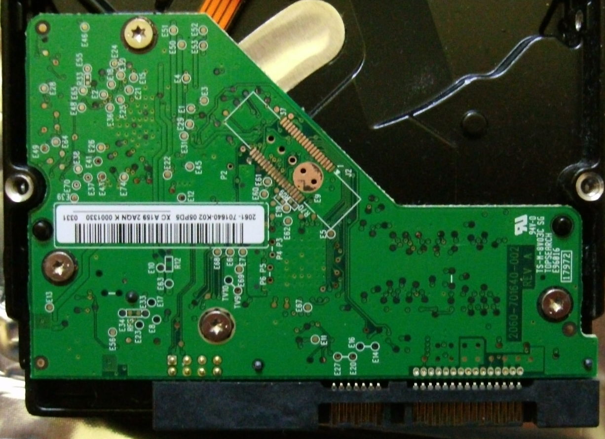

Then I loosened the screws of the PCB and found a burn mark on the rubber foam.
And below the foam were some more traces of a short circuit.
And the SMOOTH chip does not look smooth...
I attached some pictures of the part.
Can someone tell me, what caused that damage?
Thx.
Bye
Arne

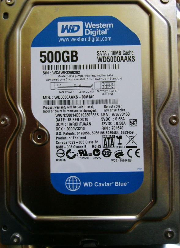

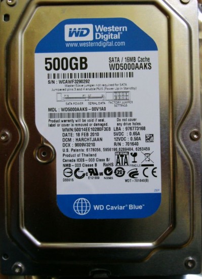

File comment: sticker on the part

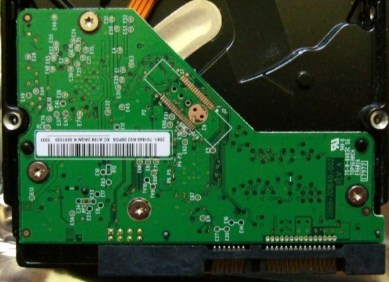

File comment: exposed layer of the PCB
File comment: burn marks

The damage is consistent with an overvoltage on the 5V supply. If TVS diode D3 is shorted, then this will prove that the user, or his equipment, was at fault.

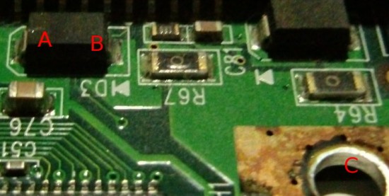

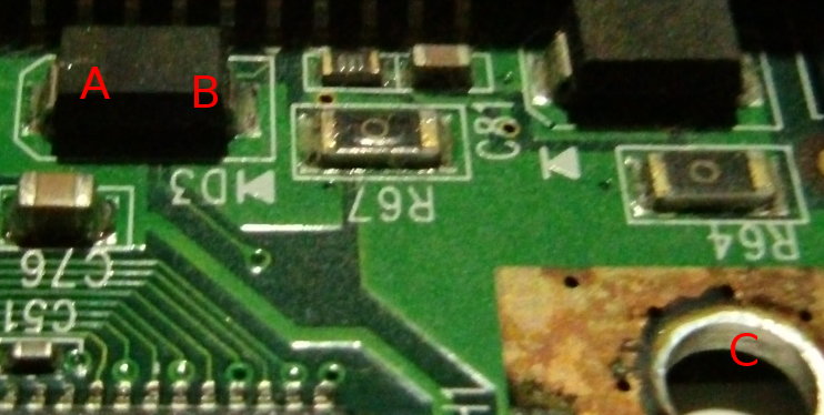

I attached a picture which shows the points that i tested...
Between A and B i found 0.1Ohms (polarity of the probes did not matter). And between A and C I found 15kR.
But why didn't that also fry the buyer's other discs and his mainboard?
On Wikipedia someone guessed, that it might have been a reversed PATA-to-SATA power plug, before they showed me this site...
Luckily there was no important data left on the device (I cleared every sector, that I could reach, in order to avoid password theft... and there were no reallocated sectors...), so that the damage is relatively low...

File comment: resistance measurement

The shorted 5V diode proves that the drive was killed by an external event, namely an overvoltage, or reversed polarity, on the 5V input. This can happen if the user replaces the PSU but retains the old PSU's modular cables. These cables do not have standardised pinouts, so it is quite common for 12V to appear on the 5V pins. This also explains why some devices are damaged while others are not.
The date of manufacture on the label is 18 Feb 2010. However the date of manufacture of the PCB is "4609" (near U2 and U5). This codes for week 46 of 2009. That's mid November, a difference of 3 months. I can't see the markings on the Etrontech SDRAM and Marvell MCU, but the SMOOTH chip appears to have been manufactured during week 6 of 2010 (006). That's mid February, so it is consistent with the label. If any of the chips were manufactured after 18 Feb 2010, then that would suggest that the PCB was not original.
