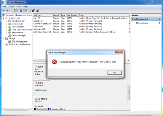

Sorry to hijack this old thread, didn't see a more recent one when I searched.
Hard drive has the following symptoms and specifications:
Model number: WD10JMVW-11AJGS0
PCB Serial: 2060-771961-001 REV A
Drive is recognized over USB and drivers are successfully installed. WD SES Drivers
Drive does not show up in "My Computer"
If "Disk Management" is used in windows to initialize the device it prompts with the following error (see screenshot), the "My Passport Drive WD10JMVW-11AJGS0" is "Disk 5" in the screenshot.
The drive has not been dropped, it does not make clicking sounds, the pcb does not get hot, it does not have a burnt or ozone smell to it.
My question is if I swap the pcb for a 2060-771960-001 will the data be read off the drive? and if yes will it be encrypted?
Does swapping the board out still mean I need to swap the BIOS firmware chips on the boards?
Sorry for this I've read a lot of posts and I can't seem to get a clear answer.
File comment: Disk Management Screenshot
 Post subject: Re: 771961 USB to SATA
PostPosted: November 24th, 2015, 6:24
Posts: 1388
Location: isreal
it's a SED drive
yes
