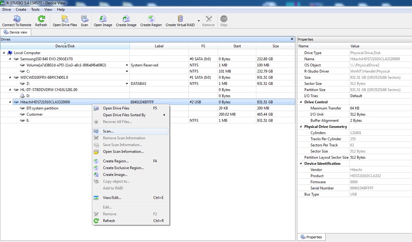

mr_spokk, I have have a look at R-Studio.
How do I work it.
What would be the best code to write to find my files?
My coding level is: I can't write code and can only just understand it.

Hi, start the prog and rightclick on your clonedrive and scan.

I have ran the scan.
I have recived a .scn file but no way to open it.
Could I sent it to you Mr_Spokk to open and check for me please?
If you could PM me your email Address I will send to you.
