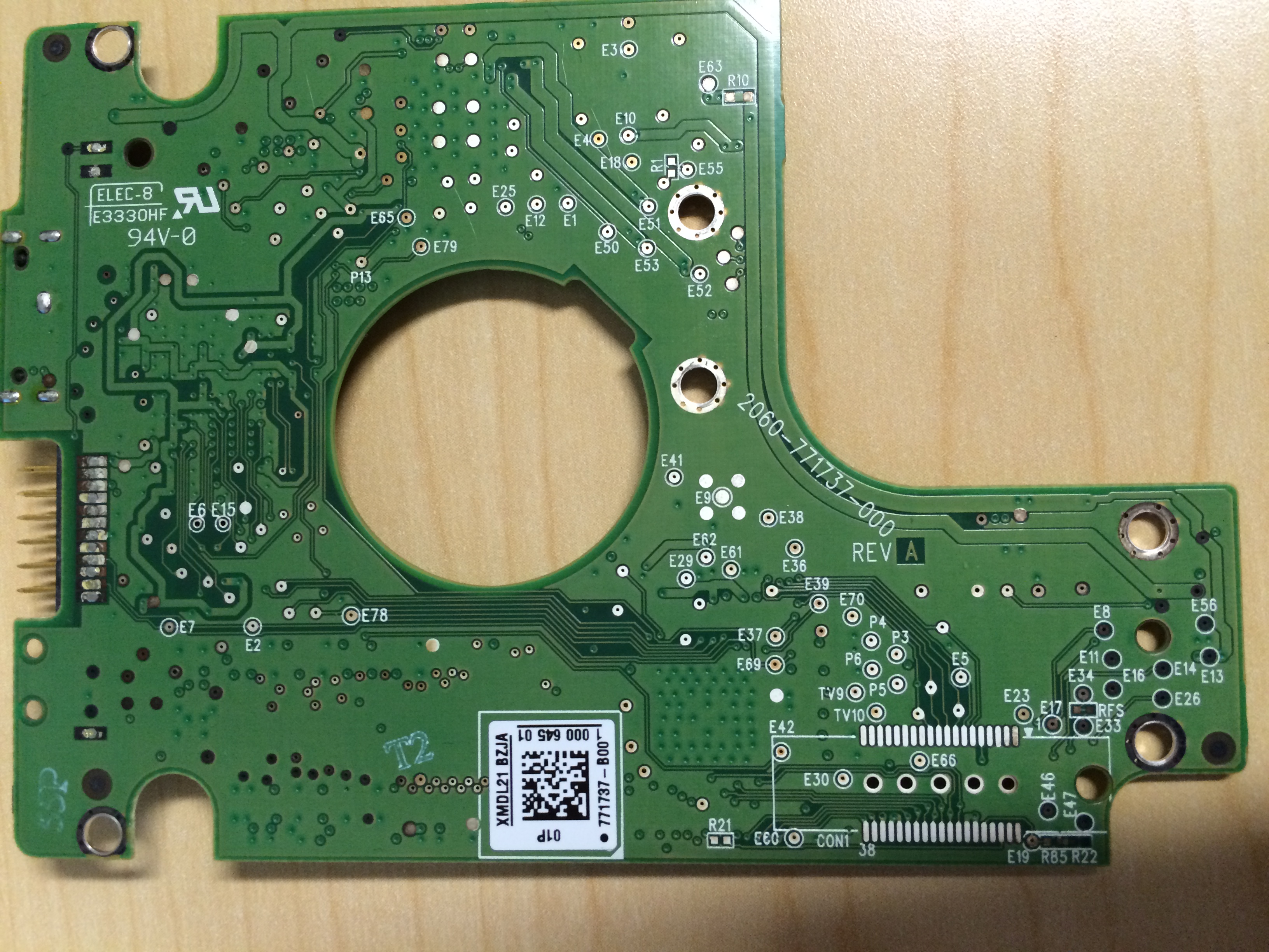

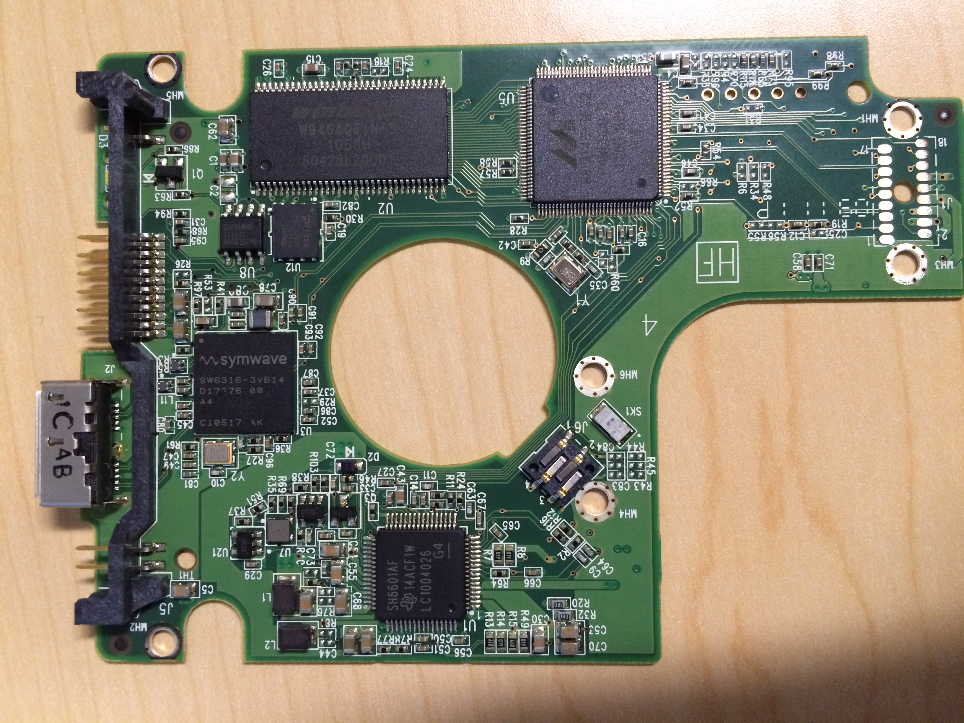

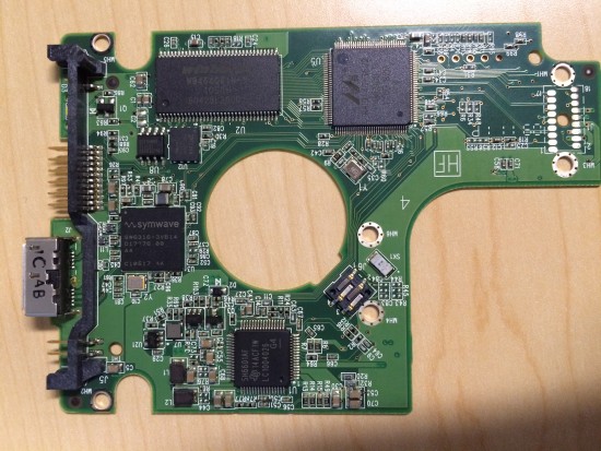

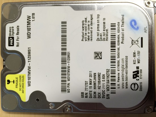

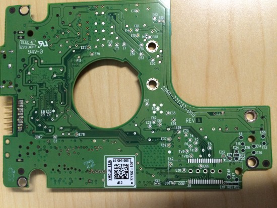

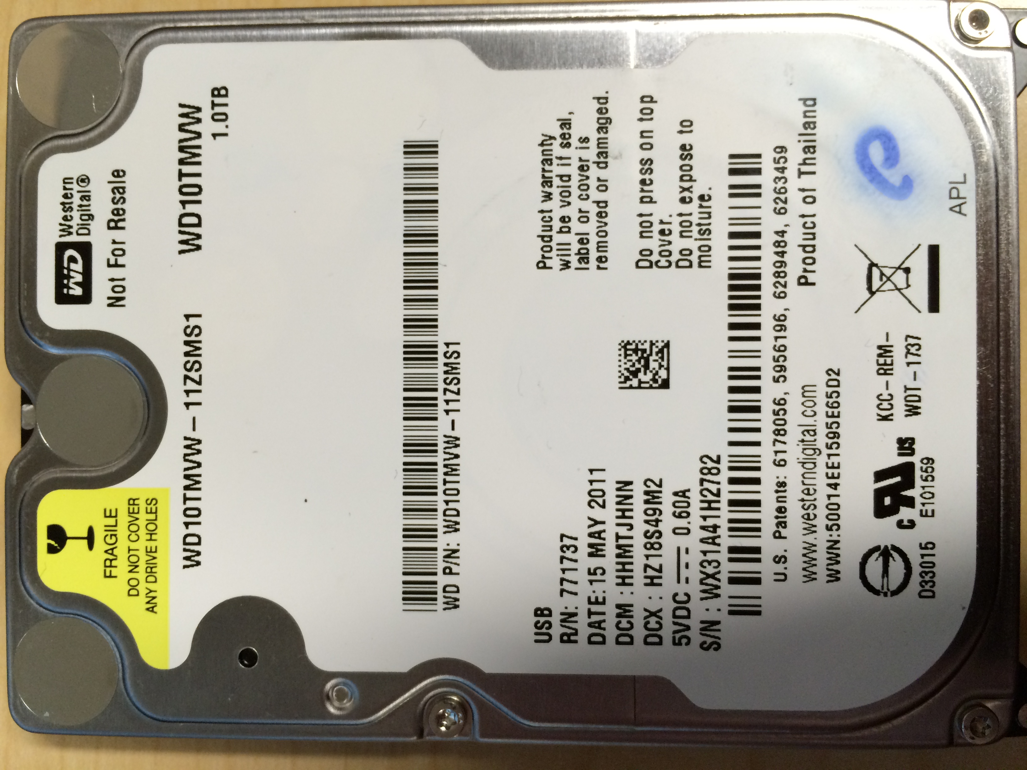

I have a 1TB WD passport, with drive WD10TMVW. This thing has been acting up for a while. I've gone through all kinds of steps to see what's wrong. Unfortunately, while I do believe I have a bad sector/RAW problem, I also have a faulty USB connector, and I have the happy fortune (ugh) of having one of the proprietary boards with no SATA option. I also realize I have on the fly encryption, so it's unlikely I have a way to recover anything. Here's where I would like to ask a few questions....
1: I would like to try to bypass/fix the USB connector. I believe, based on behavior from the unit, that I may be having a problem delivering power to the unit.
2: I was hoping someone here has seen/experiencing this drive/same problem, and could point out either how to repair the USB that's on the board, or how to bypass it (use pictures, and pretty colors: assume I am an idiot)
3: If you are kind enough to help, please explain, or use a picture, what adaption you are recommending: SATA or USB, and what cable/color needs to go where.
It's my understanding that trying to go SATA will cause me to get nothing but encrypted data... while I've heard rumors that folks have figured out how to decrypt, I have seen nothing substantial/standalone click-and-done. If I can repair the USB, great, but if not, is there a way to bypass just the USB connector, but still go through the encryption chip? I have a chip at U12, but seem to have no U14 that I can find, so doing a donor PCB is out of the question as far as I know.
I will try to load pictures of the front and back of my PCB and drive.

File comment: Drive itself
File comment: PCB back: where to solder to?
File comment: PCB front
