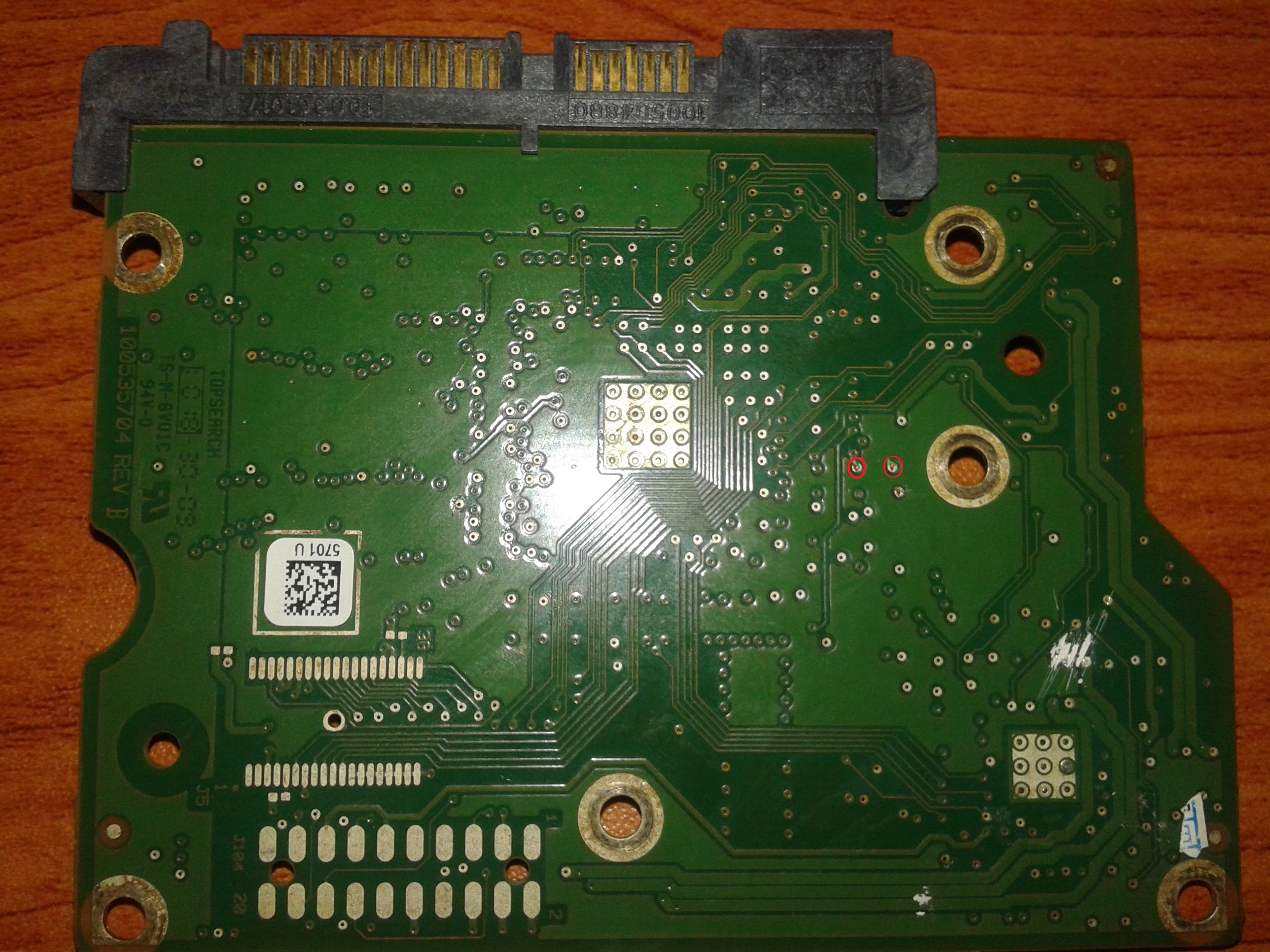

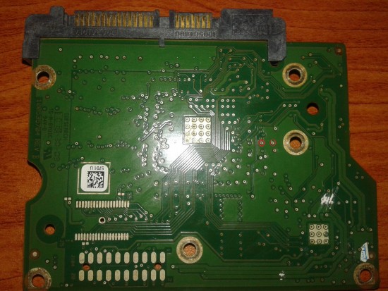

Dear Friend's,
please find attachment picture.
i have a this HDD, this hard disk PCB Burn, so i am replace same model PCB & swap ROM chip.
but still this hard disk not detect well,
please help to me recovery this hard disk data.

I just used the search function of the forum and found this:
But please before you are making any further steps please double/triple check information and don't take to much risk.
saltwater wrote:
Hello raven!
Power your hdd with shorting read channels.
You will see something like this:
(DOS) Table Read FAIL
DOS: MAGIC CONFIG NUMBER MISMATCH
No HOST FIS-ReadyStatusFlags 2002A185
Then here push ctrl+z
Test heads on level 7 with command X
To stop InitiateMarkPendingReallocateRequest on F3 :
F00A2,00,22
F01E4,00,22
F057C,043C,22
These are used to disable auto relocation
....then clear smart on level 1 with N1 command.
Good luck!
viewtopic.php?f=1&t=31786&p=220802&hilit=table+read+fail#p220802

please can u show me in this PCB correct short point channel location ??

please can u show me read channels in my picture file ?

you already have access to terminal why short the read channels ?
can you provide outcome of following commands at level T;
V1
V10
V40
also on Level 7:
X
by the way here are the points
