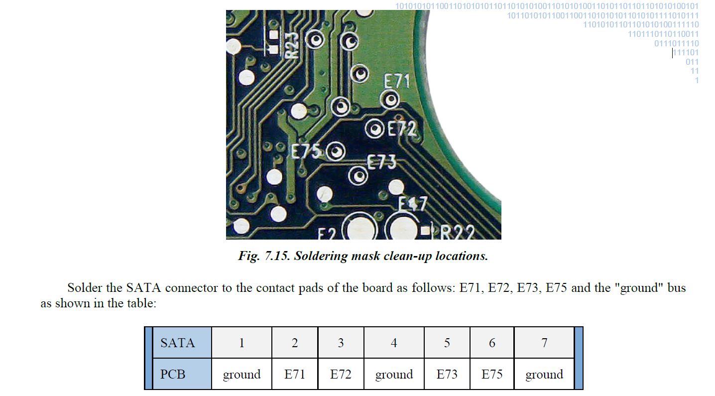

Ace Labs seem to have left off the highlights for the ground points to convert the 701675 USB board to a SATA board. Can someone advise me of the correct points (fzabkar ? :D )

you kidding ? right ?!
No. I do see lots of ground points, but this is the first one of these I have done. I may look stupid asking these questions, but I want to make sure I do not lose, or gamble with my clients data. If any of these points can be used that's all I want confirming :roll:

use any GRD you like on the PCB

Many thanks.
