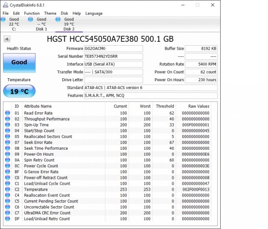

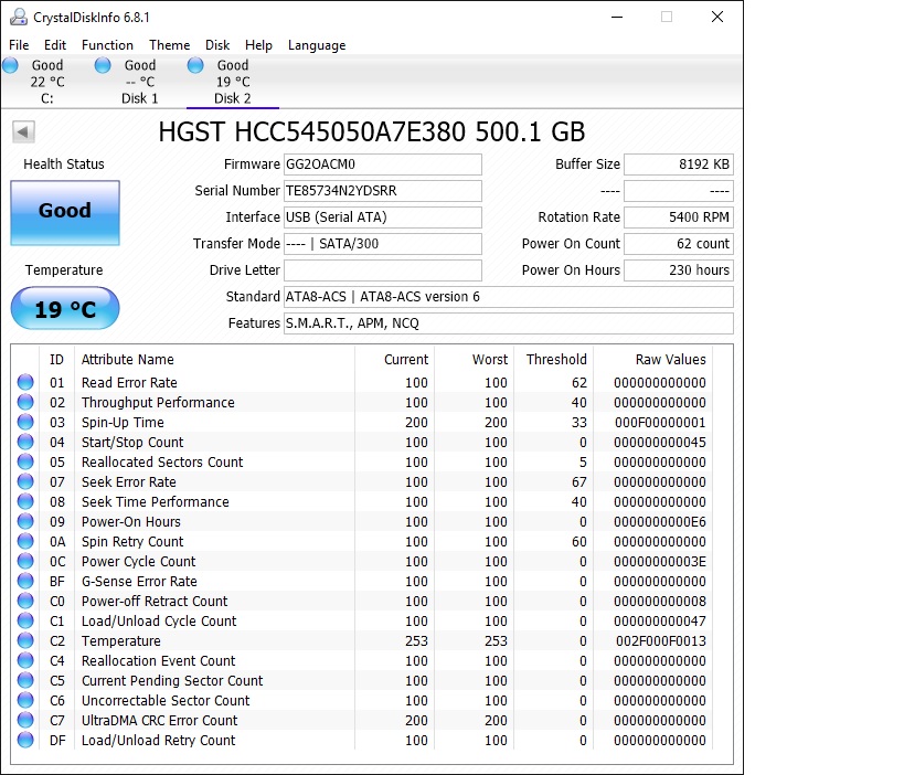

Does the drive have a password? You could use CrystalDiskInfo to examine the security settings.
http://crystalmark.info/software/Crysta ... dex-e.html

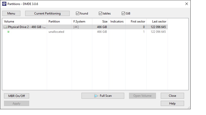

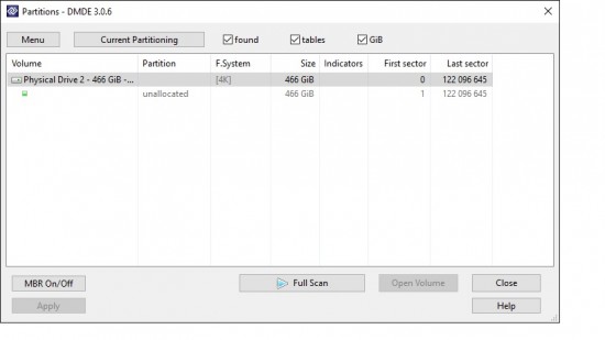

The number of LBAs (122096646) corresponds to a capacity of 62.5GB when the sector size is 512 bytes and 500.1GB when the sector size is 4096 bytes. Are you using a USB-SATA adapter that is configured with a 4KB sector size?
Can you show us the Partitions window in DMDE (freeware disc editor)?
http://dmde.com/

attached is screen for crystalmark and dmde as requested. dmde gave lots of errors which I had to ignore to get to the screen shot. hope that helps.

SMART looks good, so there is no evidence of any physical problem with the drive.
DMDE is reporting that the external enclosure is configured with 4KB sectoring. I know that early Windows versions had problems partitioning and formatting such devices, but I don't know about Win8 and Win 10. Seagate's DiscWizard should be able to format them, though. After formatting, Win XP works quite happily with 4Kn devices.
I thought that CrystalDiskInfo would show us the drive's security status, but apparently it does not. Sorry. Instead try HD Sentinel or HDDScan.

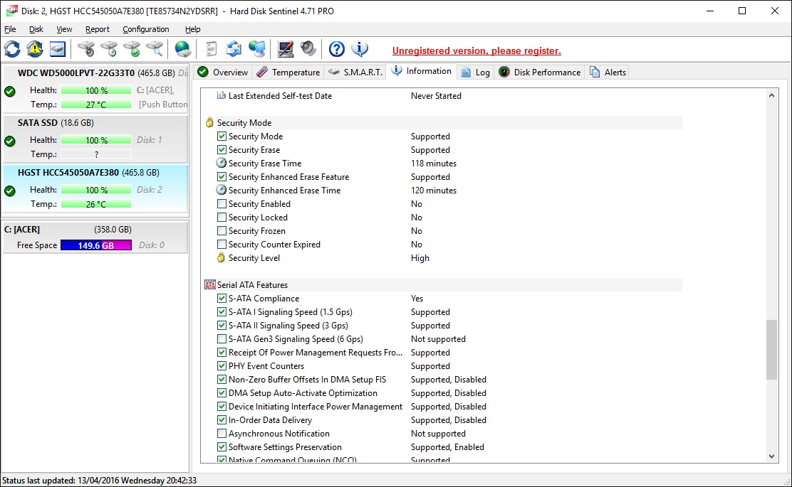

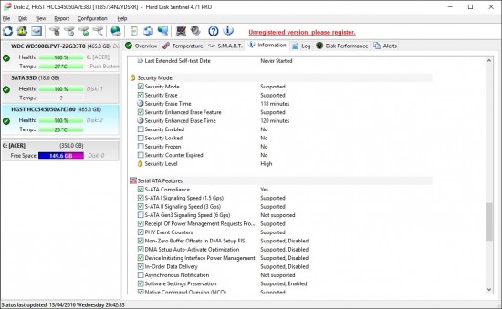

couldn't see security info with hdd scan so here is info from hd sentinel

 Post subject: Re: HGST HCC 545050A7E380 issues
PostPosted: April 13th, 2016, 17:31
Posts: 17324
Don't bother with the CHS numbers on the label. They are only for compatibility with older systems.
969021 x 16 x 63 x 512 bytes = 500.1 GB
It appears the drive is not password protected. Were you able to read any sectors using DMDE? If not, then it may be that there is something wrong with the enclosure? Is it a repurposed WD My Book or Seagate enclosure?

DMDE gives WinError 23, Data Error (cyclic redundancy check)
