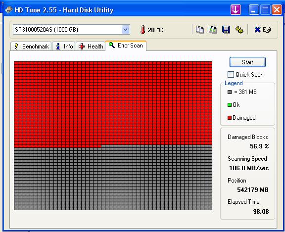

Today I want you to help fix bad hard drive seagate was red.
I used the tool
Clear smart
Clear G-list
Clear P-list
RepairFault m0,2,2,,,,, 22
Format with P list m0,8,3,10,3,,, 22
To repair bad sectors by Plist m0, D, 3,,,,, 22
Results failed to receive notice bad RED
Hope you help me
thanks

I hope you didn't need data because this procedure kills all saved data.
Have you followed this procedure?
http://www.hddoracle.com/viewtopic.php?f=83&t=1399

why you Clear P-list ??
this is very Wrong
now did you Clear with G6A ??
in Terminal Send V10 Command then post result here

Not run Format with P list m0,8,3,10,3,,, 22
help me

i didn't understand
did you Clear P-List or NO ??
in all cases send V10 in level T and Post Result Here
