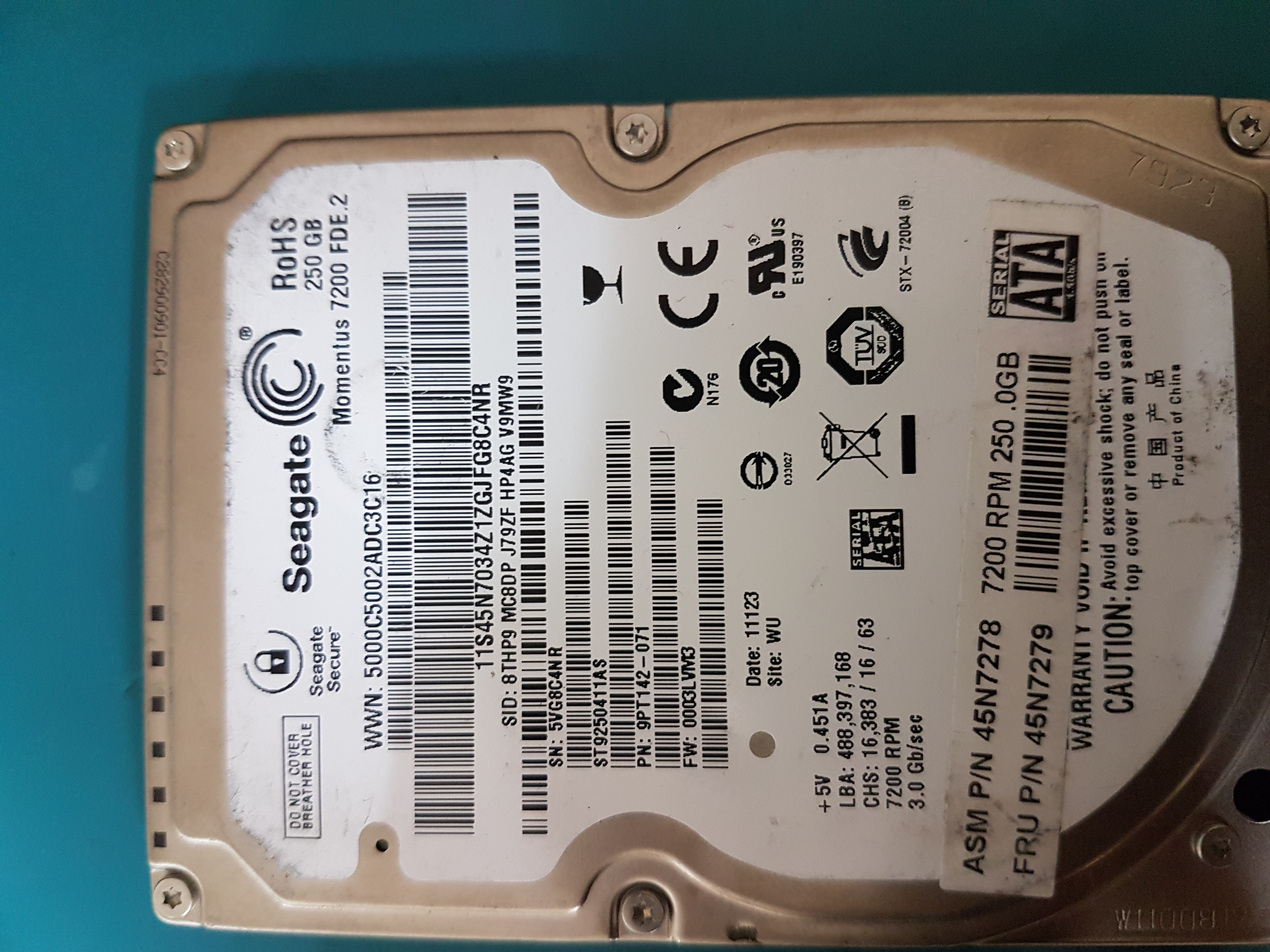

also the latest drive may change the user data by editing 02 module. same like Seagate SID drives, in Seagate SID drive if you use Z0,0,22 then the Seacos encrypted sector will be removed, and you get permanent access to terminal. now you can recover the data, once you edit any of user data sector then you will loss all user data.
Because after editing the sector , hdd write it by encryption, and when you read all byte of same sector goes in to garbage shape, because the decryption key is erased. (Seacos SID key) , the Key is always written on the HDD sticker, some one have to make a software to clone all sector of drive using the SID key, if the data goes garbage.
After that you cannot use this hdd in pc, because the hdd have encryption sector and not have decryption sector.
then you have to LOAD LOADER with winfof to update the firmware, also you can use Seagate firmware update.
after firmware update, like in my case hdd have FW=0003LVM3 anf after Loader write with Winfof the firmware version become 3LVM1
i attached my loader you can download
0003LVM1.zip [598.47 KiB]
Downloaded 1191 times
Its not easy to work with Latest drives, they are making it more and more complex.
Picture of Seagate SID self encrypted drive
you can see the SID key
Will upload the picture of Data sector soon, what happened if we remove the Seacos Security sector and AT overlay.
as written in the F3 commands document
