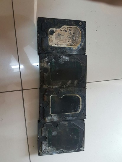

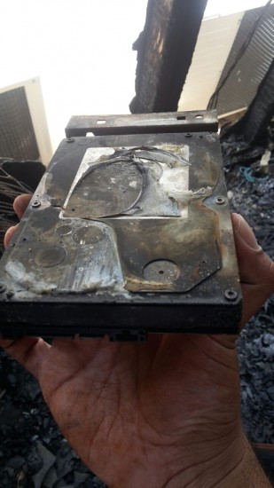

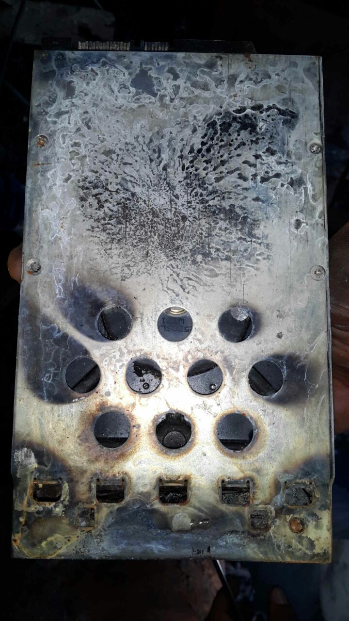

Hi

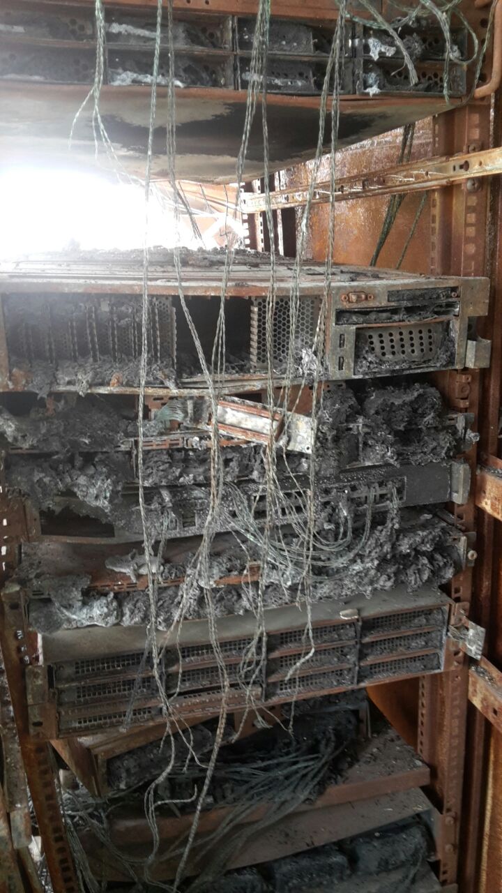

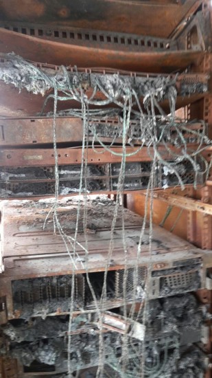

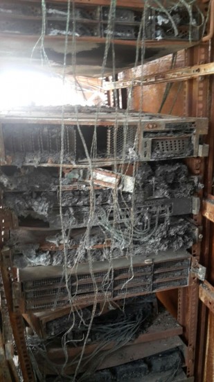

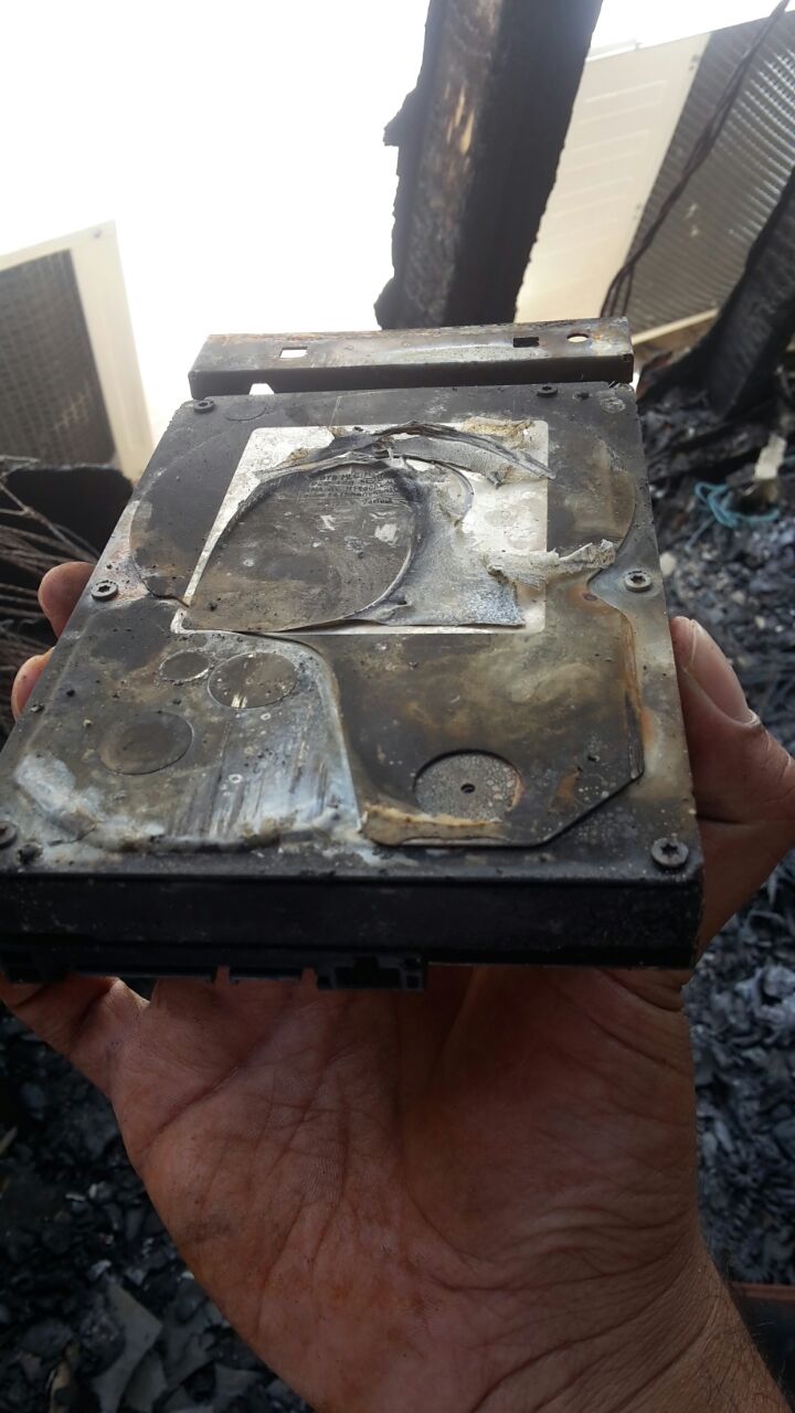

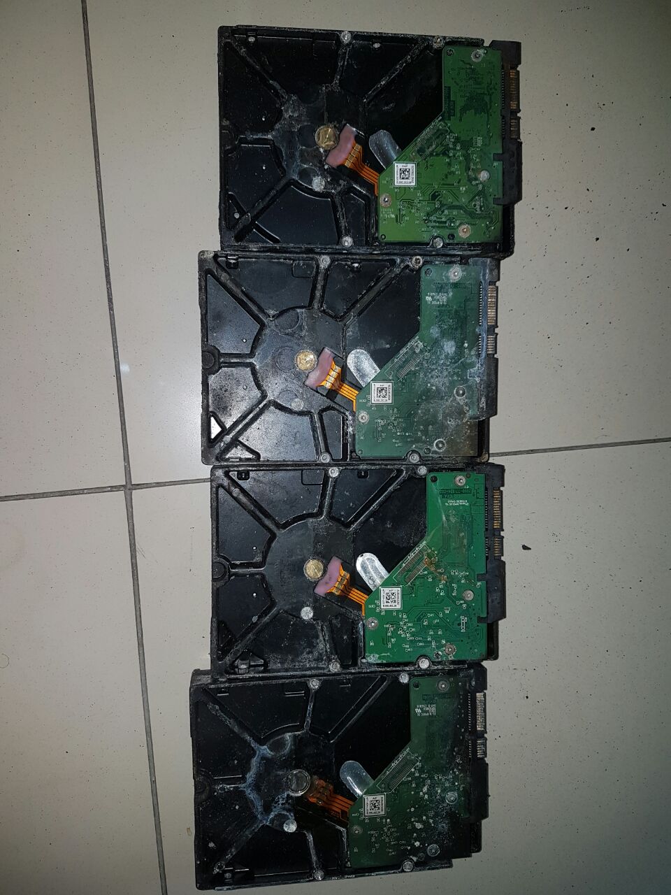

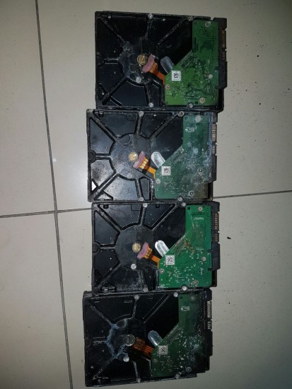

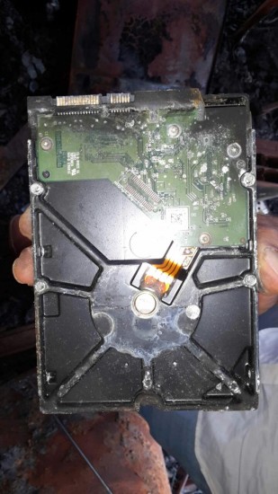

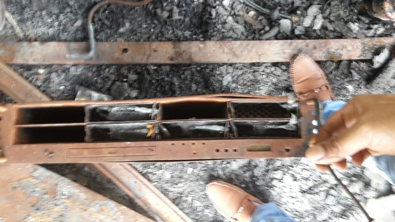

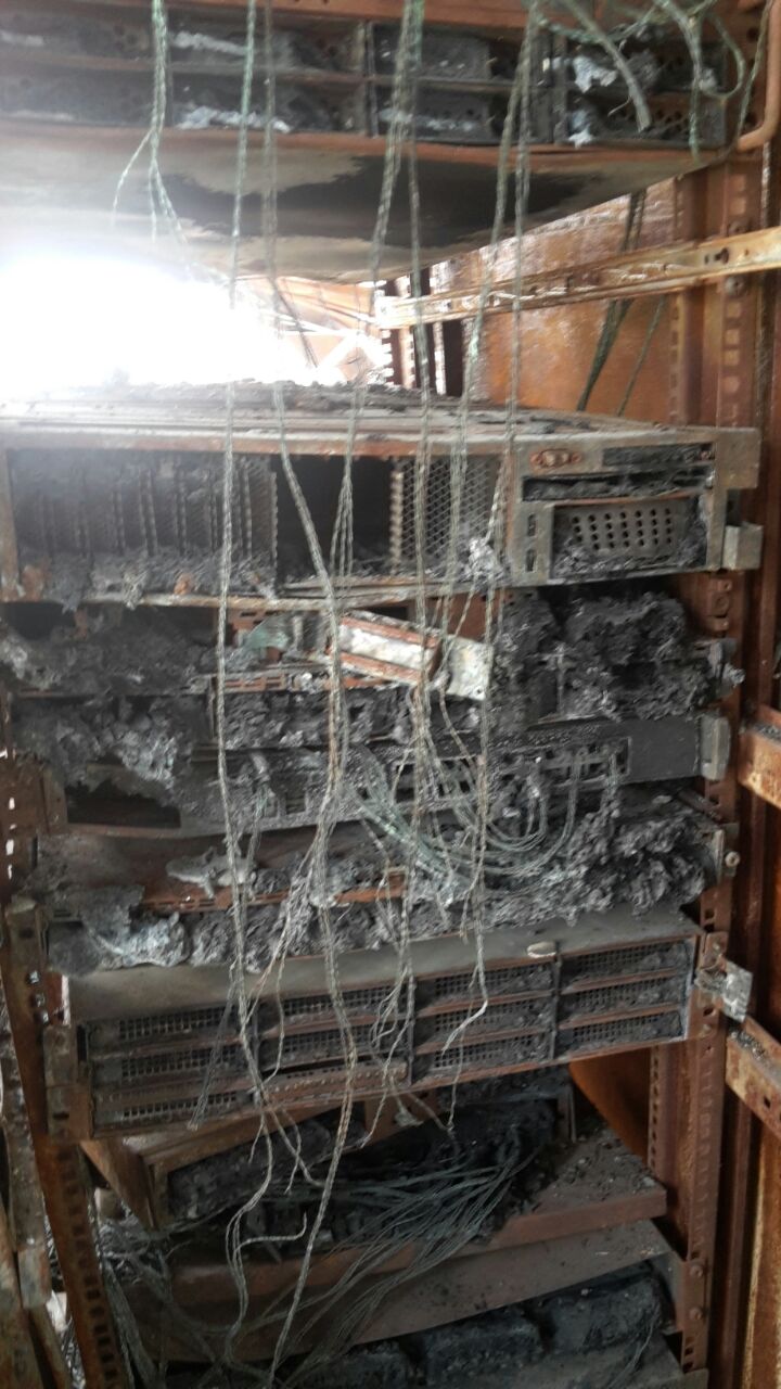

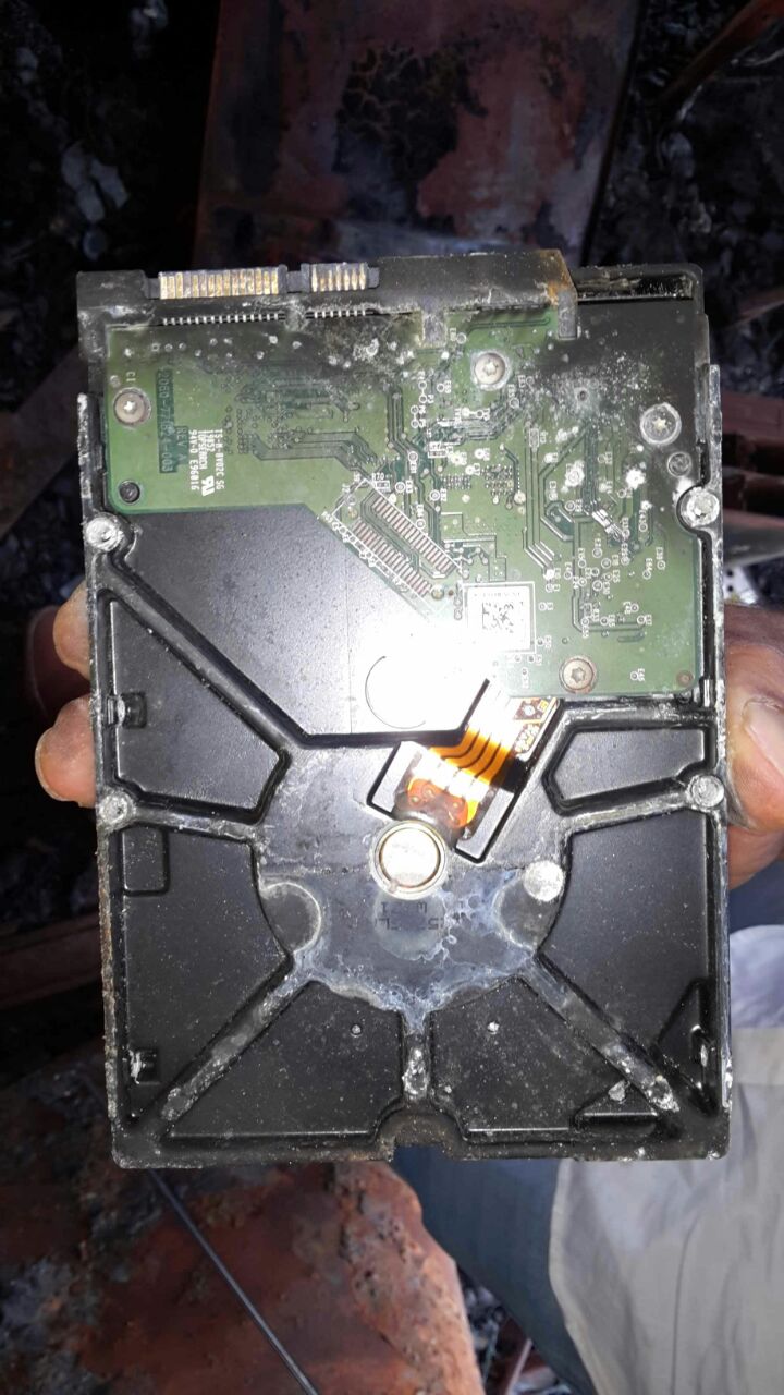

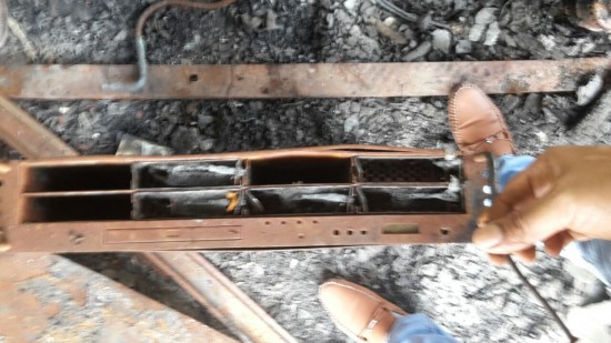

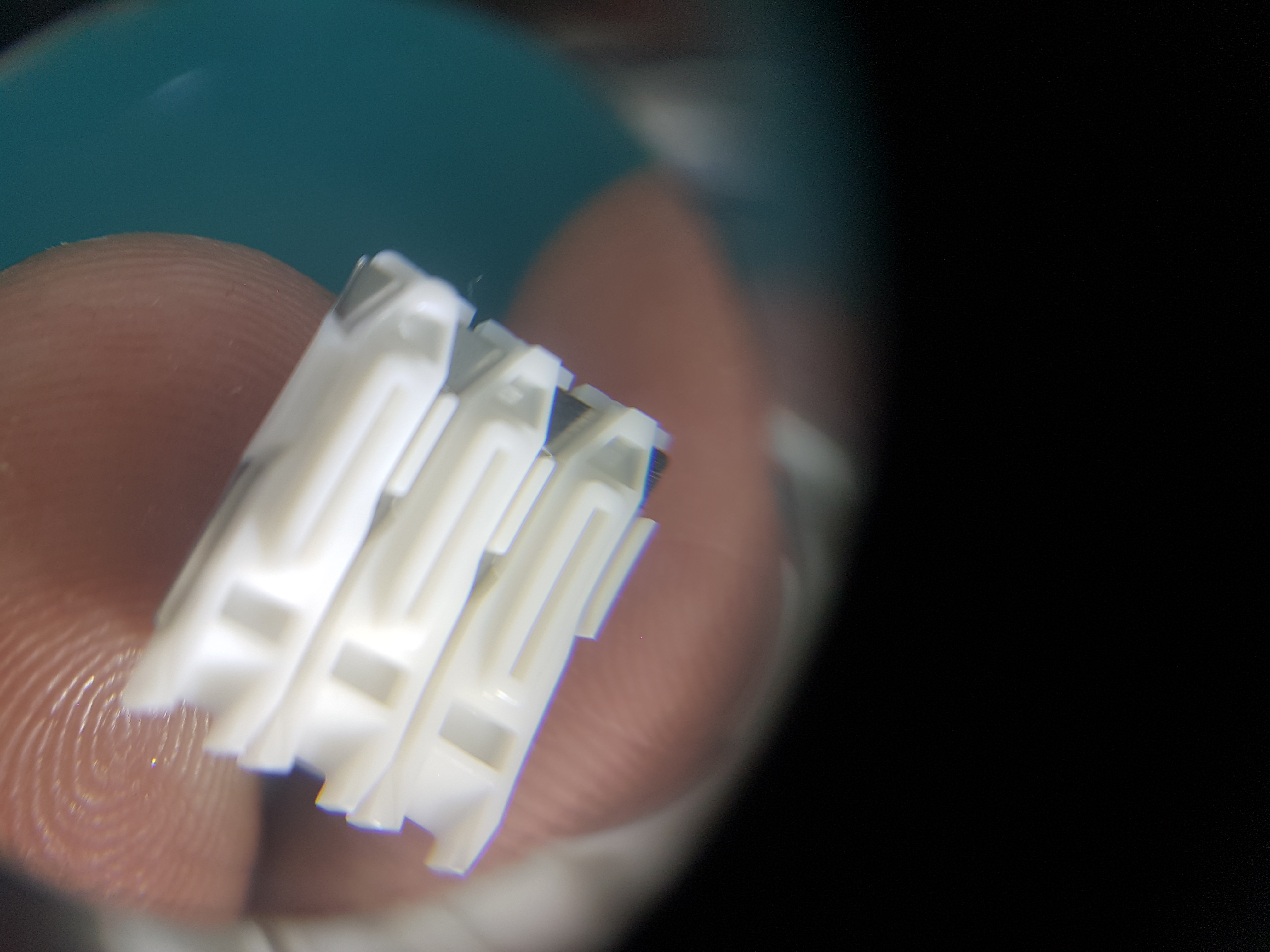

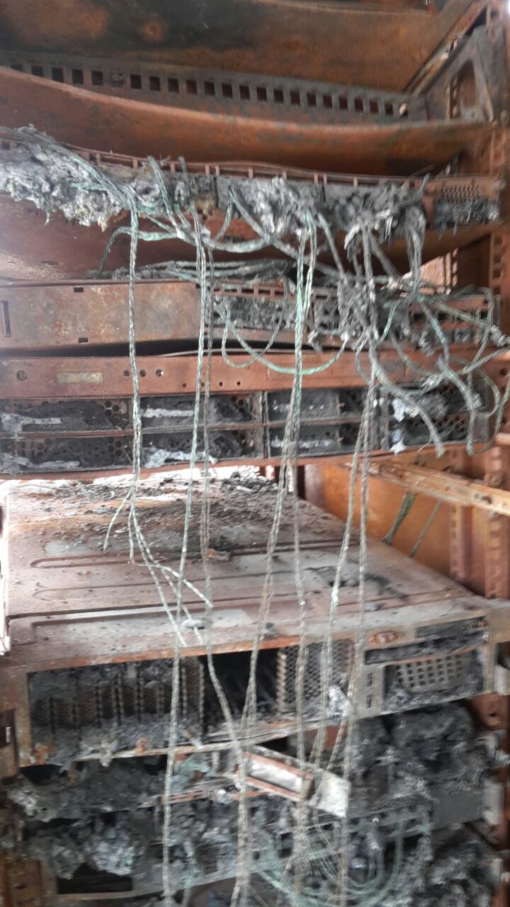

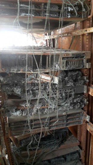

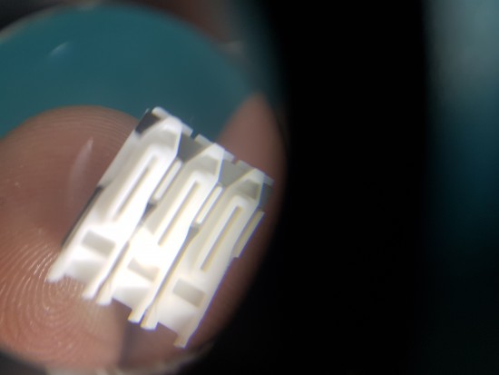

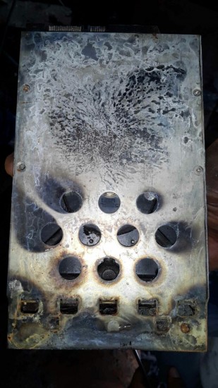

Got 3 servers with 18 drives , fully burned. Need all the data

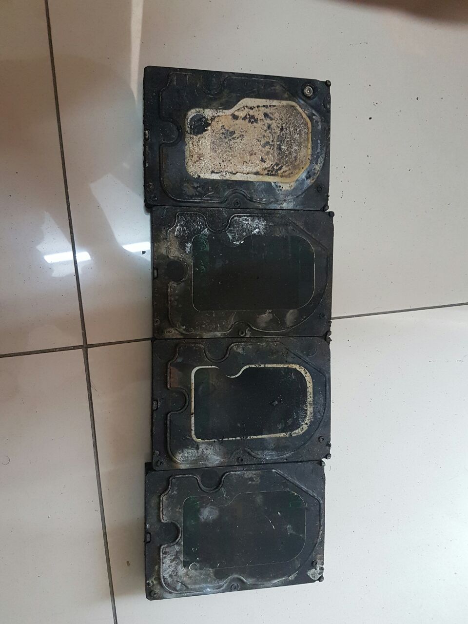

Top plates of every hard disk have a smoke signs.
Only one data has been repaired and cloned successfully.
any one clean such kind of Hard disk before ?

A heavy fire. The disk plates might get de-magnetized under a high temperature. And if this is the case, the data is completely lost.

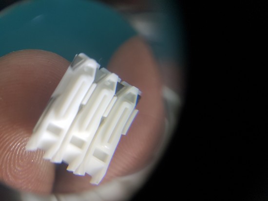

Hi
I not think so that the platers goes demagnetized. Because i washed 1 drive top plate.
All are clicking. After alot of strugle i can read full fw and rom of all 5 drives.
All drives have 2 head working out of 4. The top plate head is not working.
I opened one drive. And i see that the top plate have smoke sign.
I cleaned the sign with isopropyl 100% pure. Then dry with cotton swab.
Then the drive detect one time with new heads. And after that again start clicking.
Problem is i cannot pull out all platers together for cleaning. Because wd company put a big black spacer between the platers.
Only way is to pull out platers one by one.which i think is extremly dengerous.
Still thinking what to do, to get better result.
Waqas ali

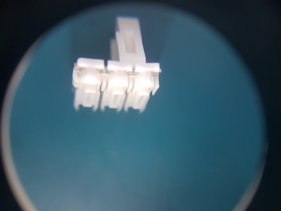

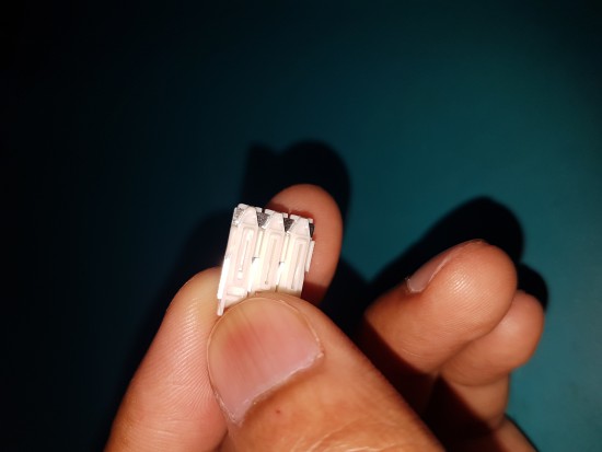

Hi

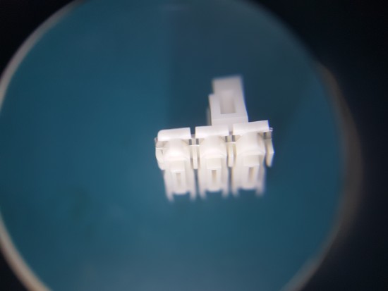

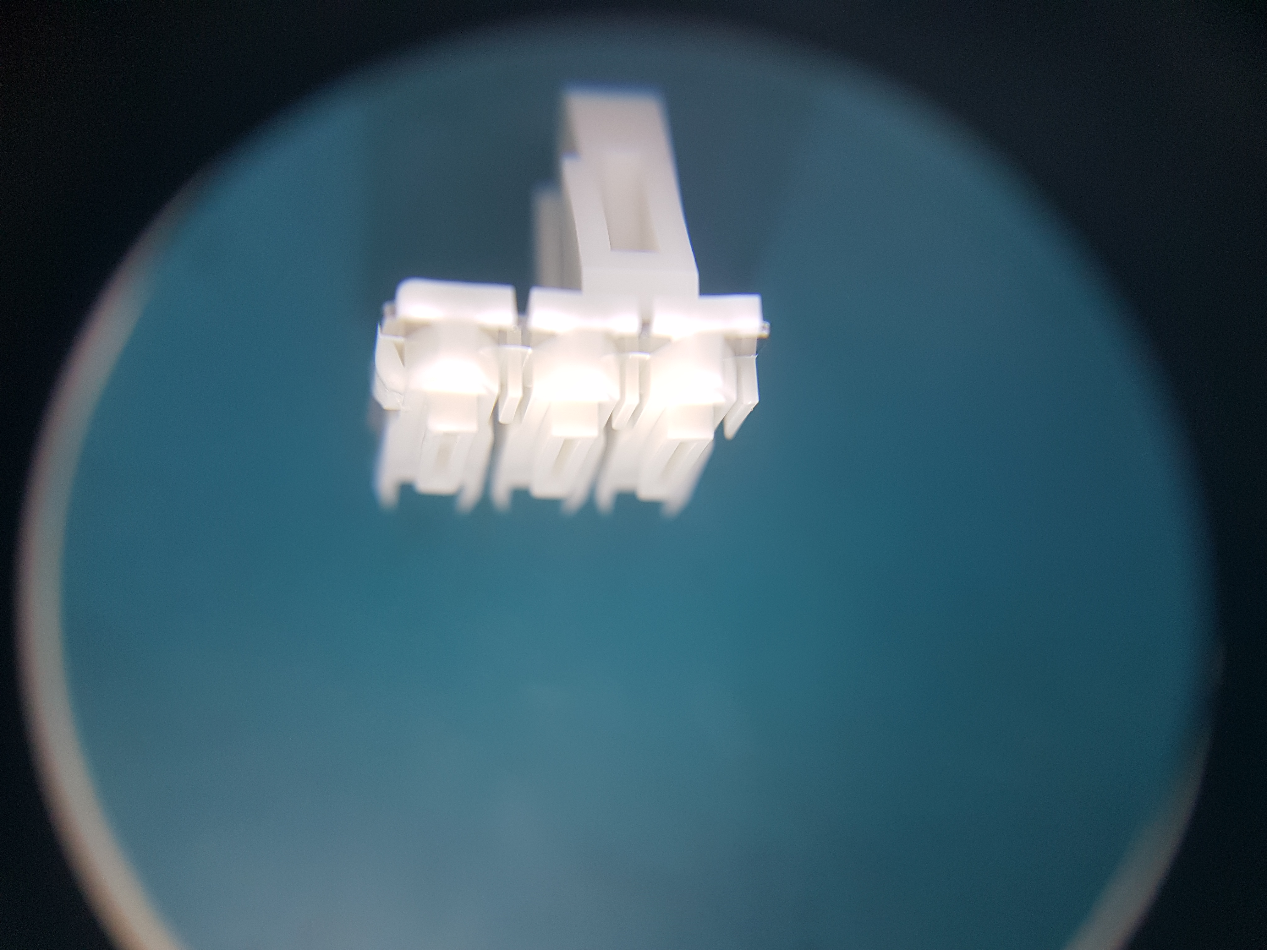

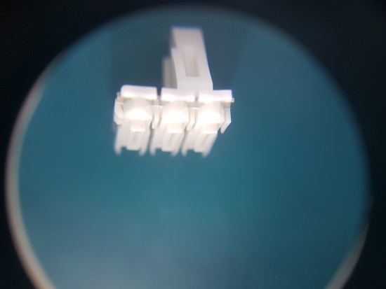

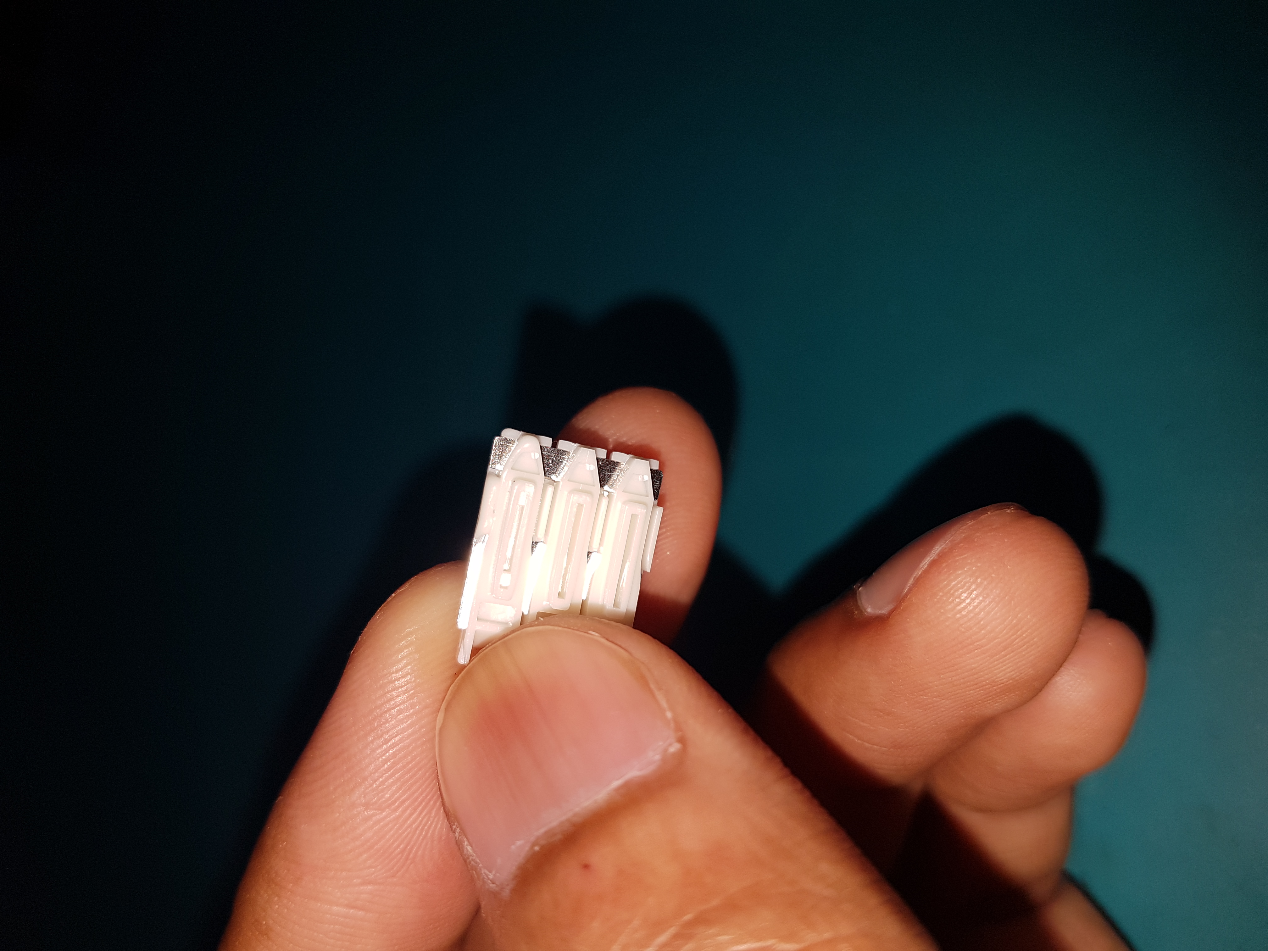

No need to lift up the H3, because i already Cleaned the Plate 3.
See the parking ramp H3 is melt due to head, but others are good.
I have ordered some chemicals and special high quality class 10,000 clean cloths. for these drives. when reached will test on my own drive first.

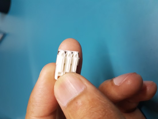

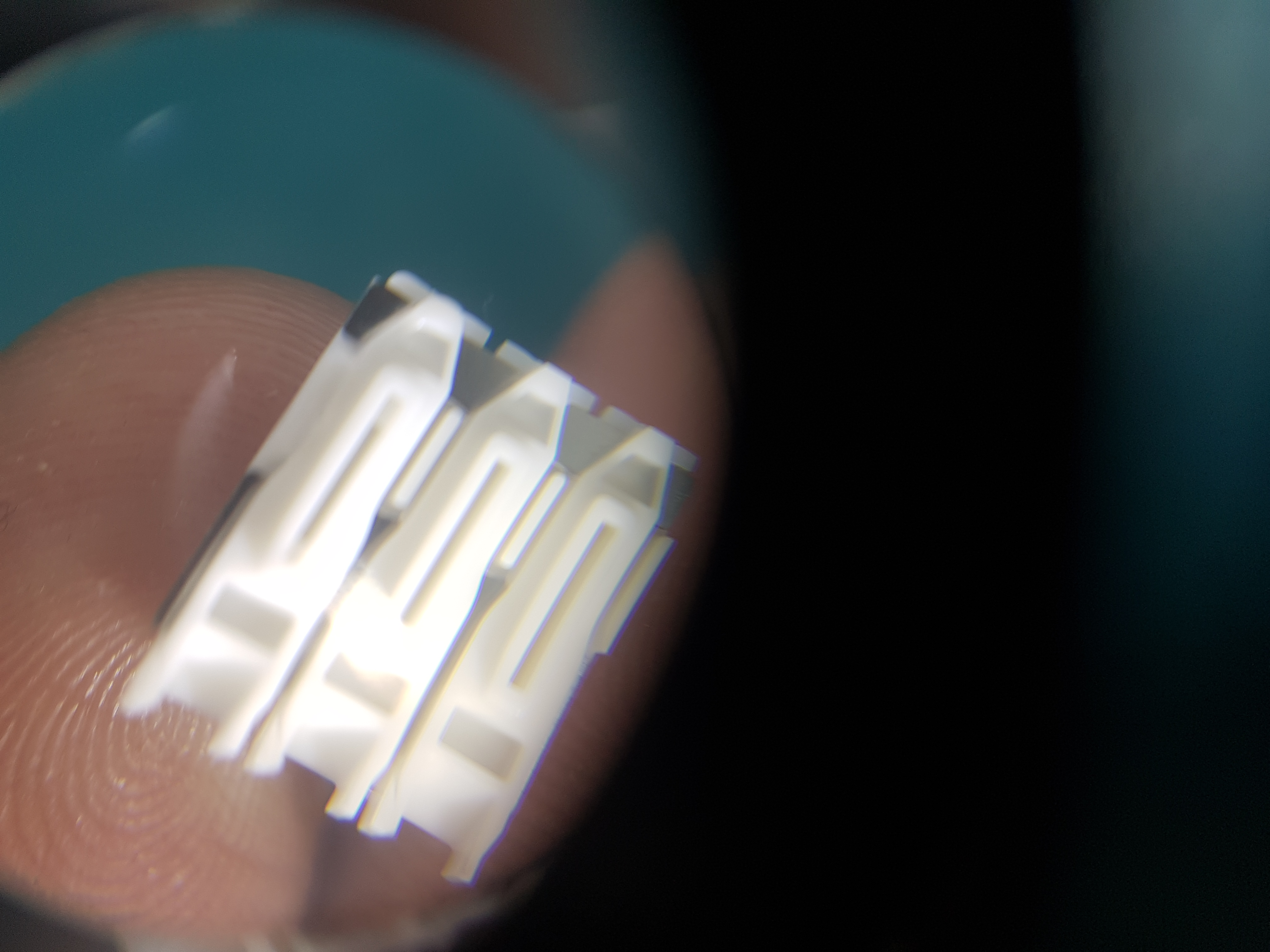

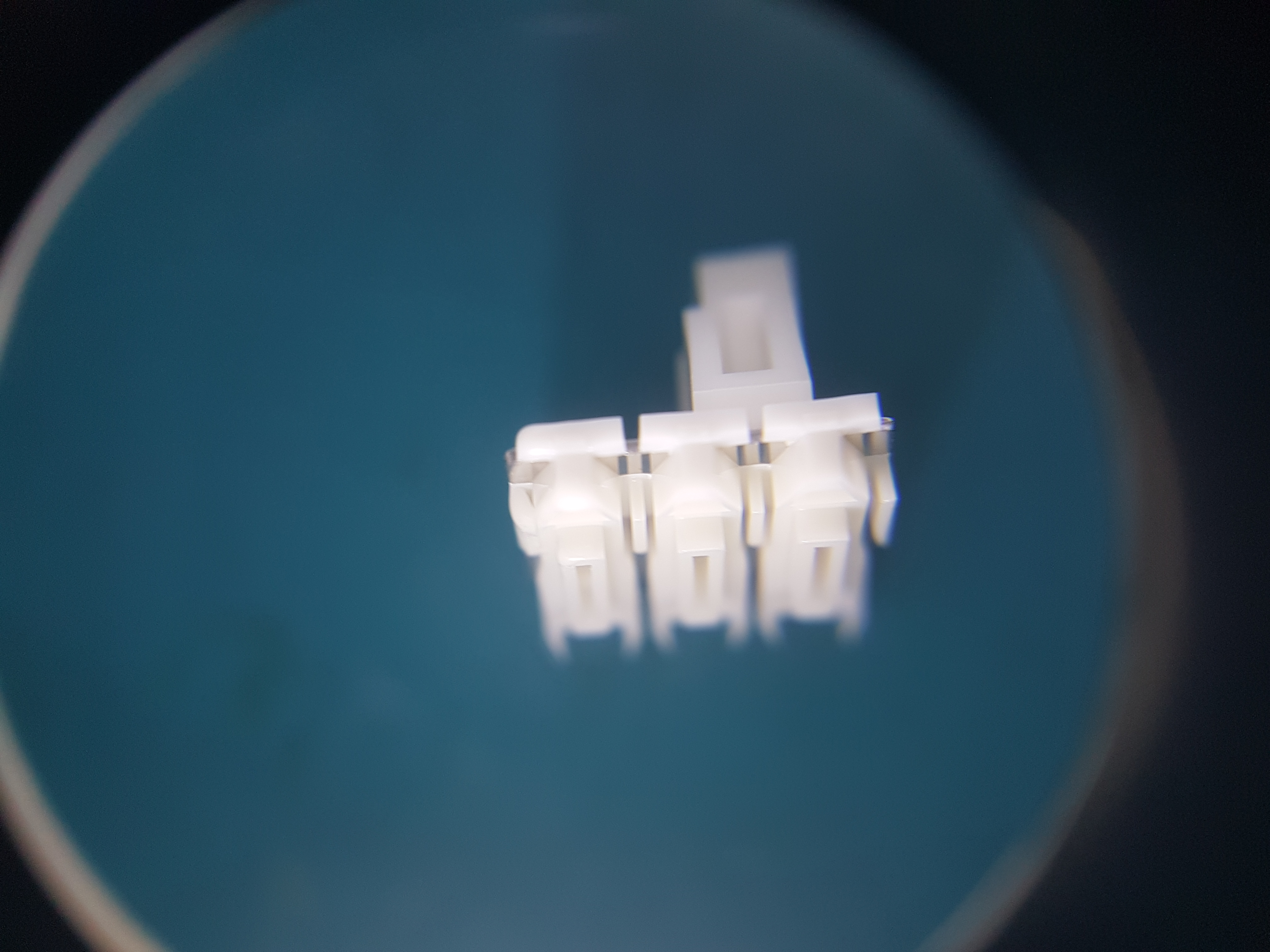

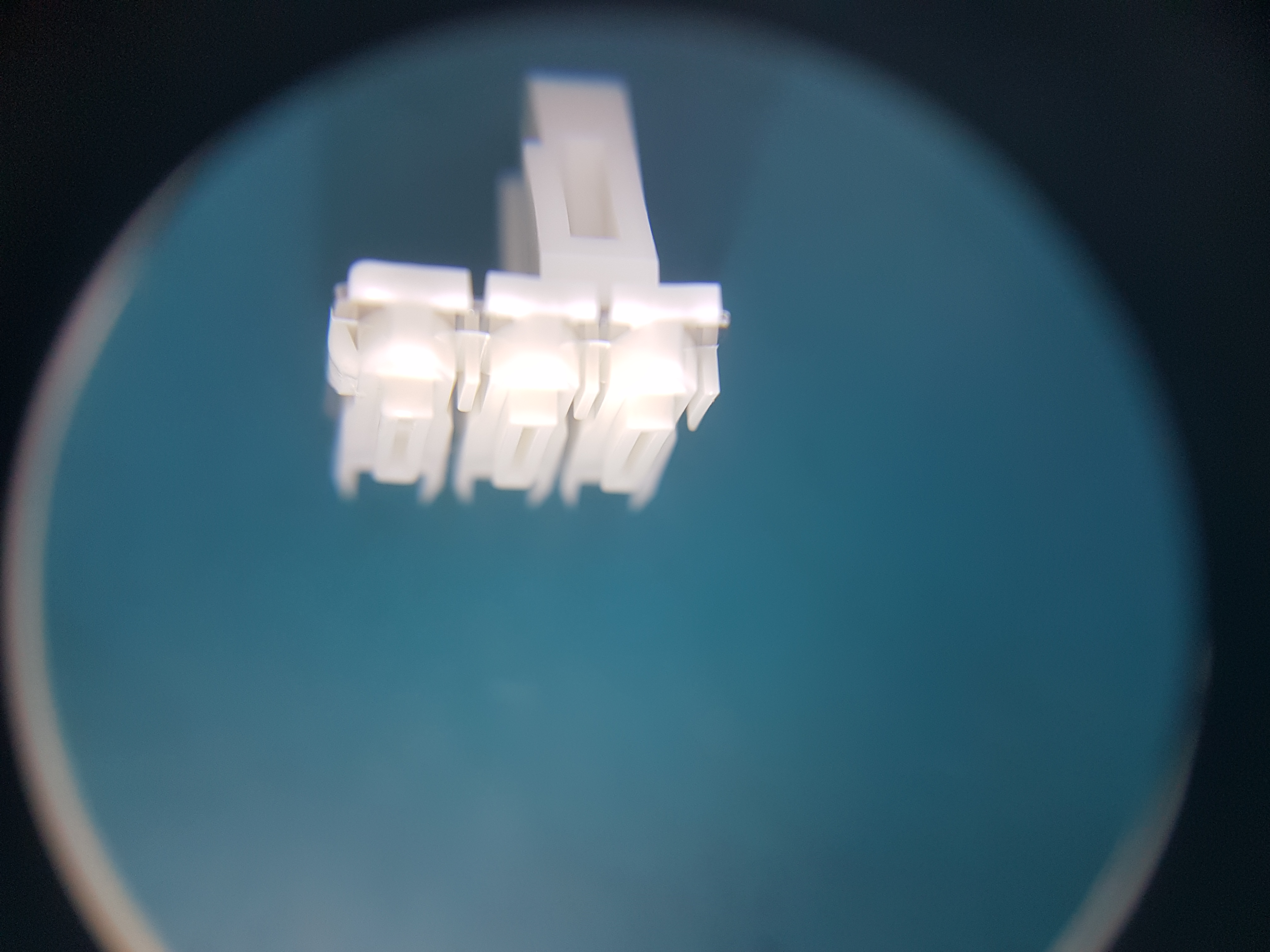

here are some pictures
Waqas Ali
