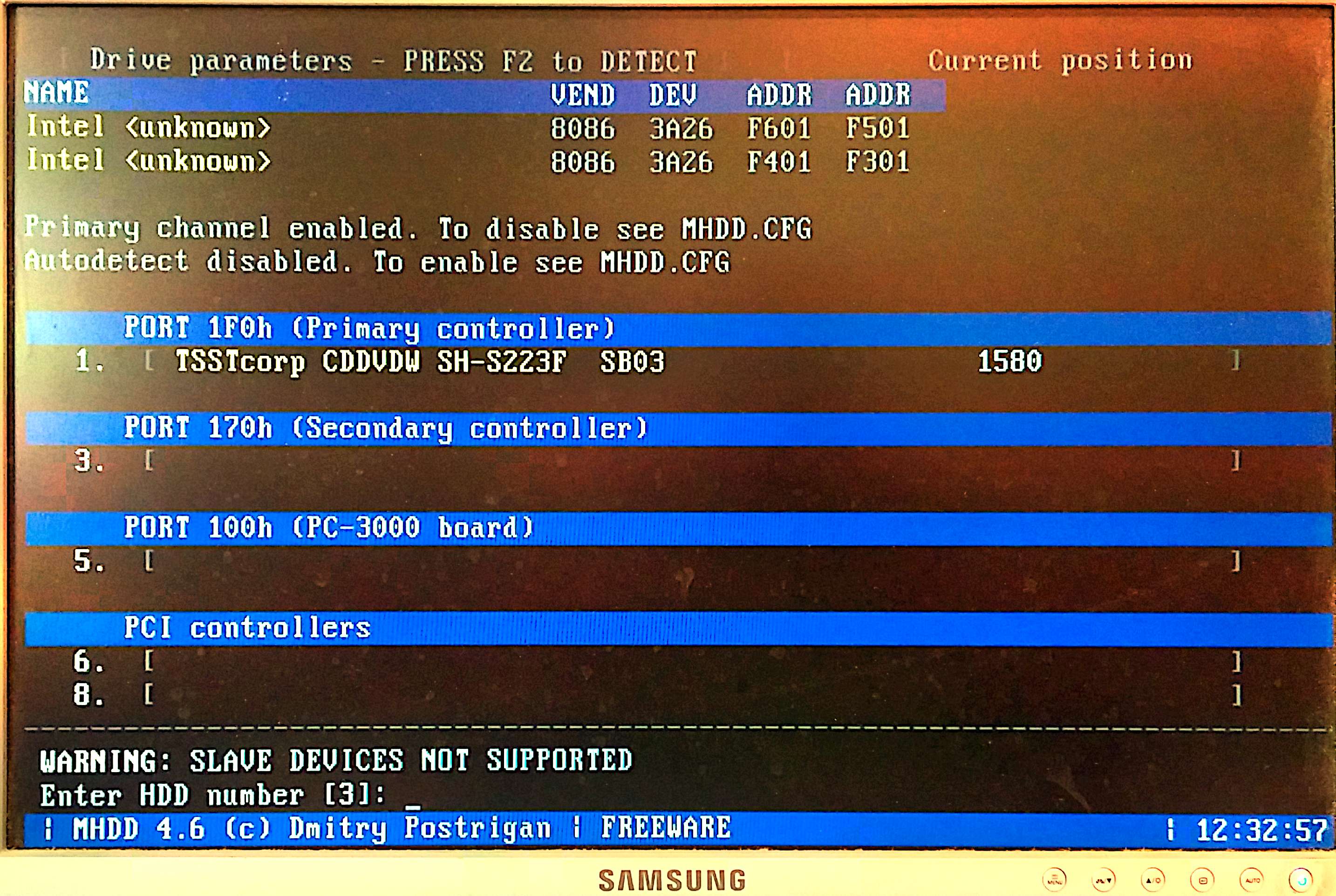

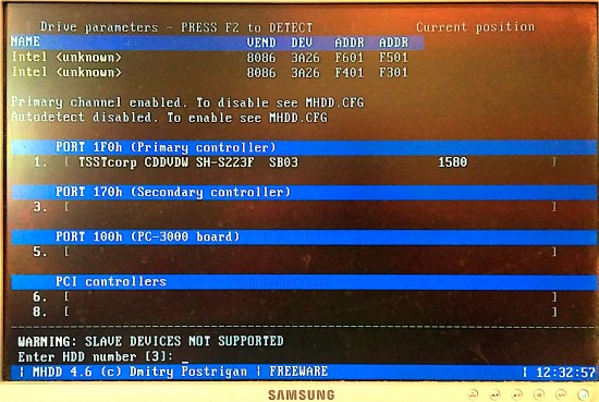

I entered my syste, using the MHDD boot disk and got the list of drives shown in the attach pic.
Which one should I choose?

Your drive is not showing. Have enabled BIOS setting to IDE/Legacy mode?

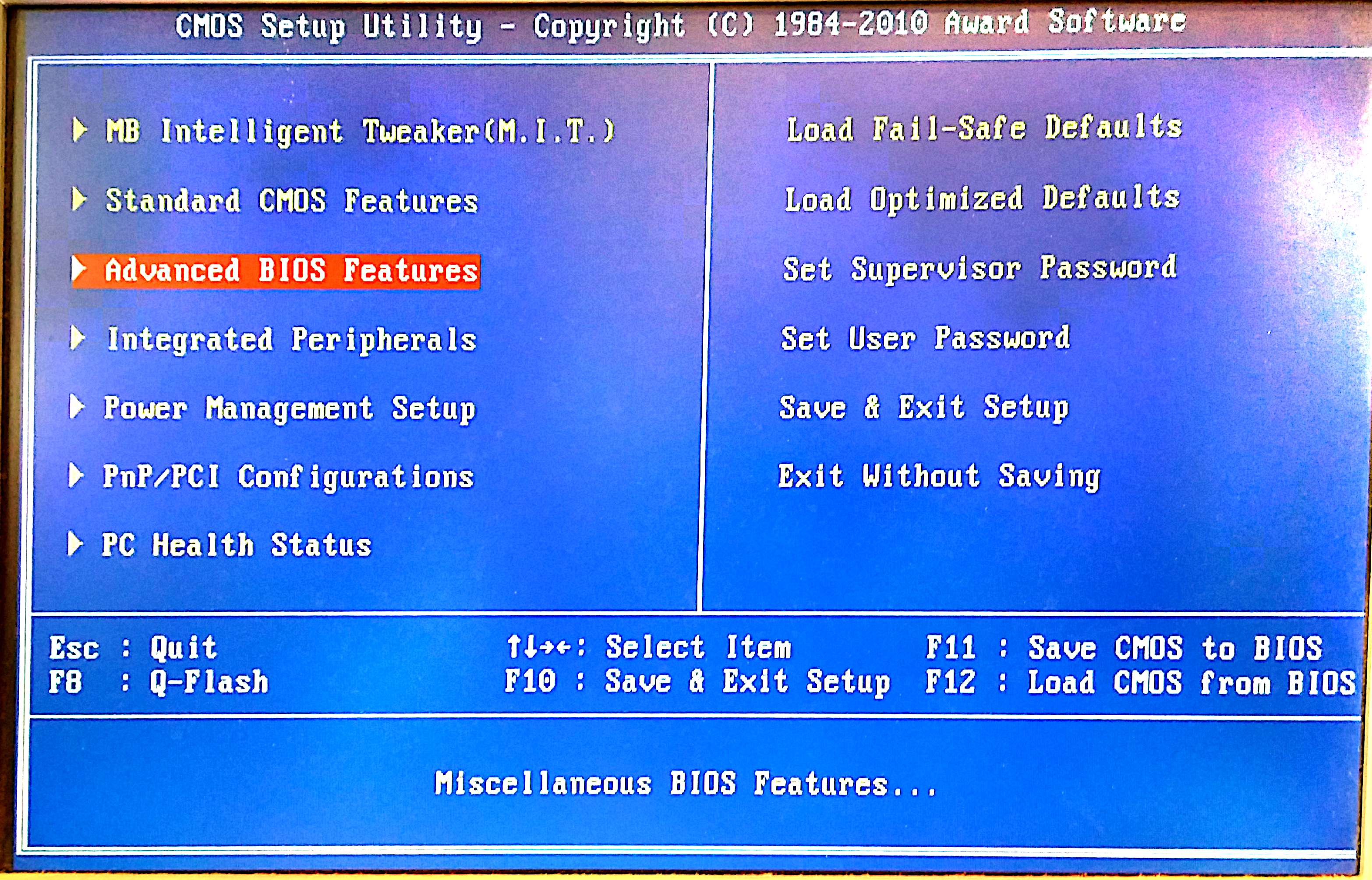

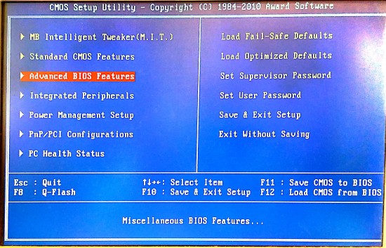

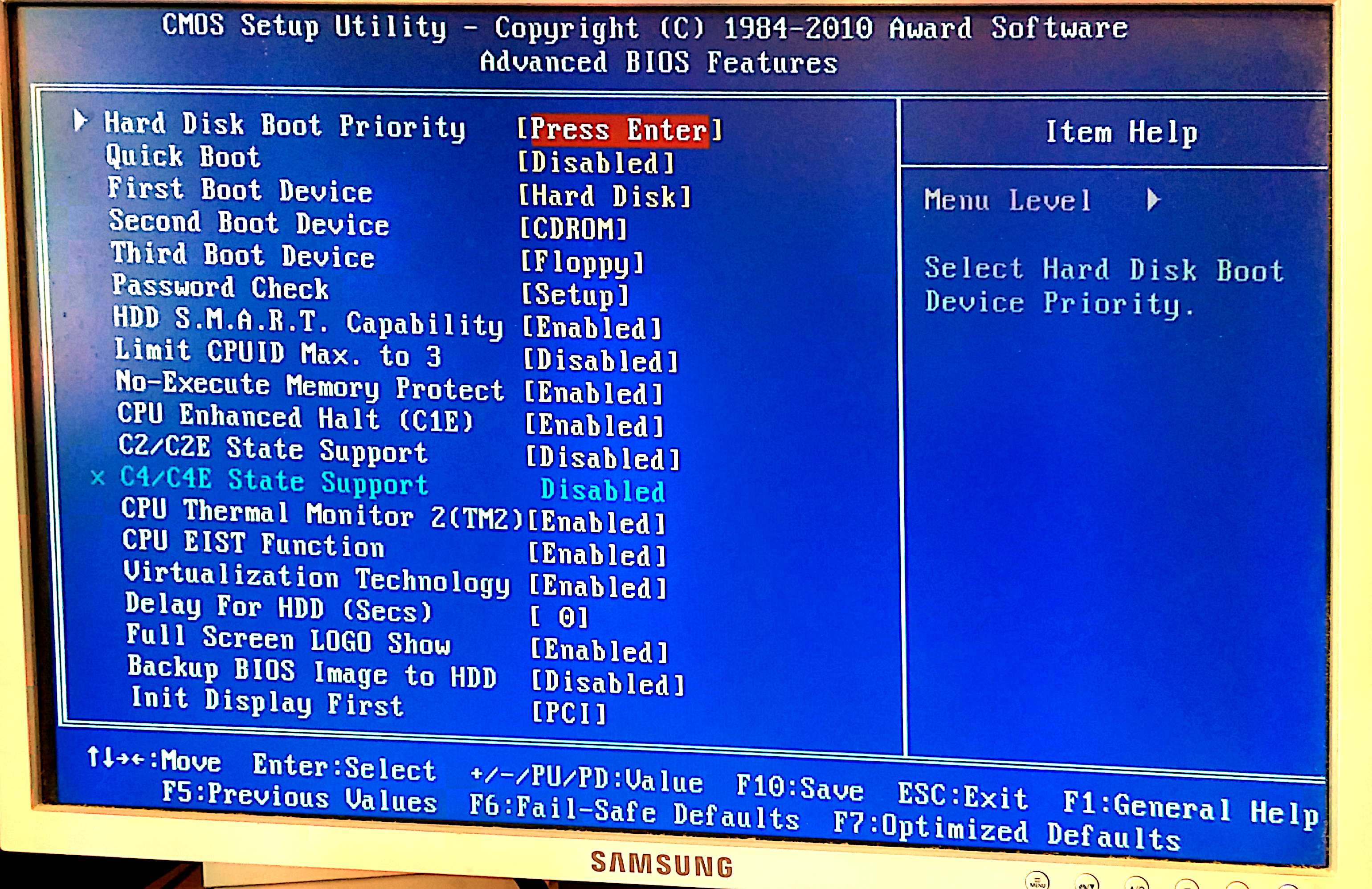

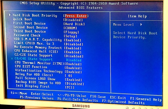

I searched for this option in my BIOS settings and failed to find it
Please see the following two screenshots:

It has been a while since I used the old Award BIOS, but from memory I recall that the setting is in under Integrated Peripherals, normally there should be options there to select between IDE (Legacy) / AHCI / RAID modes.

The drive is set to IDE. "Legacy" isn't added to this term and the only other option is RAId.
