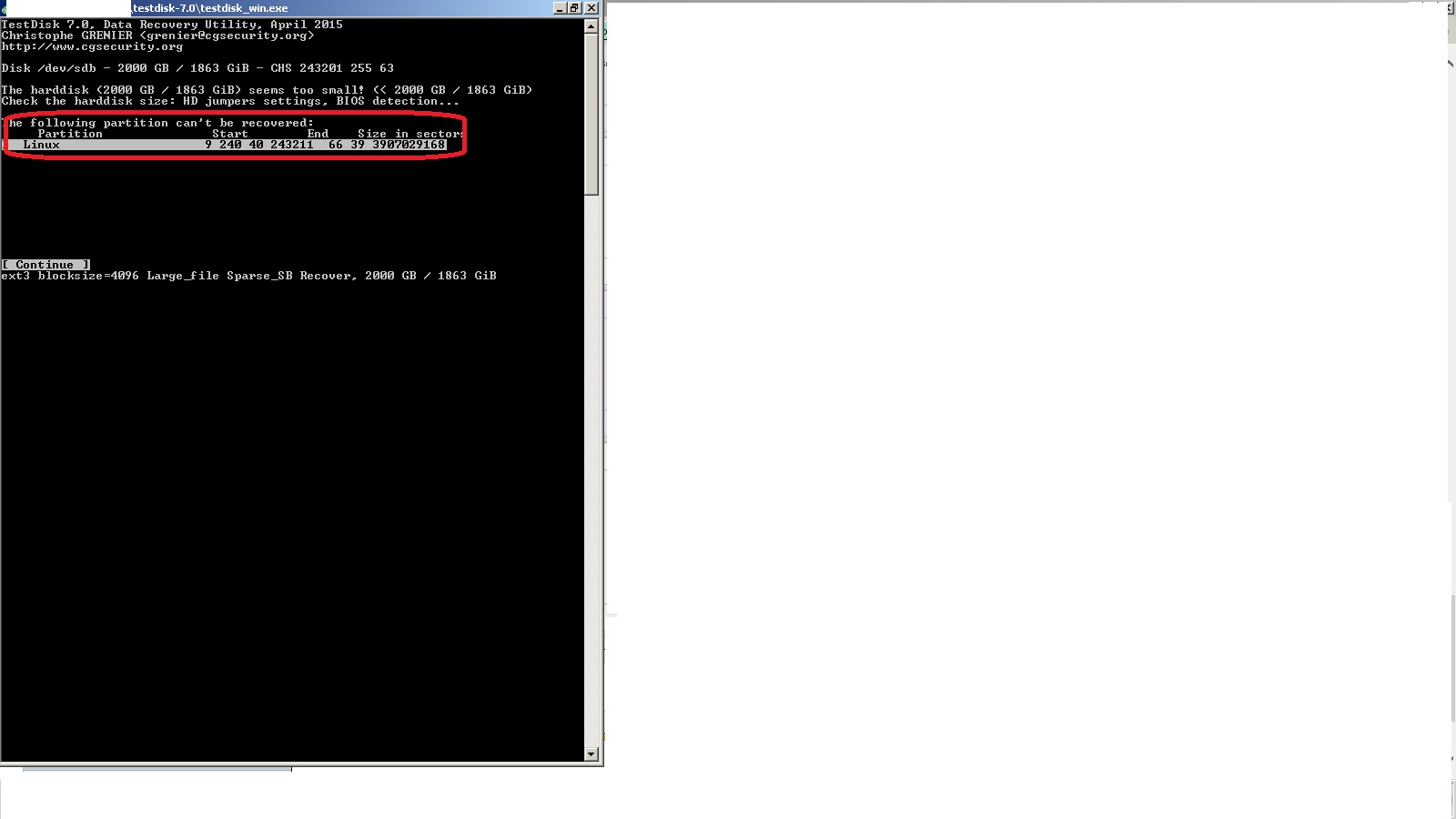

Any chance that this would have been easily resolved with testdisk?
 Post subject: Re: Advanced Ext3/4 Recovery tool
PostPosted: October 29th, 2016, 4:06
Posts: 548
Location: brisbane
Hi lcoughey
I have just given a try to testdisk ,but it says recovery not possible.
I have often observed difference between free softwares and commercial ones. Possibly testdisk is unable to handle large no. of files.
anyway thanks.
UFS support technican has remotely analysed partition and has suggested some changes. They have also a new software (http://www.sysdevlabs.com/product.php?id=rxp6).
I am now trying reclaim me and will post results.
