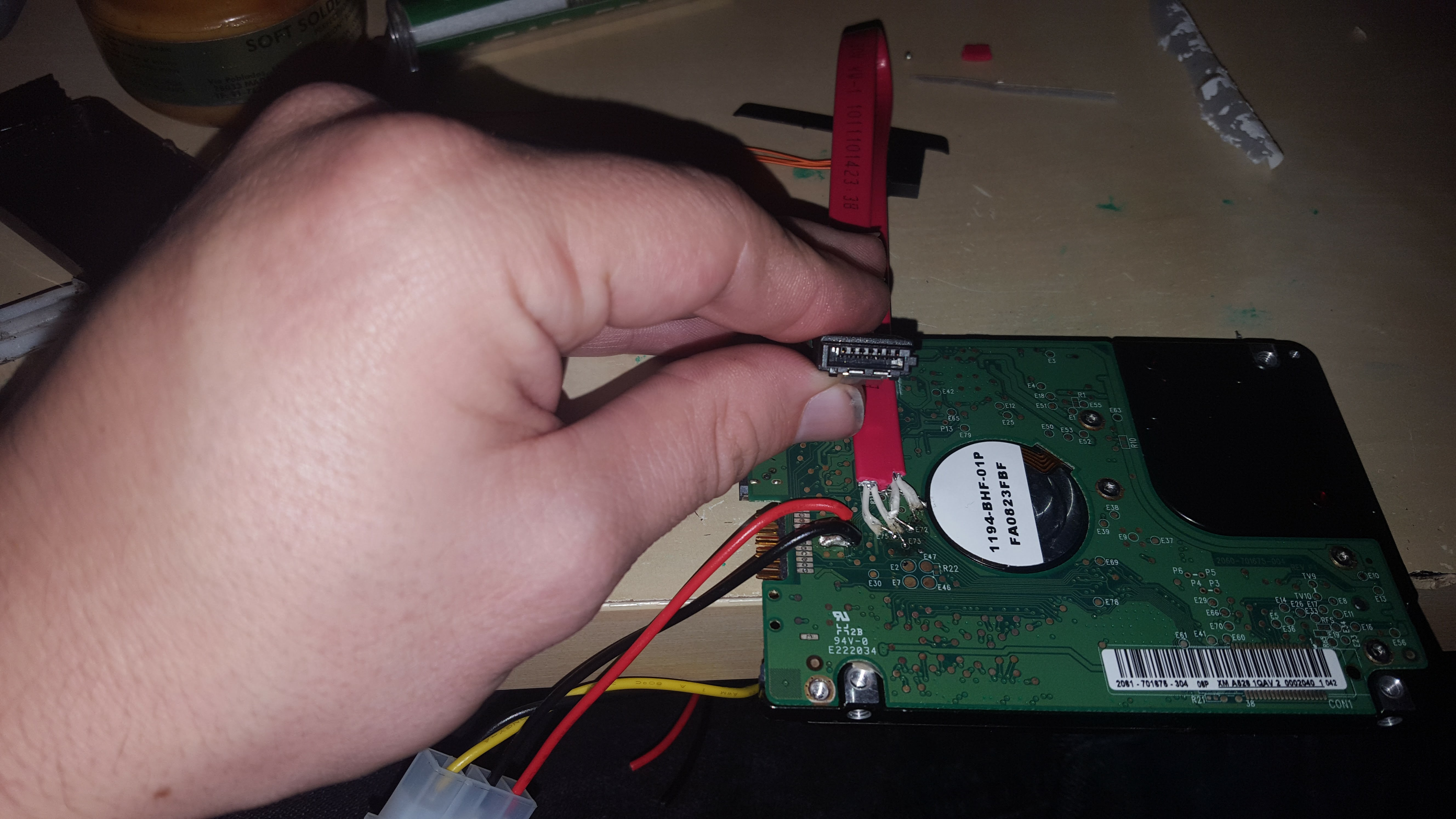

Before jump again to buy a new PCB, I have tried to modify my USB PCB to add the SATA connector. This time I took my time to recheck everything. However when I boot linux I can see this errors:
[    2.368056] ata2: SATA link up 3.0 Gbps (SStatus 123 SControl 300)
[    2.368129] ata2.00: link online but device misclassified
[    2.368135] ata2: link online but 1 devices misclassified, retrying
[    2.368198] ata2: reset failed (errno=-11), retrying in 10 secs
[   12.368055] ata2: SATA link up 3.0 Gbps (SStatus 123 SControl 300)
[   12.368126] ata2.00: link online but device misclassified
[   12.368133] ata2: link online but 1 devices misclassified, retrying
[   12.368195] ata2: reset failed (errno=-11), retrying in 10 secs
[   22.368055] ata2: SATA link up 3.0 Gbps (SStatus 123 SControl 300)
[   22.368125] ata2.00: link online but device misclassified
[   22.368132] ata2: link online but 1 devices misclassified, retrying
[   22.368194] ata2: reset failed (errno=-11), retrying in 35 secs
[   57.048046] ata2: limiting SATA link speed to 1.5 Gbps
[   57.368049] ata2: SATA link up 1.5 Gbps (SStatus 113 SControl 310)
[   57.368116] ata2.00: link online but device misclassified
[   57.368123] ata2: link online but 1 devices misclassified, device detection might fail
This is problematic because I can't start to use any of the tools that you told me if the block device node is not created by the kernel. Is there anyway that I can try to use this tools.

Have you tried inverting the position of the sata data wires ? Also, can you post some pictures of your converted drive ?

Hello thank you again for the answer, this are the connections. The SATA cable is not twisted so the wires from left to right correspond with the connector pins 2,3,5,6 starting to count from left in the picture.

@lordrafa, the easiest way to confirm the SATA pinout is to compare the USB and SATA PCBs. Follow the SATA Tx/Rx traces back to the MCU (88i9045).

PostPosted: October 19th, 2016, 16:55
Posts: 1388
Location: isreal
1. Have you removed the capacitors ?
2. E71 goes to 2 (A+), E72 goes to 3 (A-)...

The pinout looks fine. A+ and A- goes to E71 and E72 and B- and B+ goes to E73 and E75 and I have tracked the SATA PCB a looks fine. Also I have removed the CAPs. BTW removing this CAPs looks a little bit dangerous, maybe it would be better cut the tracks and solder the SATA before the CAPS. I say this because I think that I have fried again the controller, because again I am not getting any response. I think that I am going to give a shoot to the SATA version PCB. Can you confirm that this is the one that I need 2060-771672-004.
