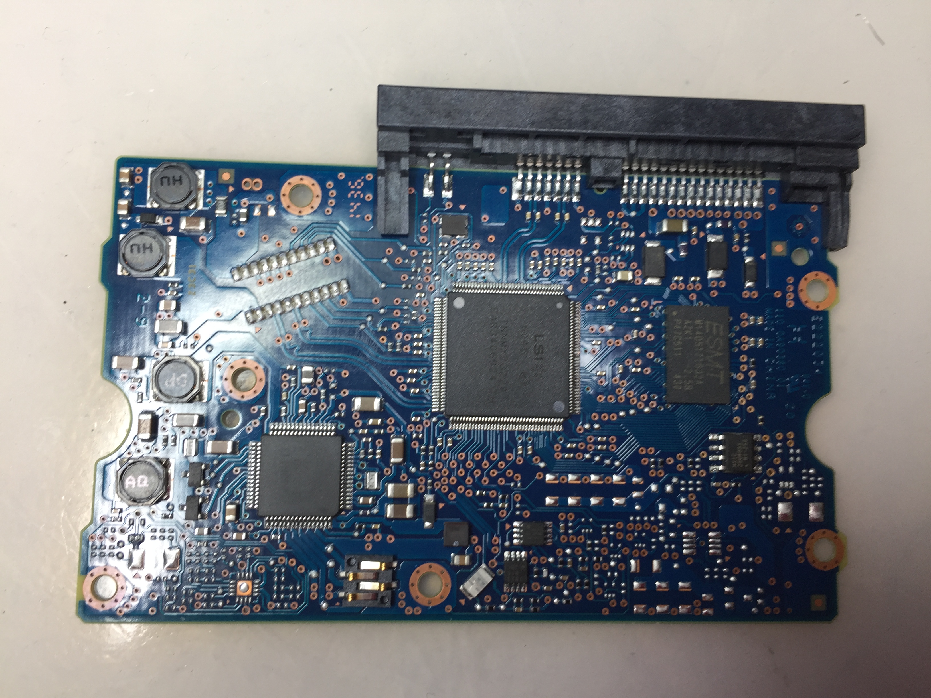

I have a Toshiba/Hitachi DT01ACA200 with faukty PCB attached.
I swap ROM, PC3000 goes imediatly to ready but motor doens't start. DO I need to change any other chips (NV-RAM) If yes, ca you help me to identify it on the PCB?
Thanks & Regards,

I believe that the "NVRAM" data are in the "ROM". If you upload your ROM dump, someone may be able to identify the problem with it.

Thanks for the suggestion.
Attahed ROM and NV-RAM files.
Any help will be welcome.

I don't see any attachments
