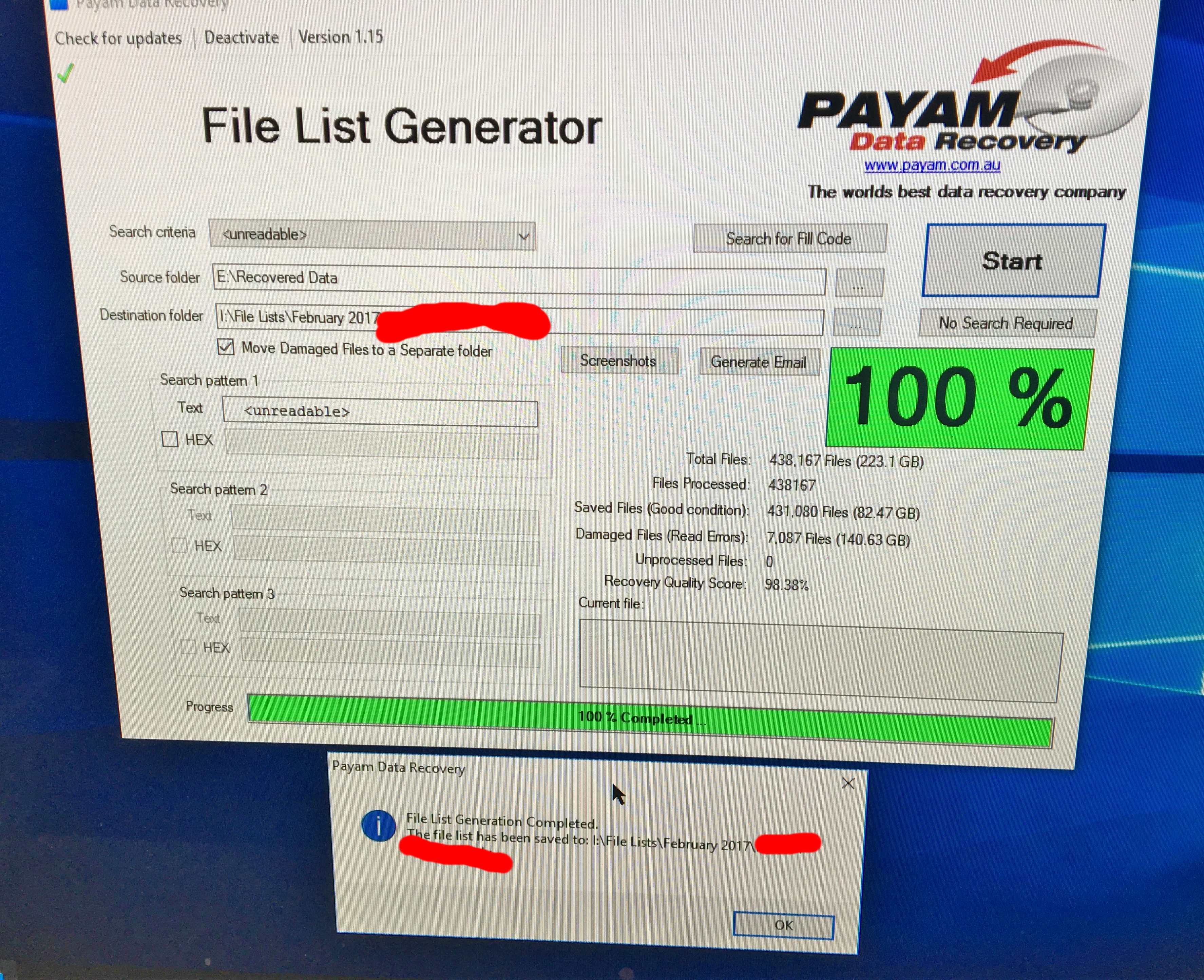

 Post subject: Re: Any reliable file testing and listing program available?
PostPosted: February 16th, 2017, 3:18
Joined: October 29th, 2010, 20:30
Posts: 40
We have a custom made software we use to make a file list and detect a repeated pattern e.g " <unreadable> " - and makes a HTML file tree type output for customers to see good/bad files very easily based on skipped sectors during imaging/cloning on tools like Deepspar Disk Imager and PC-3000/Data Extractor Or Atola Insight, we setup all of our images to fill skipped/unread sectors with the same pattern in our lab and it makes detecting the bad files based on these criteria of 'bad' to be detected easily. We often clone a drive after a head replacement and recover 99% of the data, this will detect which files have skipped/unread sectors and can move them to another folder. There are many other ways you can also do this, but we made our own software to suit our needs to help complete the data recovery process faster and present the results to our clients faster.
It also has a built-in screenshot making tool and can search for fill patterns (e.g for Encrypted drives) and email template generator to produce a report for your clients by email which it uses the stats of the file list results. If you are interested - email payam@payam.com.au
I'm happy to customise it to your company and sell you an annual license for it. Currently, it's only used for our own company and with our own branding/logo.
Or send me a PM.
File comment: Screenshot of Payam Data Recovery File List Generator Software
Or send me a PM.
Very nice work there sir .i see a lot of big data recovery companies with their own tools
