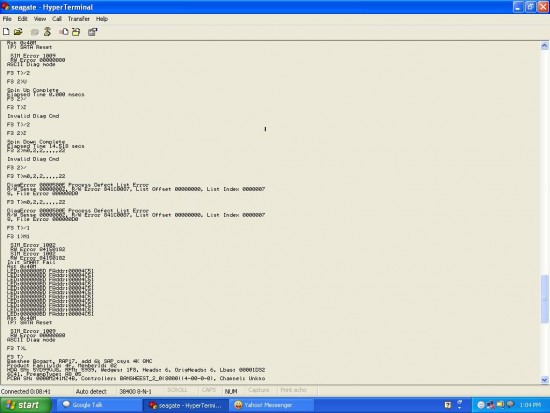

PostPosted: April 18th, 2017, 3:52
Joined: February 22nd, 2016, 6:39
Posts: 114
Location: india
Model:ST2000Dloo3
PN 9VT166
FW CC98
SNO 5YD99VJG
DRIVE nOT DETECTED IN BIOS
I did like this
Rst 0x40M
(P) SATA Reset
SIM Error 1009
RW Error 00000080
ASCII Diag mode
F3 T>/2
F3 2>U
Spin Up Complete
Elapsed Time 0.000 msecs
F3 2>/
F3 T>Z
Invalid Diag Cmd
F3 T>/2
F3 2>Z
Spin Down Complete
Elapsed Time 14.518 secs
F3 2>m0,2,2,,,,,22
Invalid Diag Cmd
F3 2>/
F3 T>m0,2,2,,,,,22
DiagError 0000500E Process Defect List Error
R/W Sense 00000002, R/W Error 841C0087, List Offset 00000000, List Index 0000007
8, File Error 000000D0
F3 T>m0,2,2,,,,,22
F3 T>/1
F3 1>N1
SIM Error 1002
RW Error 84150182
SIM Error 1002
RW Error 84150182
Init SMART Fail
Rst 0x40M
LED:000000BD FAddr:00004C51

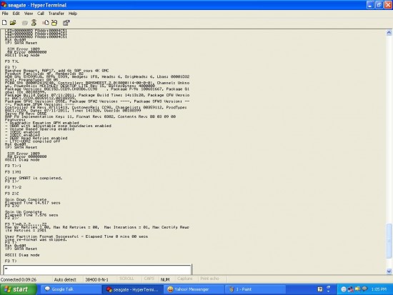

Here I power off drive
and reconnected power
Rst 0x40M
(P) SATA Reset
SIM Error 1009
RW Error 00000080
ASCII Diag mode
F3 T>L
F3 T>
Banshee Bogart, RAP17, add 6k SAP csys 4K QNC
Product FamilyId: 4F, MemberId: 02
HDA SN: 5YD99VJG, RPM: 5939, Wedges: 1F8, Heads: 6, OrigHeads: 6, Lbas: 00001D32
6C41, PreampType: A8 05
PCBA SN: 0000M241MZ4B, Controller: BANSHEEST_2_0(8000)(4-00-0-0), Channel: Unkno
wn, PowerAsic: MCKINLEY DESKTOP LITE Rev 15, BufferBytes: 4000000
Package Version: BGC15D.CCD9.CK03B6.CC98 , Package P/N: 100681667, Package Gl
obal ID: 00188399,
Package Build Date: 07/11/2011, Package Build Time: 14:13:20, Package CFW Versio
n: BGC1.CCD9.00359112.00188399,
Package SFW1 Version: D55E, Package SFW2 Version: ----, Package SFW3 Version: --
--, Package SFW4 Version: ----
Controller FW Rev: 07111413, CustomerRel: CC98, Changelist: 00359112, ProdType:
BGC1.CCD9, Date: 07/11/2011, Time: 141320, UserId: 00188399
Servo FW Rev: D55E
RAP FW Implementation Key: 11, Format Rev: 0302, Contents Rev: BB 03 09 00
Features:
- Quadradic Equation AFH enabled
- VBAR with adjustable zone boundaries enabled
- Volume Based Sparing enabled
- IOEDC enabled
- IOECC enabled
- DERP Read Retries enabled
- LTTC-UDR2 compiled off
Rst 0x40M
(P) SATA Reset
SIM Error 1009
RW Error 00000080
ASCII Diag mode
F3 T>/1
F3 1>N1
Clear SMART is completed.
F3 1>/
F3 T>/2
F3 2>Z
Spin Down Complete
Elapsed Time 14.517 secs
F3 2>U
Spin Up Complete
Elapsed Time 7.576 secs
F3 2>/
F3 T>m0,2,2,,,,,22
Max Wr Retries = 00, Max Rd Retries = 00, Max Iterations = 01, Max Certify Rewr
ite Retries = 29D1
User Partition Format Successful - Elapsed Time 0 mins 00 secs
Zone re-format was skipped.
F3 T>
Rst 0x40M
(P) SATA Reset
ASCII Diag mode
F3 T>
I connected drive to system
Not detected
I kept idle for 10 mts
then again connected to system
Now the drive working ok
"DiagError 0000500E Process Defect List Error
8, File Error 000000D0"
This error caused by SMART?
