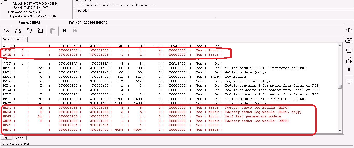

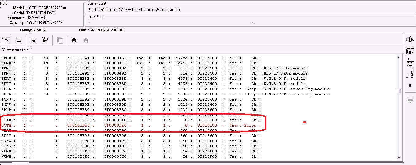

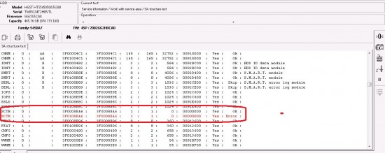

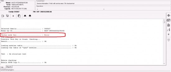

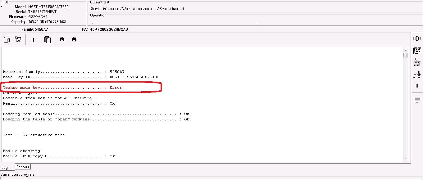

I am working on a typical HGST slim hard disk HTS545050A7E380 .
While starting hitachi utility I get Techno mode Key
Disk has normal detection in my udma and I have taken multiple back ups of fw.

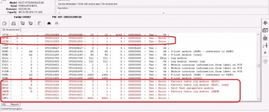

While most of the crucial modules like p-list / G-list are perfectly fine , only few modules are having errors.
Heads seems to be reasonably good as I can read with both heads.
Only issue is large defects while imaging .
I want to know whether those faulty modules have something to do with bad sectors. I am not aware of importance of these modules in reading data.
Module & Head Importance Description
AVZN --- both 0 & 1 copies Importance Not known
HLR1 & HLR2 Importance B Factory Test log module (HLRC)
MFGP Dr Self test parameters module
AMPM Importance B Factory test log
MFGT
DMP1
SCTH

 Post subject: Re: Role of "Factory test " Modules on sector reading
PostPosted: May 31st, 2017, 12:42
Joined: March 9th, 2017, 6:16
Posts: 127
Location: trinidad
I want to know how to tackle " Techno mode key" error and how to enable techno key after entering in utility.
As 2 key modules ( AMPM and HLR1/2) are having B importance they are crucial for data recovery.
I can replace these modules by hdd from same fw model .
So I checked my database and files from hddguru resources , But none of the database files are having AMPM & HLR1/2 modules , from Where can I get these modules ?
I will be highly obliged if someone could give me the same.
I think rest of the modules may not be required and can be ignored as no importance level is displayed for them --
MFGP -- DR
MFGT --- don't know
DMP1 ---don't know.
PostPosted: May 31st, 2017, 13:26
If the drive is capable of reading sectors from beginning to end, then you don't need to worry about the firmware anymore. Firmware issues will not cause bad sectors. They might cause a translator issue, such as only able to read up to a certain LBA and nothing past that, but not randomly scattered bad sectors. The drive likely has weak heads and/or media damage causing both the unread SA modules as well as the bad sectors.
