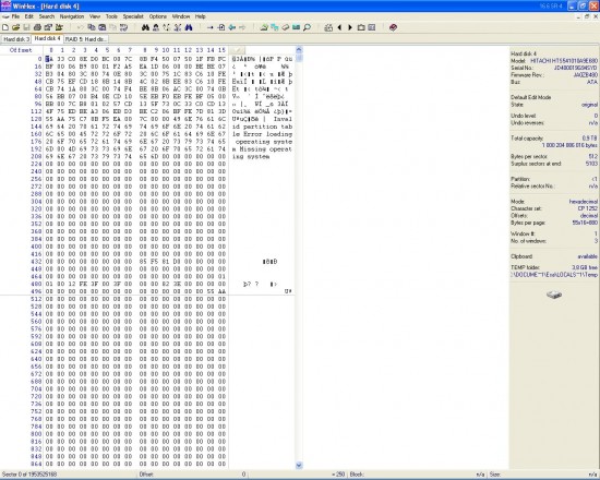

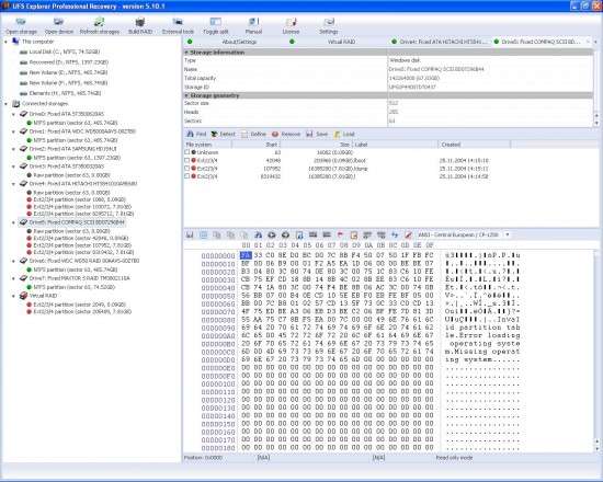

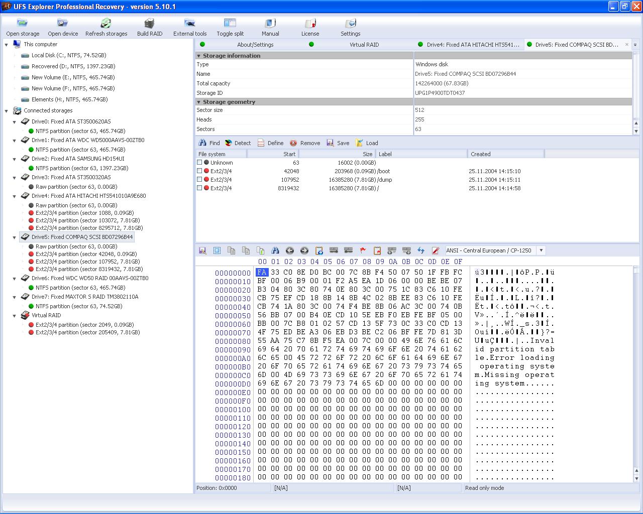

Hopefully I was able to follow your instructions. Here we go:

from Winhex image i see the working drives are Disk3,4
Disk4 is 1TB
from UFS, Disk3 is 500GB,
am i right here? if YES >> then how did you DUMP ?
Compaq disk is SCSI 73gb (as in UFS), where is the other 73gb drive? or HDD DUMP?

ISTM that the Hitachi clone is the only drive whose partition information makes any sense. AFAICT, the two clones appear to constitute a RAID 0 pair. The third member of the RAID must be a parity drive. Does this make sense?
  start     size
     63    16002    MBR -> 0x3e82 = 16002
   1088   203968    1088 + (203968 / 2) = 103072
103072 16385280    103072 + (16385280 / 2) = 8295712
8295712 16385280    8295712 + (16385280 / 2) = 16488352
The 2nd, 3rd and 4th partitions appear to have consistent boundaries, but the first partition appears to be bogus. Wikipedia suggests that a partition ID of 12h is usually associated with bootable FAT service partitions. Perhaps the user wiped the MBR and partition table, and then created the single 12h service partition. In fact the code in sector 0 is a standard Microsoft MS-DOS MBR.

1088 is divisible by 64 (1088 / 64 = 17). Could the stripe size be 32KB?

FWIW, the starting sector of each valid (?) partition is divisible by 32 but not by 64.
