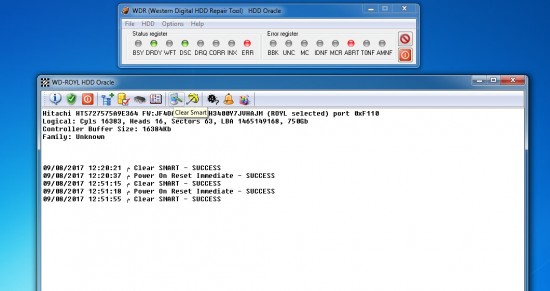

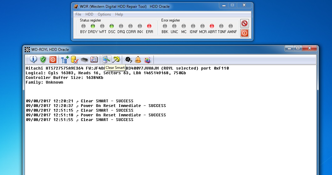

 Post subject: Re: How To Reset/Erase SMART content in WD 500GB HDD
PostPosted: August 9th, 2017, 7:18
Joined: August 8th, 2017, 6:14
Posts: 12
Location: egypt
i did but no result
when i do Clear SMART get
Clear SMART - SUCCESS
But
in the status register Leds
ERR get RED
in the Repair Leds
ABRT get RED
PostPosted: August 9th, 2017, 9:05
Posts: 12
Location: egypt
When make any order give me Error (ERR led lights RED)
PostPosted: August 9th, 2017, 17:16
Posts: 12
Location: egypt
ok Sir, i will Try it with WD 1tb Green and will show you the results
Frankly, i thought WDR will handle Hard disk from Hitachi (as Hitachi became a WD Brand) :D But it's clear that i was Wrong
Now Sir, What program you suggest me to Clear SMART of Hitachi Hard Disk ?
thanks you
