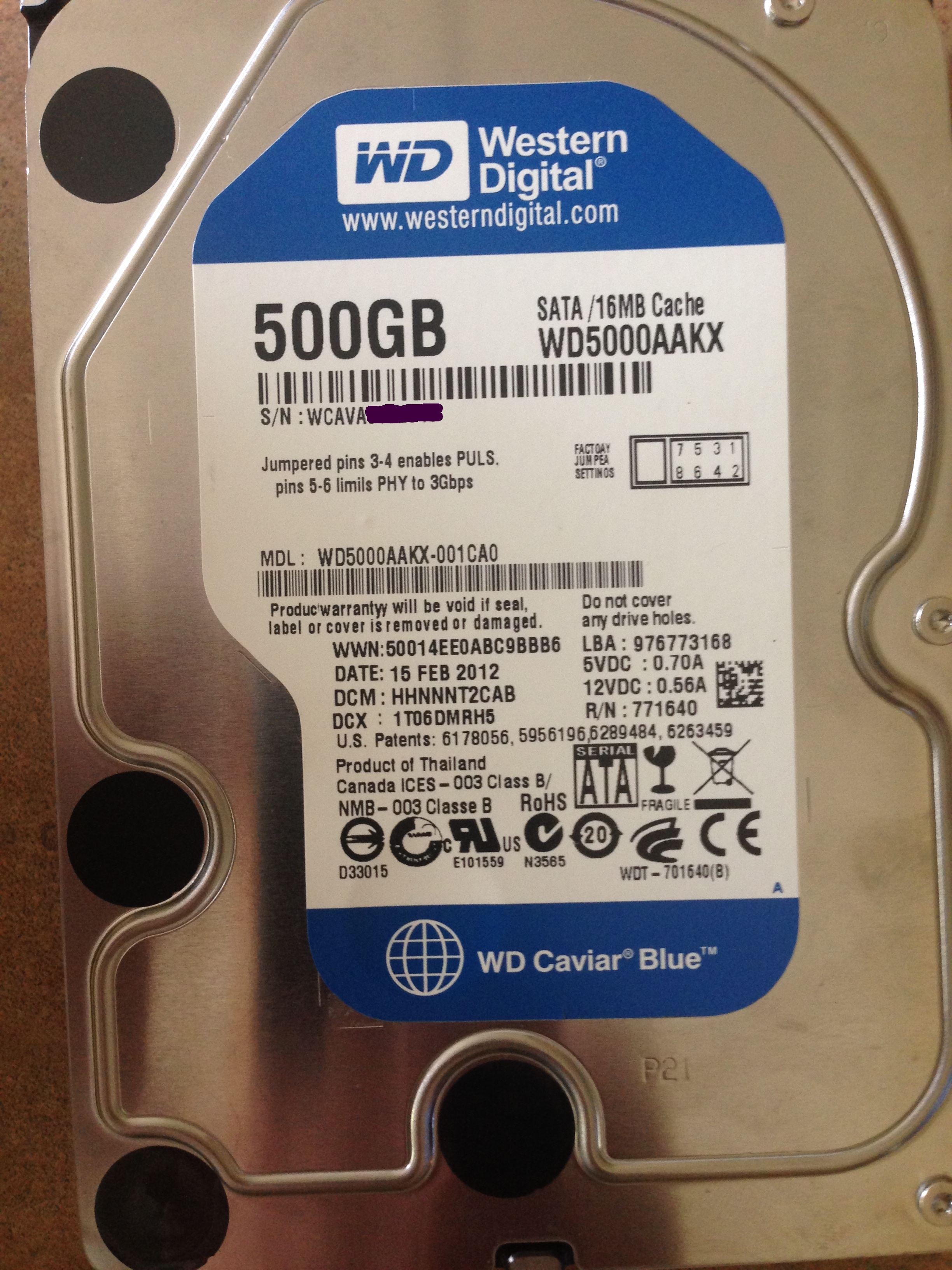

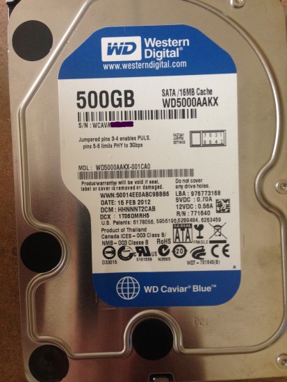

I have a HDD that has 3 different serial numbers, and 2 different models, depending on where you read the data.
It is a WD 500 GB drive.

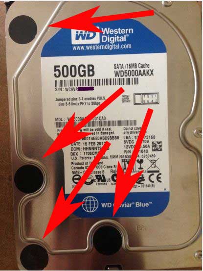

The label on the cover says that it is WD5000AAKX-001CA0 with a serial number of WCAVAXXXXXXX.

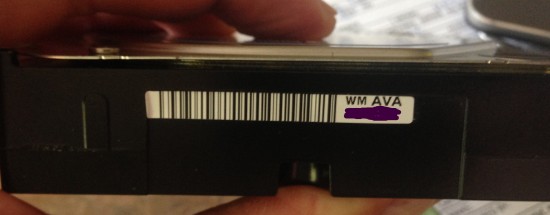

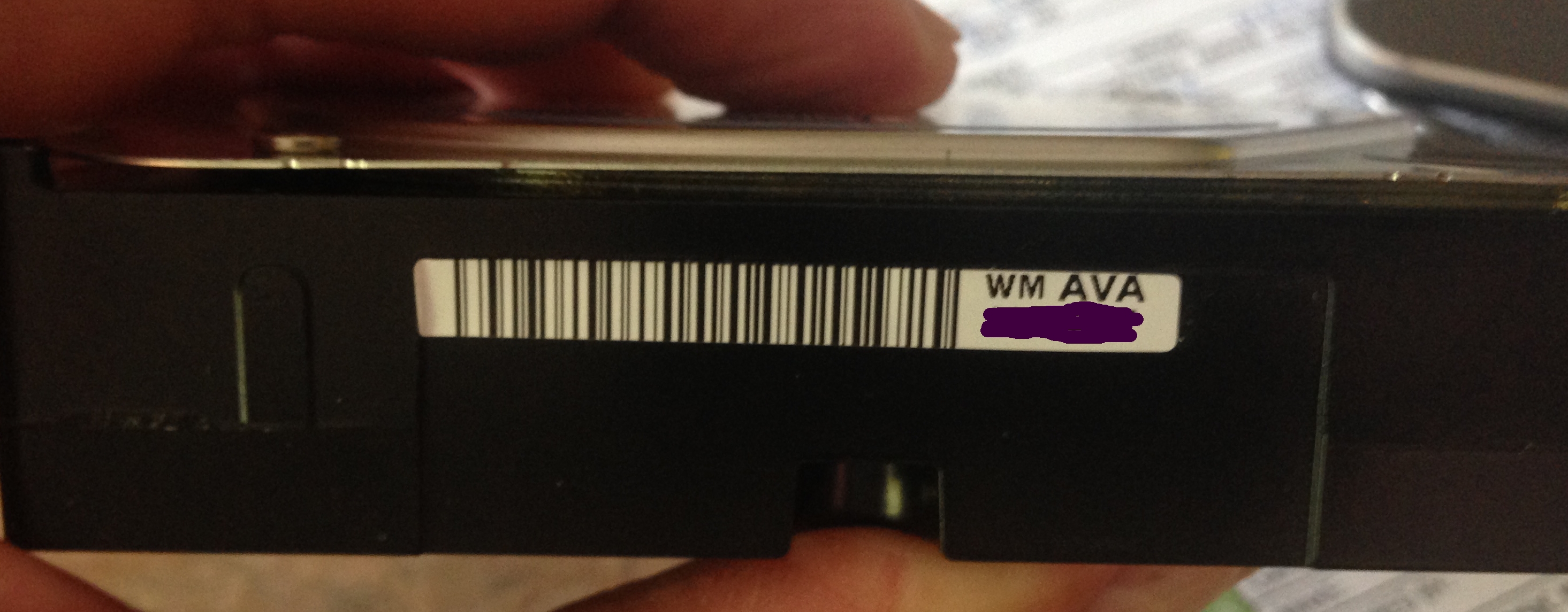

The sticker on the front of the drive says WMAVAXXXXXXX.
hdparm returns a model of WD5000AVVS-63H0B1 and a s/n of WCAUKXXXXXXX. None of the ending numbers are close to being the same.
The drive works, but this is the first time that I have seen anything like this. Would a drive that had been RMA'd come out like this? The drive has stickers over the left side and bottom cover screws that look original as does the label. The screws weren't especially tight as others have been. I don't do DR, but I have opened a few drives to look at the inside, and since things were goofy, I tested them, but didn't remove them.

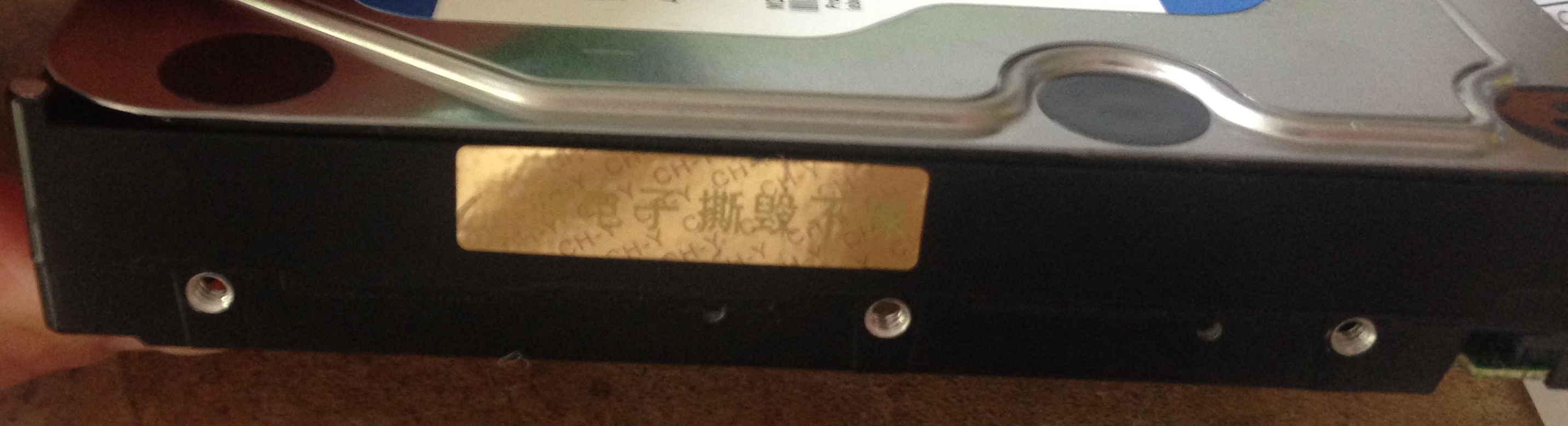

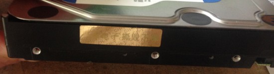

Also, is the "internal" serial number stored in the firmware, is it on the PCB, or is it on the platters? Is this something that somebody hacked together? There is one additional sticker on the side of the drive that is a golden holograph with Chinese writing.

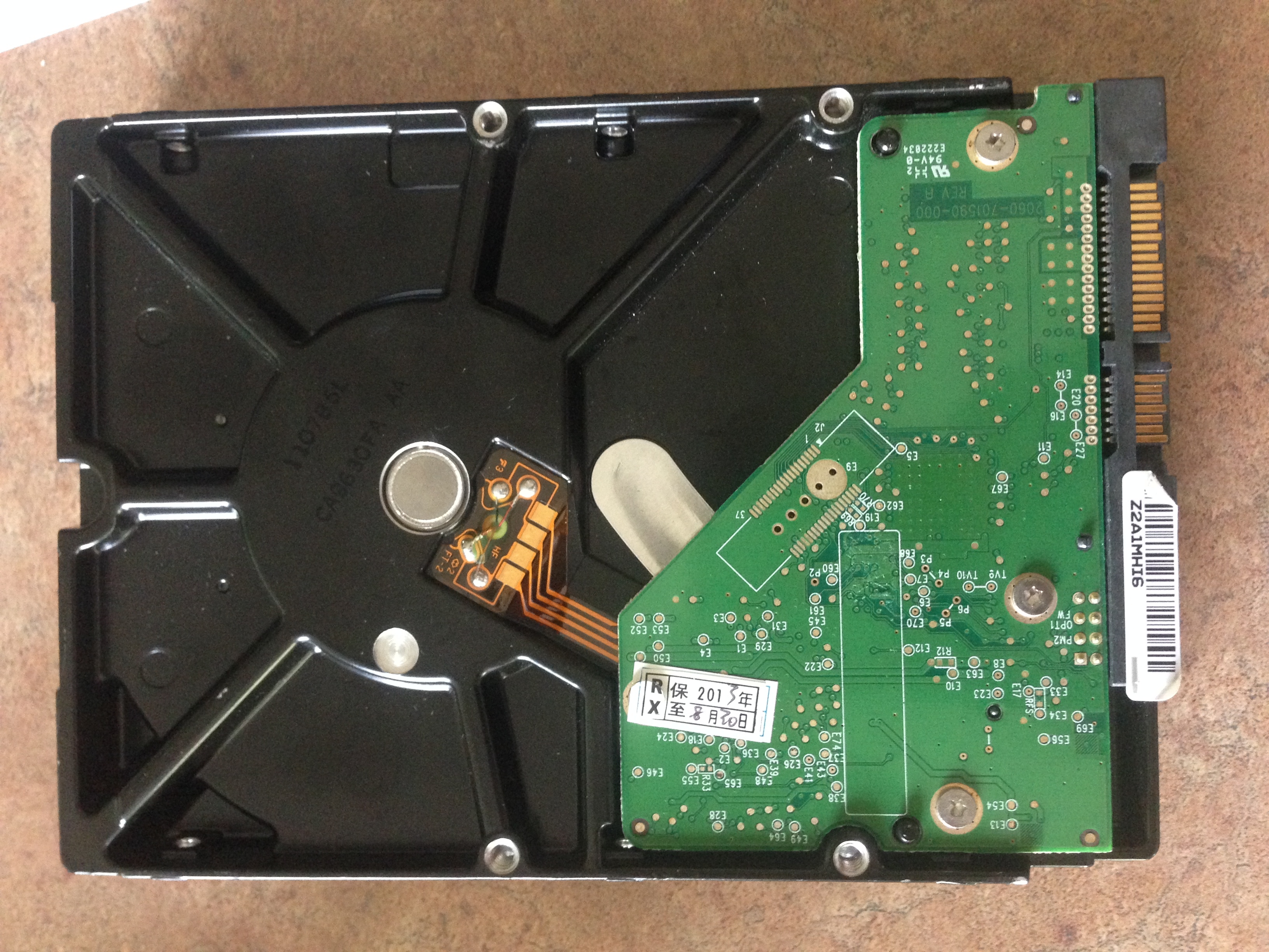

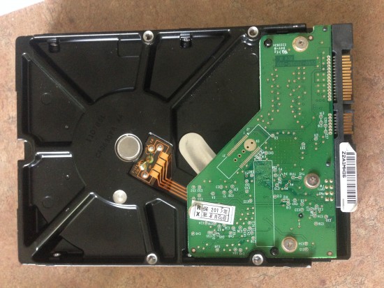

What do you mean by a fake? Changing the label so that you can charge more for the drive? It is a 500GB drive and SMART data shows that it has run for over 2 years, and the drive isn't failing. The customer screwed with the partitions and lost access to some important files with no backup, so I restored the partitions after I cloned it. It was during that process that I noticed the S/N differences.
I'm going to try and upload some photos.
Any idea where the internal S/N is stored?
If there had been a PCB swap, would that change the S/N read by a computer?
Thanks for your help

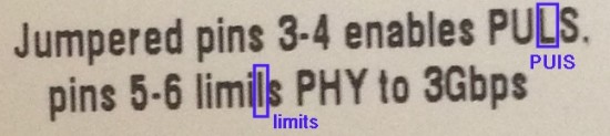

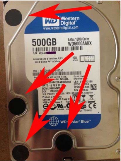

The serial number is stored in module 02 in the System Area on the platters. It may also be stored in module 0D in flash memory on the PCB.
The PCB has a part number "2060-701590-000 REV A". The label has an R/N:771640 and WDT701640(B). Therefore I would have expected that the PCB p/n would be "2060-771640" or "2060-701640".
The model number on the label is "WD5000AAKX-001CA0". The DCX is "1T06DMRH5". AIUI, the DCX would suggest that the model number suffix should be "xxTDHxx" (eg 00TDHB0), not "001CA0".
WD5000AAKX-001CA0 is a 7200RPM drive. WD5000AVVS-63H0B1 is a 5400RPM drive.

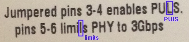

There are several spelling errors on the label.

My guess is that the actual guts are a 160GB AAJS.
 Post subject: Re: HDD has different S/N's, is the S/N on the PCB or platte
PostPosted: May 20th, 2017, 11:49
Posts: 1726
Refurbished GEKKO
PostPosted: May 20th, 2017, 14:30
Definitely fake

That Chinese sticker looks suspect, too. But yeah, fake.
How was the drive purchased?

@Trkyhntr, one more thing you could check is the manufacturing date on the label. The component side of the PCB will have a WWYY date code on the artwork and YYWW/YWW date codes on the ICs (Year/Week). The dates should be reasonably close.
Identifying HDD IC markings - ST313021A case study:
http://www.hddoracle.com/viewtopic.php?f=59&t=207

This unit was in a DVR that quit working (the DVR) that they needed the data from. It was sent to someone who didn't understand DVR's and then they formatted the drive from proprietary to NTFS. I was sent the drive to pull the video from it and put into a format so that it could be viewed.
I pulled 430 GB of raw video from the drive, so it is a 500GB drive. I knew that something was weird with it when I was cloning and imaging the drive, but not until I was reviewing the log files did I catch that the reported s/n was different from the label. That was why I chased the rabbit down this hole.

Seems strange to fake a 500GB drive, with full working capacity.
7200 RPM drives sell for more than 5400 RPM ones.
The OP could verify the actual RPM with Victoria or HD Tune.
