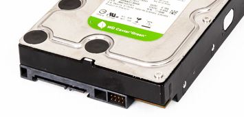

Hi!
I have been googling for some time now but I give up..
Could anyone of you please provide me with input info where to connect Rx, Tx and GND for this device?
Thanks!

Masterclass wrote:
What for I wonder
I would like to troubleshoot it and I'm qurious!

Adisa wrote:
Masterclass wrote:
What for I wonder
AIUI the only functions available via the UART port are reading and writing the flash memory in BOOT ROM mode (via XMODEM), and reading and writing RAM or I/O ports via the Tiny Console. I have written a simple ZOC script to read/write memory via the Tiny Console while "Severence" has written a nice Windows based tool for the same purpose.
http://www.hddoracle.com/viewtopic.php?t=1983
How to work with Boot ROM mode (COM port) in WD utility. Terminal connection:
http://ts.acelaboratory.com/index.php?/Knowledgebase/Article/View/34/0/how-to-work-with-boot-rom-mode-com-port-in-wd-utility-terminal-connection
How to make a com-port connection with WD USB drive:
http://forum.acelaboratory.com/viewtopic.php?f=155&t=7397&start=30
Boot ROM Mode - Schematics For 2.5" SATA Interface:
http://forum.acelaboratory.com/viewtopic.php?f=156&t=8857

Fzakbar is correct and the drive supports ata over terminal. So you can do most of what you can do in terminal as long as you understand the command structures.
