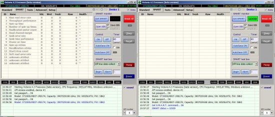

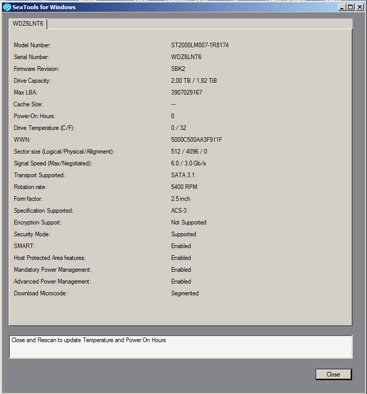

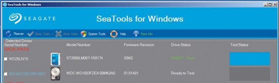

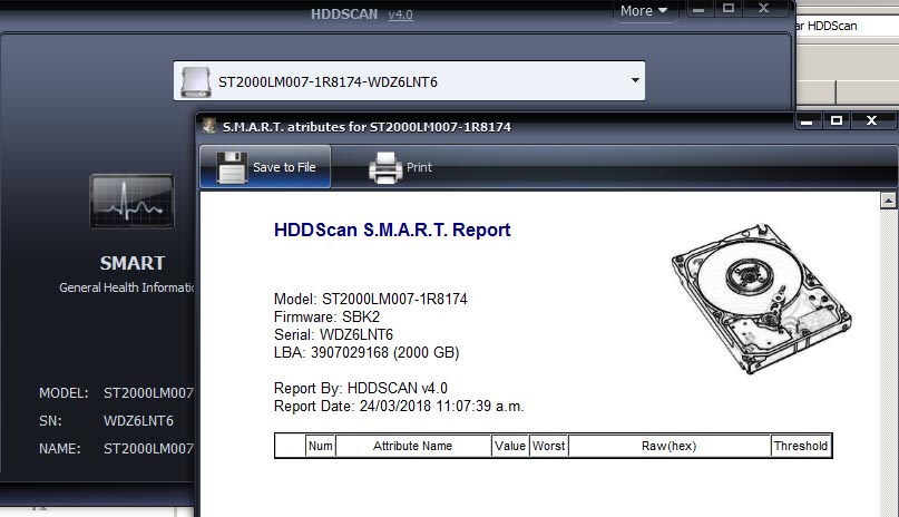

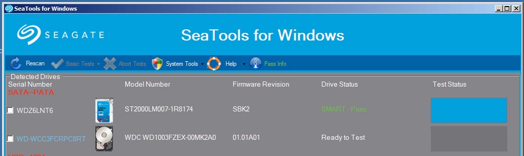

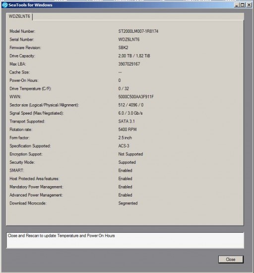

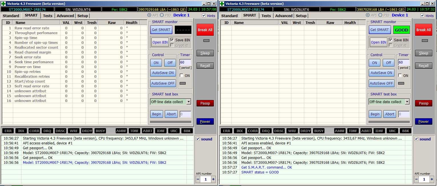

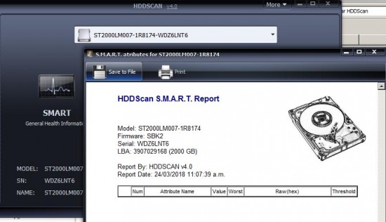

Thanks for your responses, I did a SMART scan using SeaTools, Victoria and HDDSCAN
I heard about avoiding SpinRite, but I didn´t knew HDDregenerator was on the same list.

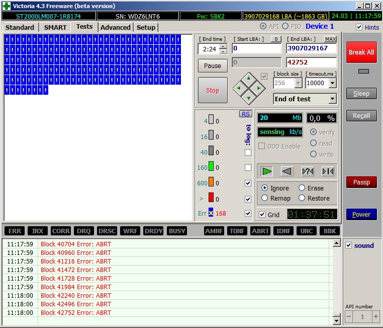

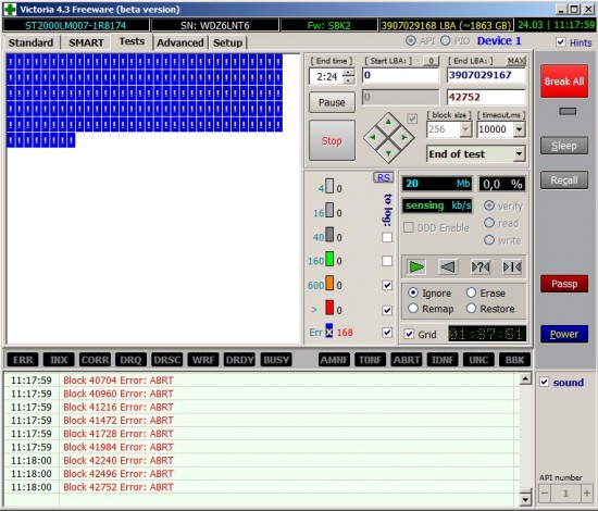

I Did the VERIFY test on Victoria, I get Block ******** Error: ABRT ,scanning at the start and at the ending.
I Don´t have a TTL adaptor
About paying for Data Recovery service, how messed up the economy is in my country, paying for the service is almost impossible.
File comment: In Victoria I only get a GOOD after the scan, but doesnt show any useful data, If I scan my main WD I get all the useful info
File comment: I Don´t know is this information is useful, comes from SeaTools
File comment: In SeaTools I only get a thumbs up
File comment: In HDD Scan I don´t receive any data

Getting all BLUE blocks in Victoria means that the HDD is dead? even when the SMART says is ok?
 Post subject: Re: Too many delays detected during HDD regenerator Scan
PostPosted: March 27th, 2018, 2:48
It is not completely dead, yet. But the firmware has a lot of problems, as it can't read user data area. Maybe, mechanical problem as well.
Need help by a specialist at this point, sorry.
