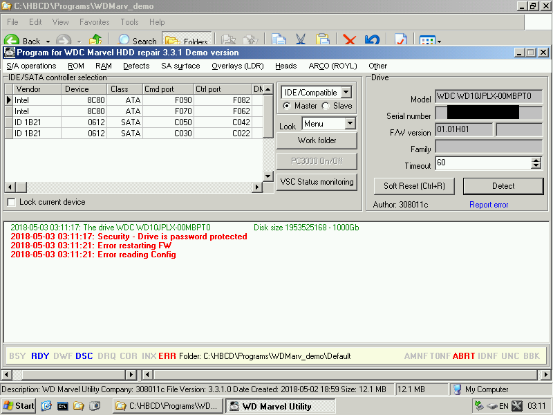

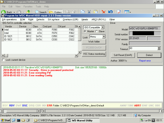

I was trying to perform an ATA secure erase on one of my hard drives (like I have many times before), and something went wrong. I normally use a live Ubuntu image with hdparm to initiate the secure erase, and I haven't had an issue before.
I'm not sure what happened this time, but the drive is locked and I cannot seem to unlock it. I know (or thought I knew) the user password for the drive, but all attempts to disable the security with:
hdparm --user-master u --security-disable 1234Pass /dev/sda
fail with a 'SG_IO: bad/missing sense data'.
I've read viewtopic.php?f=1&t=8374 and followed the guide linked in the post made on February 16th, 2018: http://www.hddoracle.com/viewtopic.php?f=86&t=2353
I get some errors when trying to remove the password with WDC Marvel 3.3.1 (Demo) in a Mini Windows Xp running from a Hiren’s BootCD:
I'm not really sure what to do at this point. I was trying to secure erase the drive so I don't care about the data on it, I would just like to have a usable drive again.
 Post subject: Re: Unable to unlock WD10JPLX
PostPosted: May 3rd, 2018, 4:05
Joined: May 30th, 2005, 17:07
Posts: 546
WD10JPLX-00MBPT0 it's Hitachi drive and you need to use Hitachi tools

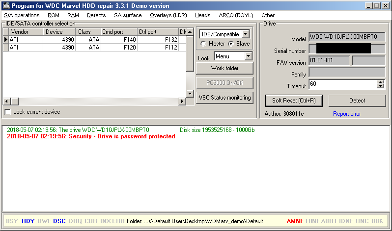

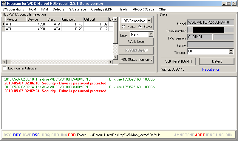

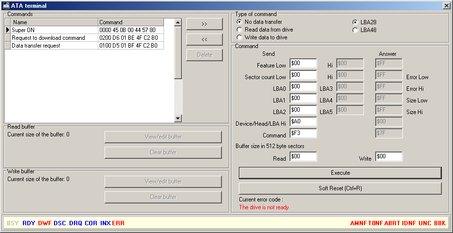

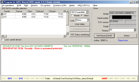

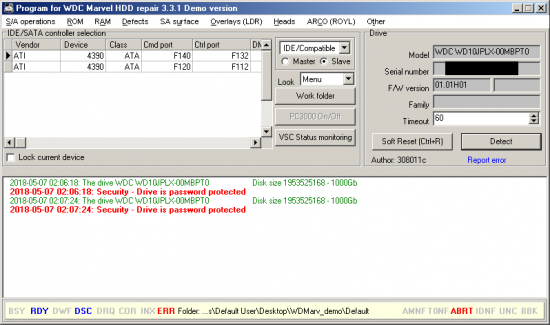

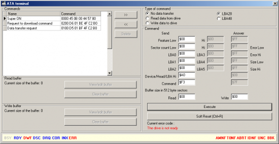

PostPosted: May 6th, 2018, 22:30
Joined: May 2nd, 2018, 23:20
Posts: 10
I attempted to run the prepare, but kept getting "The drive is not ready".
Here are the steps I took:
1. Find the drive
2. Reset the drive with "Soft Reset" to clear any expired password attempts
3. Attempt to send the security erase prepare command
It seems strange to me that the prepare failed.
