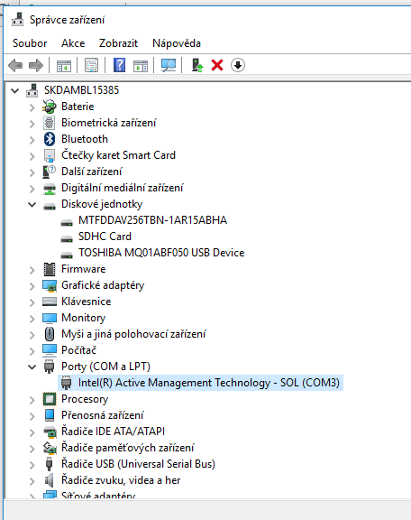

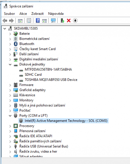

yeah, I have tried, but i think that a I have still adapter which is useable just for end-users who would like to plug-and-see in This PC (in fact useable just for working hdd)
I have Axagon ADID-70 USB 2.0 - SATA/IDE, but it is still adapter - no diagnostic port or terminal. Let's have a look on device manager on pic attached.
Could you recommend some terminal / diagnostic port? I would like to buy one to try.
I have check something like this, that means that i have to connect PIN correctly, on the other hand that is useable for all HDD manufacturer? (Maxtor, Western Digital, Seagate..?)
Link
Is this what I need, or any other converter is required?
Thank you,
Jiri
File comment: Adapter, but not terminal
