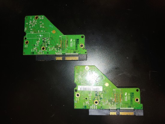

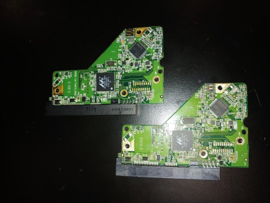

It is a bad board, already confirmed and have a donor. The question is in the fact there is no U12. My understanding is that means its in mcu. Only hardware we have here is a deepspar so... How do I approach this? Board is 2060-701537-003 rev a
File comment: Original on top

You Need a Tool To Regenerate The ROM For The Patient And You Are done .If your deepspar is no good then buy a good firmware tool ,PC 3000 UDMA And MRT/DFL are good tools .There are many software based solutions also that i do not use but my buddy spildit etc use ,Might be he can help you with this
