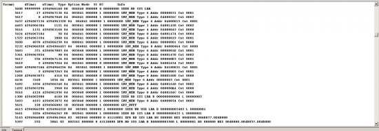

For entire week we are struggling with one refurbished seagate Pharoh family disk (7200.12 /320gb)
It gets detected normally with different model /sn/fw no. and tends to be busy all the time (refurbed model name).
Translator recovery is not been able to possible despite all efforts.
Can someone pls.guide , I can give remote access to UDMA-E , refurbed drives are not fully supported by utility.

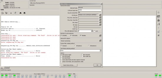

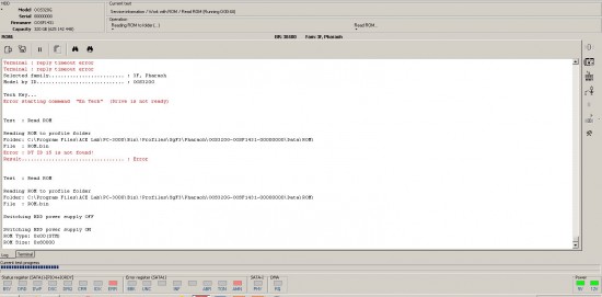

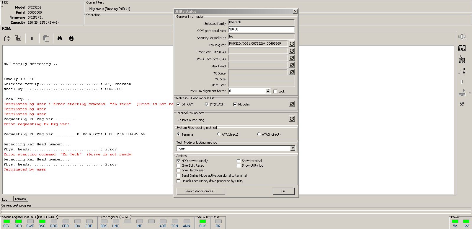

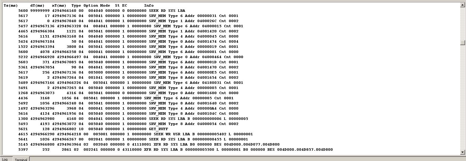

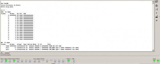

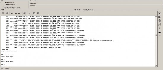

 Post subject: Re: Seagate 7200.12 refurbished recovery
PostPosted: August 19th, 2019, 2:39
Posts: 196

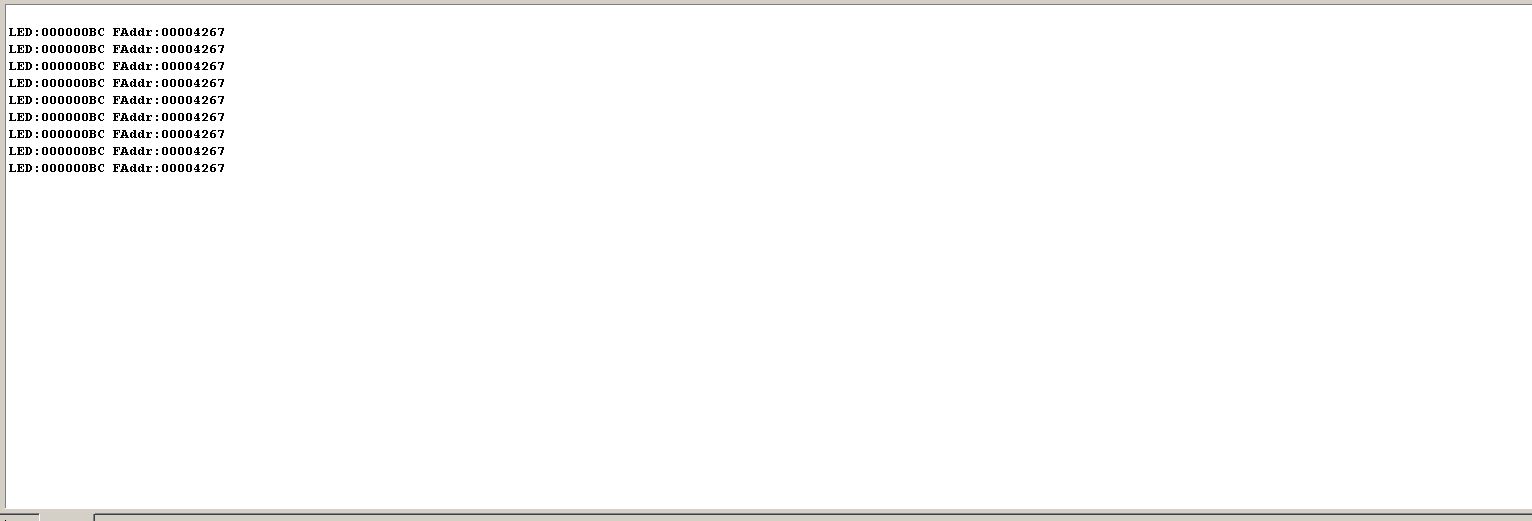

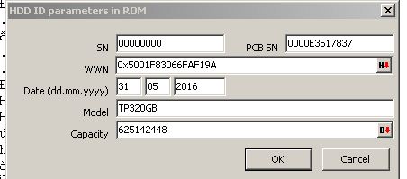

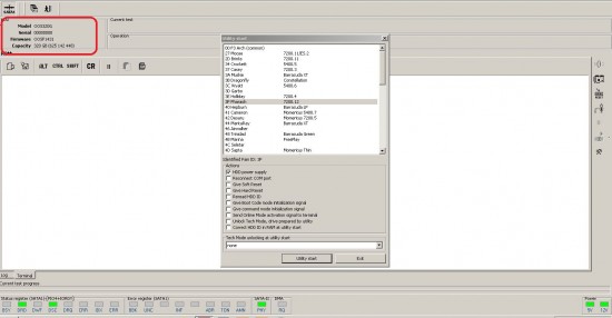

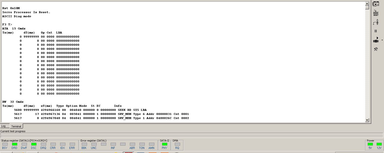

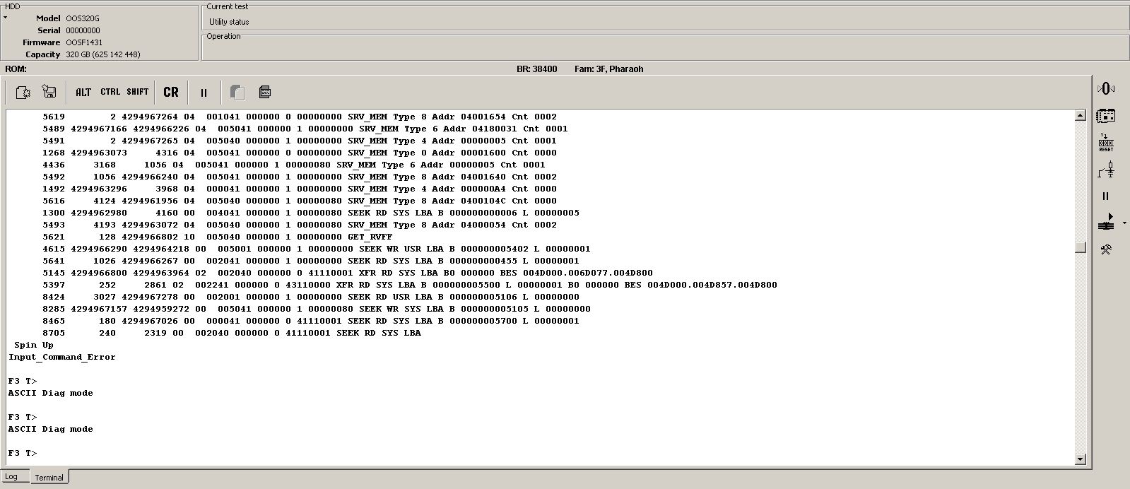

hi
terminal get locked & is not responding to read channel short procedure.
it shows following briefly ----

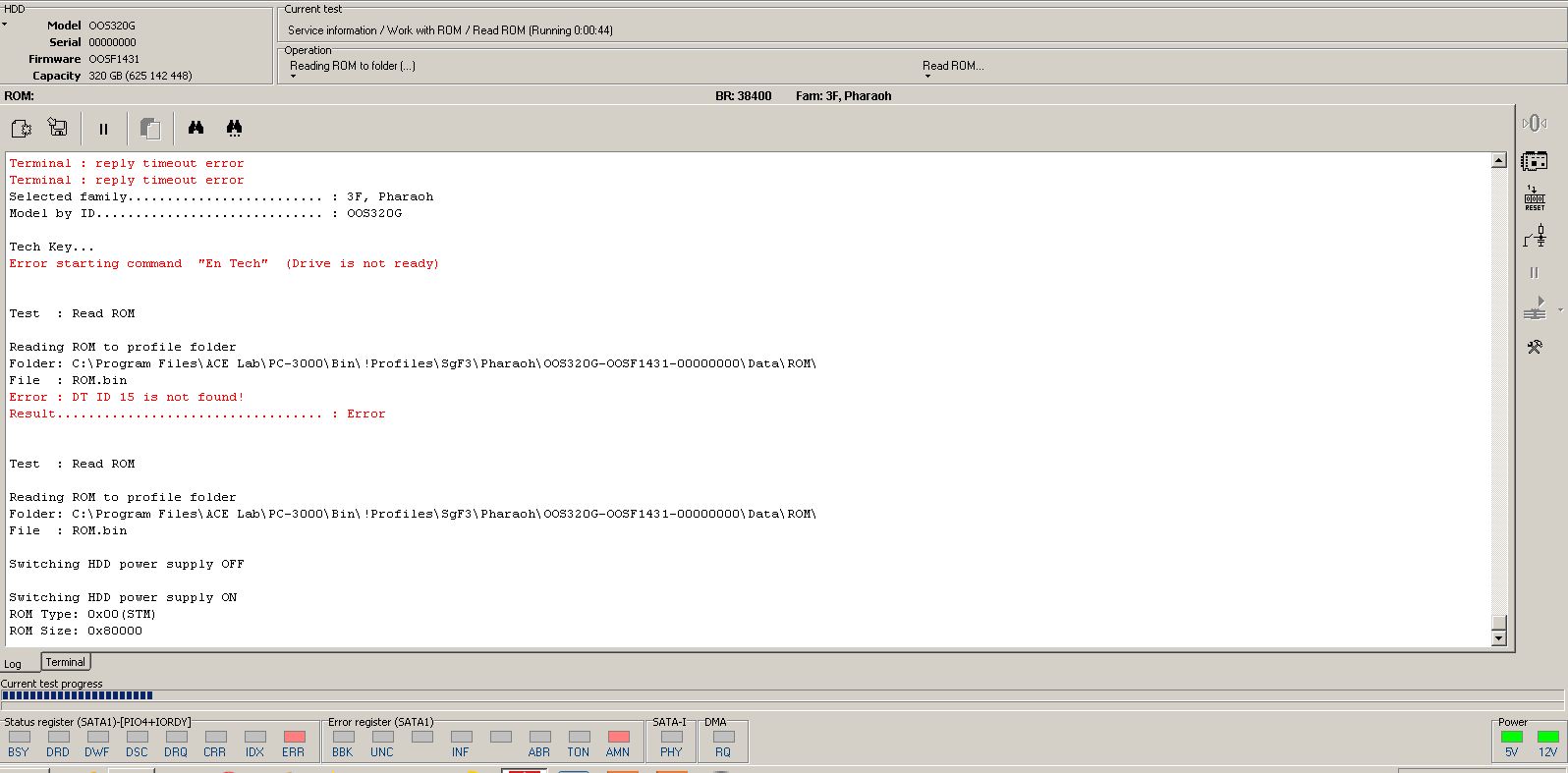

Unfortunately I have done procedure you have described , however heads seems to be in working condition though I cant check resistance .
I am attaching ROM for further reference.

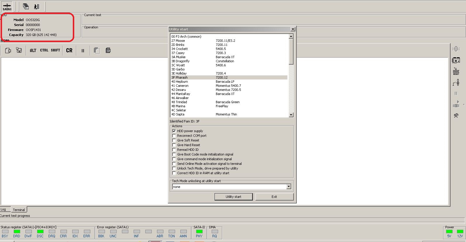

PostPosted: August 20th, 2019, 1:31
Posts: 196
disk is giving led error now.
here is ROM.
ROM.rar [437.19 KiB]
Downloaded 913 times

Try to start with this ROM:
https://yadi.sk/d/_wyNTF05AiX_Ng
PostPosted: August 20th, 2019, 3:23
Posts: 196
WO you are great E123 :good: , I just wrote your rom and now can read SA like normal hard disk. I have got full sector access & getting good imaging speed (heads are ok). But fight is not over yet , I am not able to read MFT's of any partition and getting read errors.
Further work on defect list / translator might be needed.
Thanks a ton for all the help. I will be in touch with you on PM. :D
PostPosted: August 20th, 2019, 5:06
Posts: 196
With precise rom from E123 ,this case has been declared 100% solved. I have established full access to data .
Thanks E123. :D

terminator2, Nothing special. Adaptives from refarbed flash I placed in a flash from the stock CC49.
