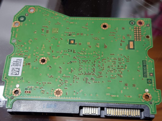

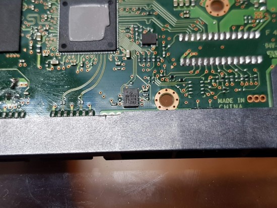

Hi all,

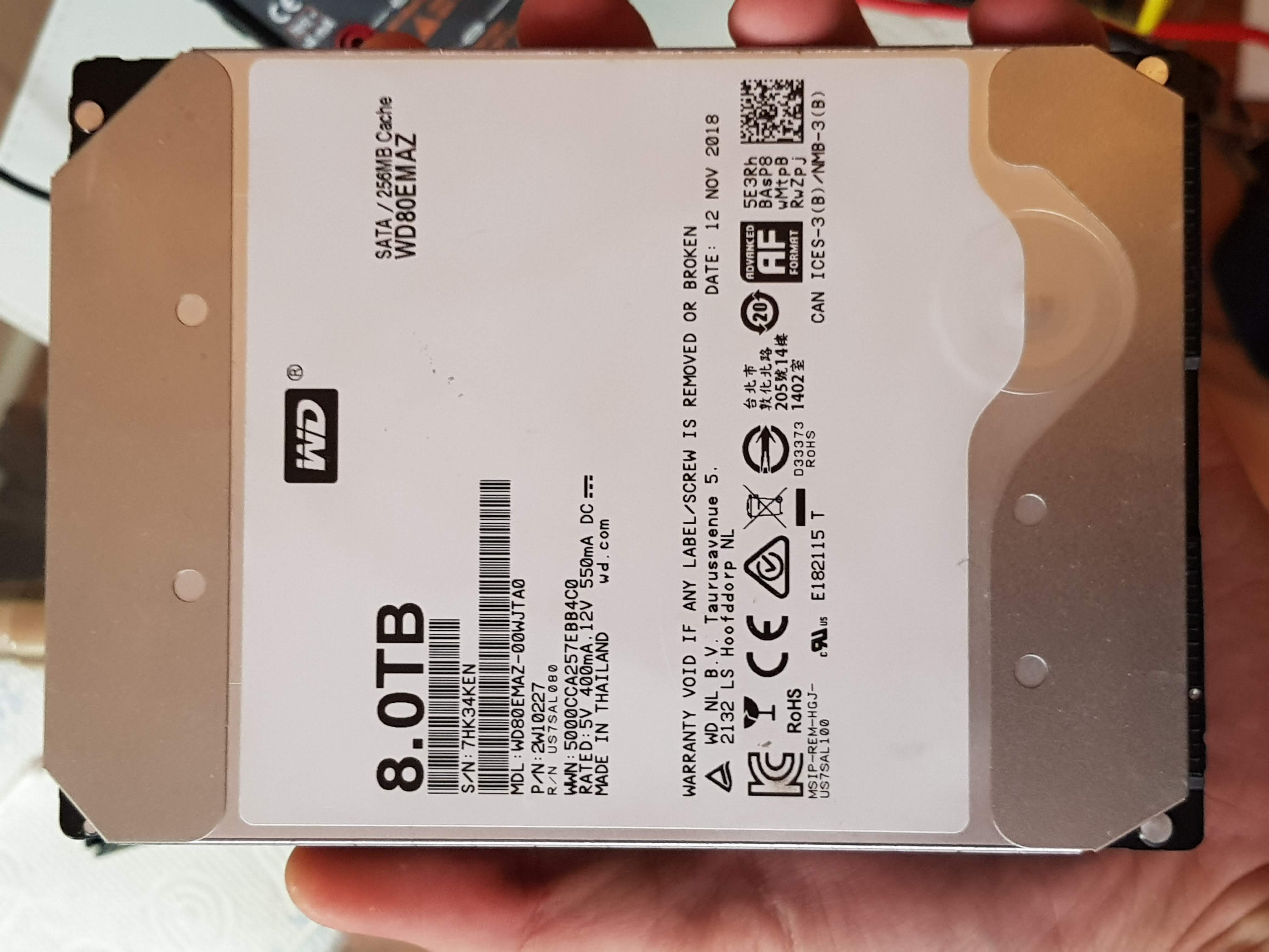

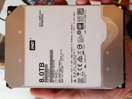

I have a problem with my WD Red White Labelled (WD80EMAZ).
I plugged in the Hard Disk to a Running PC and then the Disk did not start up anymore.
It is a White Labelled so there is something with the 3,3v pin.
I tried to desolder some Stuff on the Sata Power Connector but it did not work out. So I ordered a second HDD. It is the same HDD.

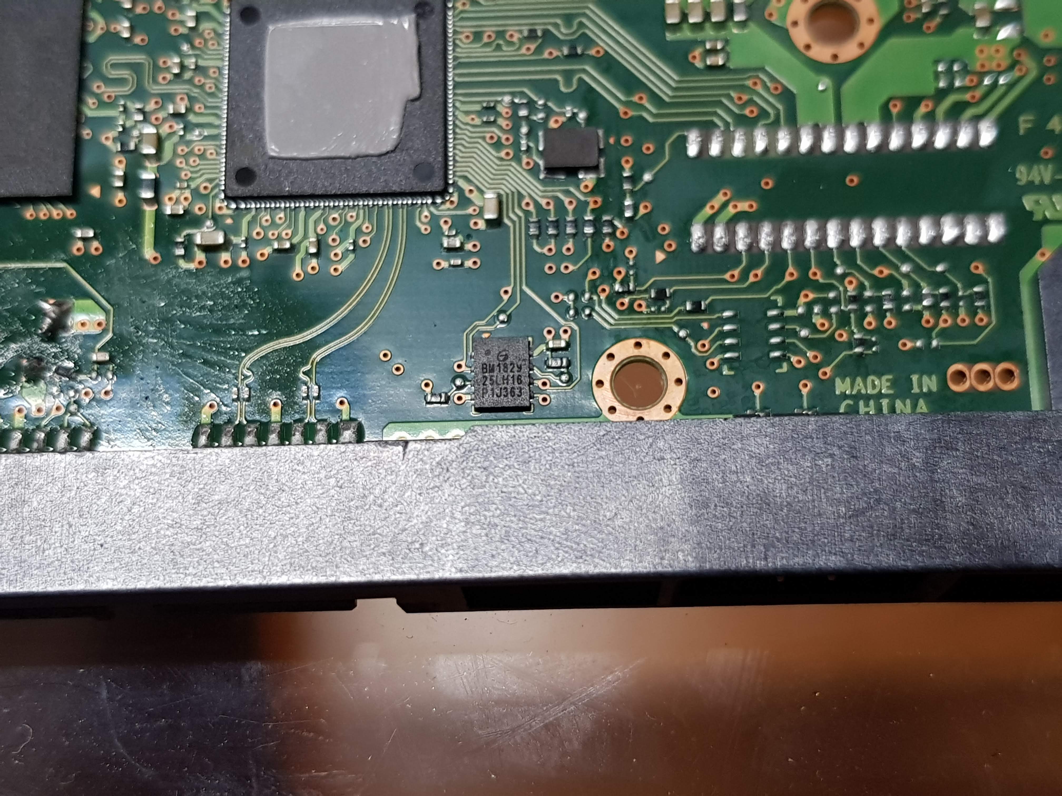

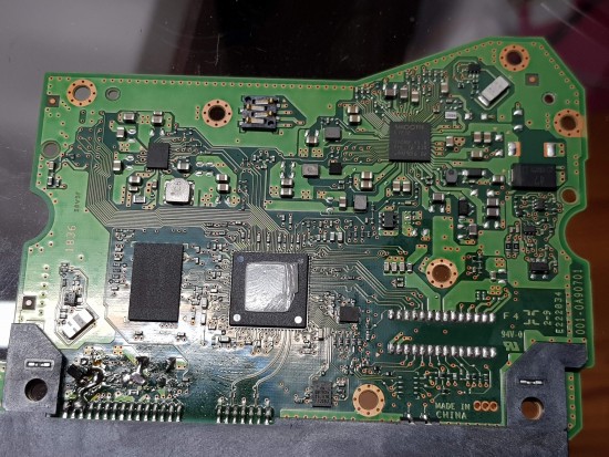

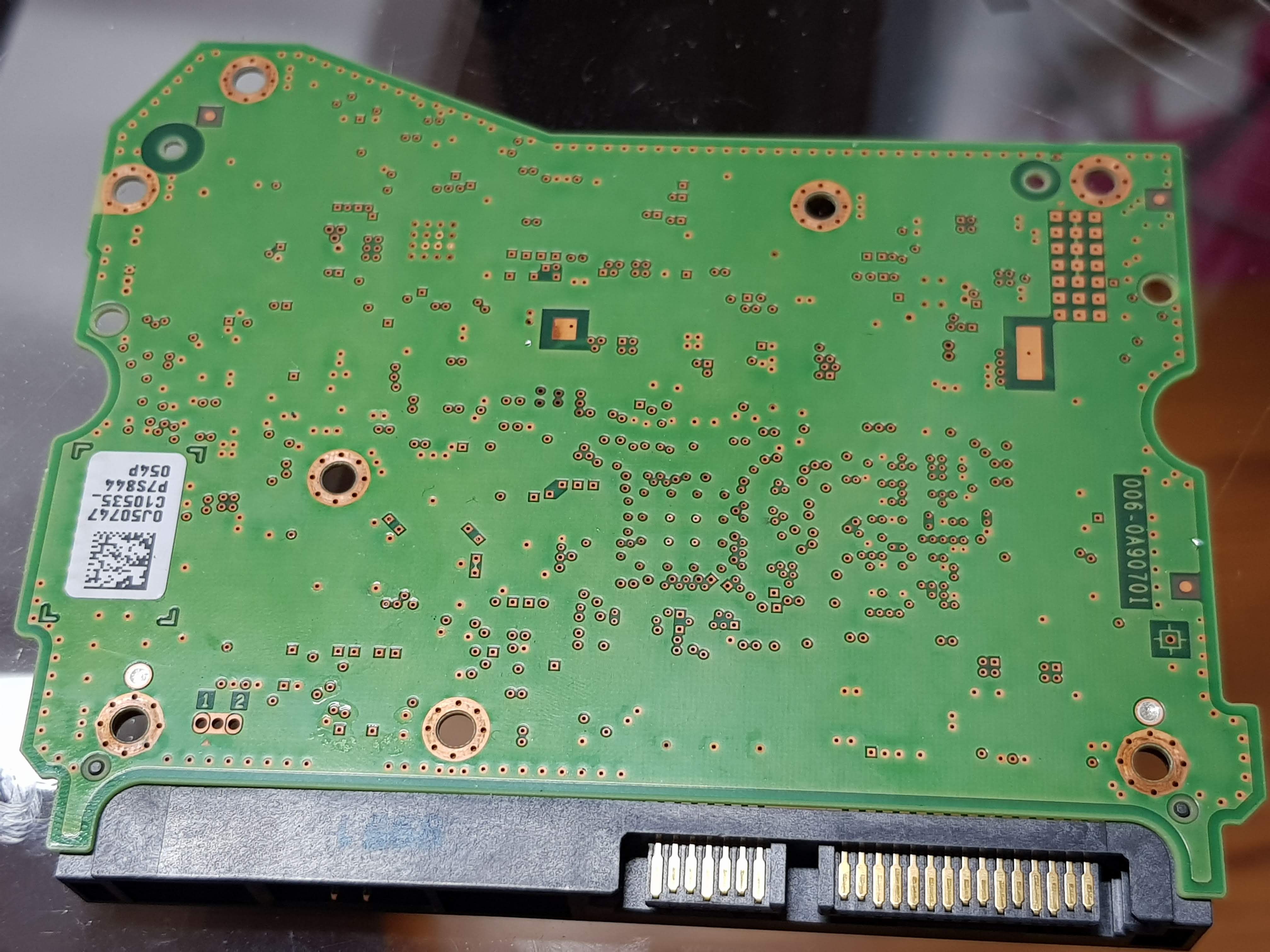

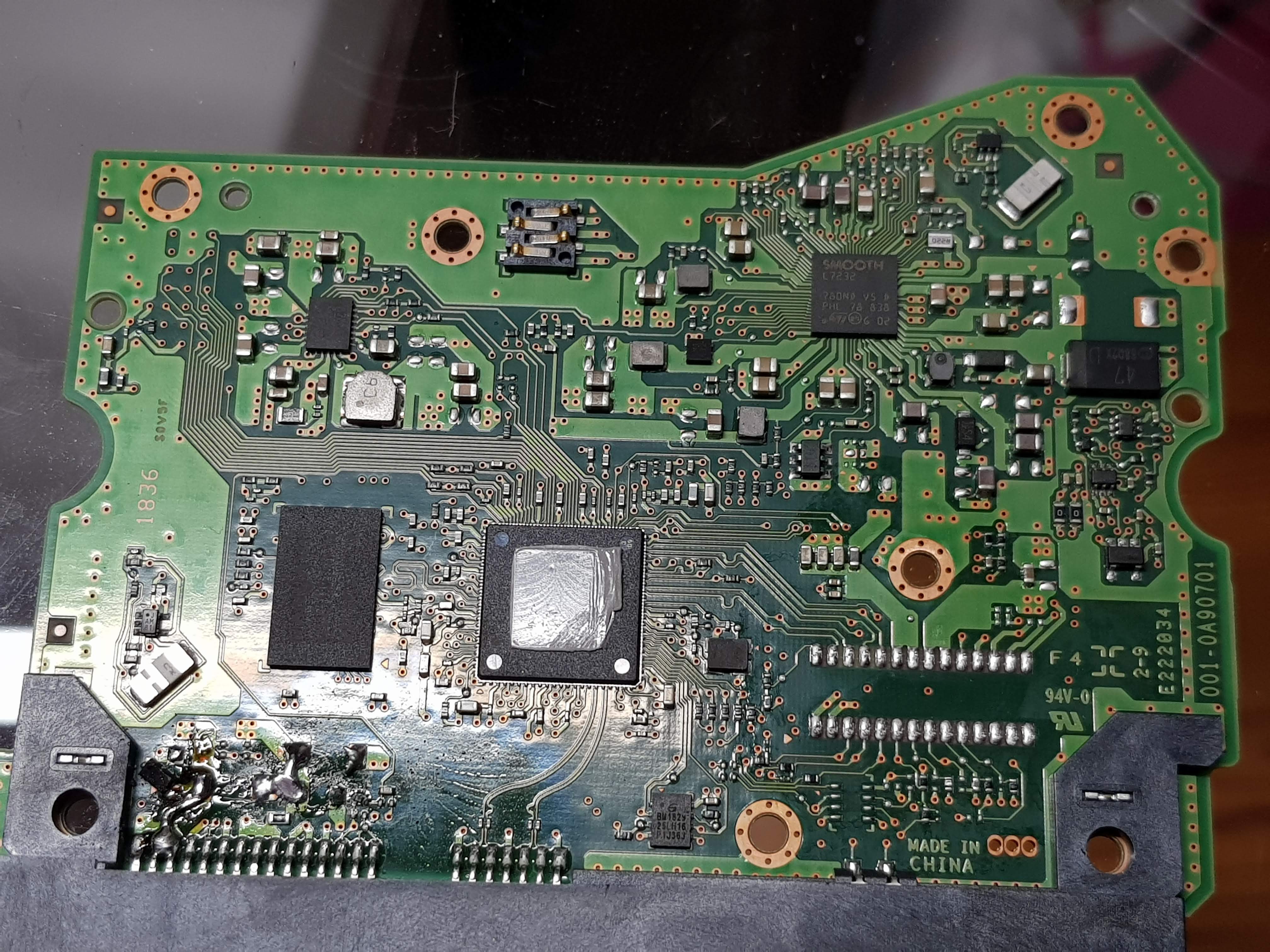

I want to swap the BIOS now that the Index is not gone.
The problem is that I and some other people do not know for sure what the BIOS is on this Model.
You can see on the Screenshot the PCB.
I hope someone can say what the BIOS is that I can try out to swap it.
If you have some other Idea how spin up the disk again i open.

The "BIOS" chip is the one marked "25LH16".
GD25LH16WIG, GigaDevice, 16Mbit, 1.8V, SPI flash memory, QFN-8:
http://www.gigadevice.com/datasheet/gd25lh16c/
Datasheet database for HDDs and SSDs:
http://www.users.on.net/~fzabkar/Datasheets/DATAURLS.HTM
Does the second HDD spin up from the same SATA power cable? Have you measured the voltages at the SATA power cable?
SATA power pin #3 is a Power Disable pin. If it is wired to 3.3V, then the drive will remain powered off.
BTW, your drive is a rebadged HGST helium model.
