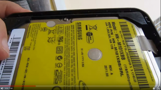

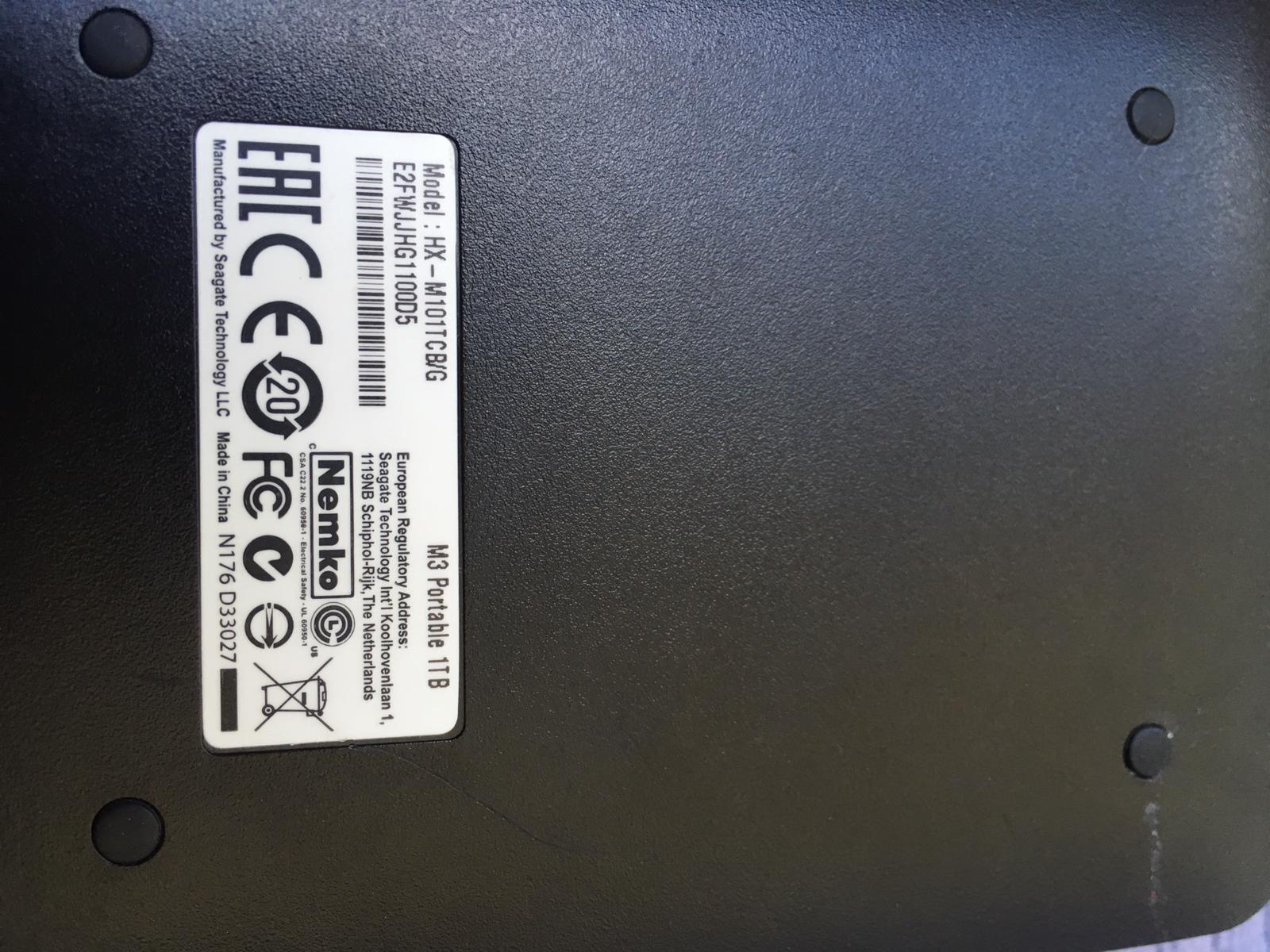

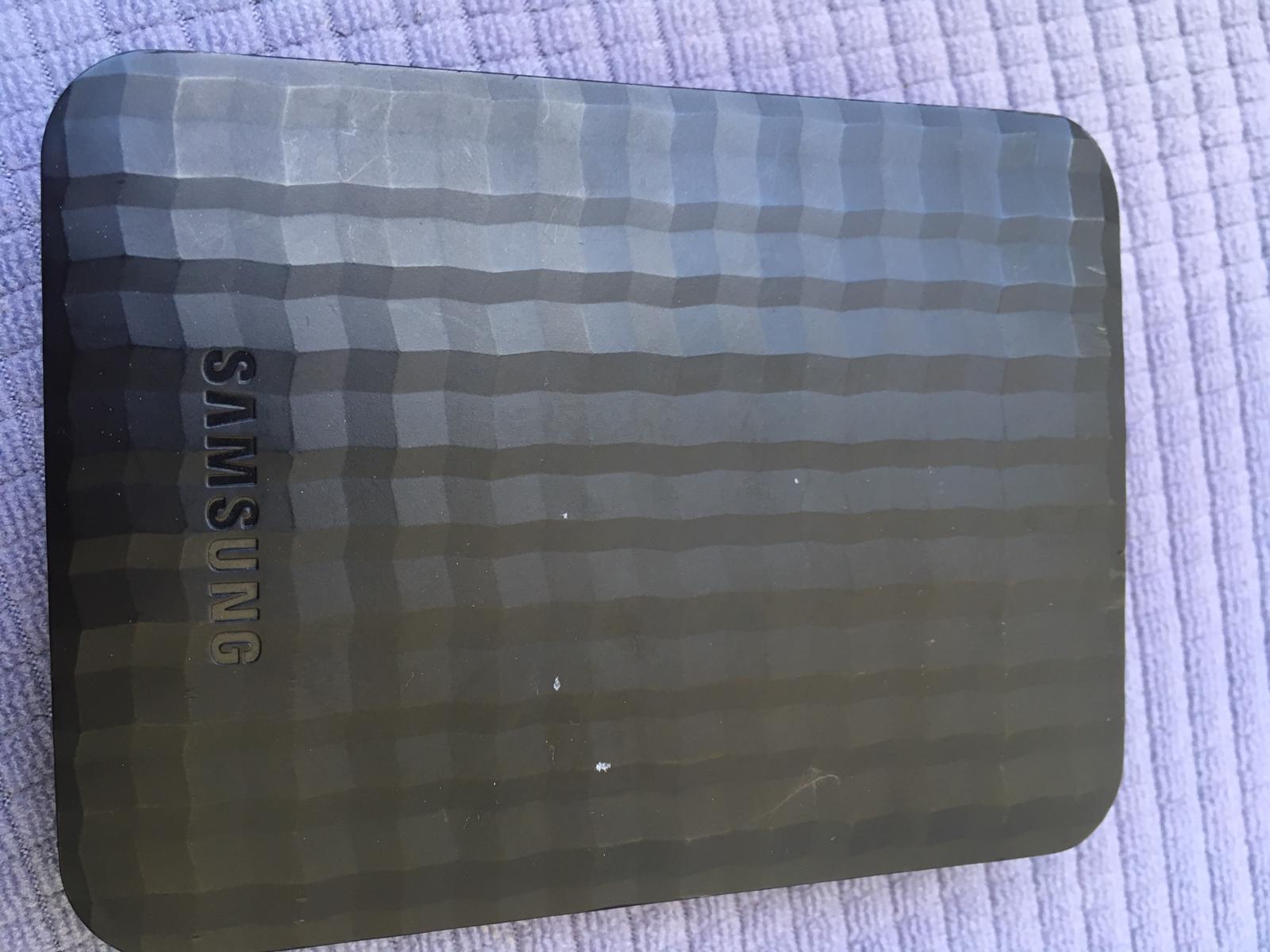

I need advice for donor match
HN-M101XBB\SRL
What do you think about HN-M101ABB ?
(I would try I guess)

Any M8 from your "hdddonormarket.com" with matching preamp.

Drive would come tomorrow in my hand. Tomorrow I would check hdd . I have more different FW /preamp versions M8

M8 has 3 kinds with PCB numbers ending with : 03, 06 and 07.
Matching donor would be easy.
Good luck
