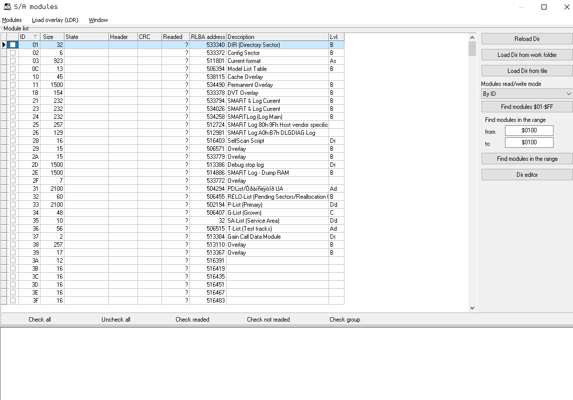

Hello guys! I have a 6TB WD Red HDD that shows only heads 0 and 1 as active, for a total of 1.2TB at 1/5th of the Cylinders available. What would be the safe procedure to enable back some of the heads, resize it, and test if any could still be used? I already have a license of WD Marvel BTW 8) . There is no data to be recovered on the drive, so no worries there :P ! Thanks guys!

Can you upload the drive's ROM and SA resources?

You mean like this? Thanks, btw :D
File comment: ROM - Read ROM
Flash.zip [272.74 KiB]
Downloaded 903 times

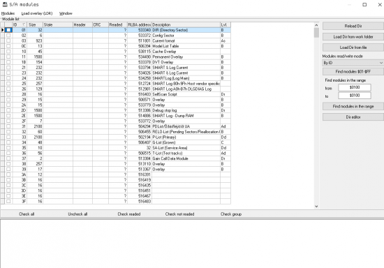

File comment: SA Modules Operations Screenshot

That's the ROM. Show us the rest of the firmware.

Ah right, I should have posted that earlier :oops: . There's a lot of data here, and it's where I learned of the physical/used head count.

Analysing flash.bin ...

Active directory is 0x0B
Analysing active 0x0A module ...
Head map checksum (Expected / Actual) = 0x0000 / 0x0000 - OK
Number of heads (physical / in use) = 10/2
Head map #1 = 0x0003 / 0b0000000000000011    <---------------
Head map #2 = 0x03FF / 0b0000001111111111    <---------------

Head/Media DCM = JX
