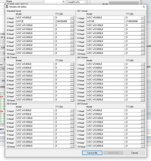

Does your drive is in the same situation as flowersun, with only head 0 and 1 enabled?
Show us a screen of your head map from WDMarvel, and also one for your model list.

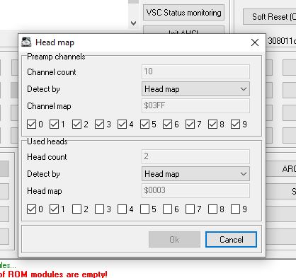

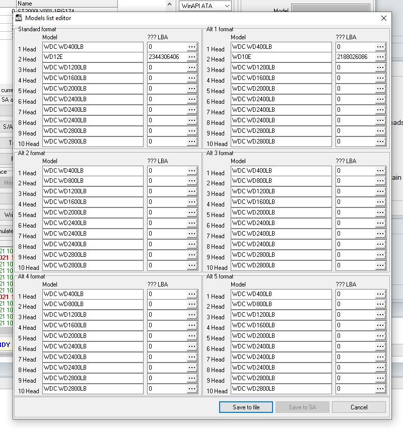

Do the screens there:
- Heads > Edit head map in ID0A
- SA Operation > Model list editor
Drives have physical and virtual head number, the head map will show your physical heads, there is a chance that enabling other heads will works if your actual enabled physical heads are 0 and 1.
BUT! It seems that many infos about others heads were removed! I don't know if there are not there because of the trim, but I doubt of it...
I suggest you waiting for the fzabkar report, in the flowersun thread.
BTW, those drives stories seems little strange, because you usually get one defective head, or eventually another, but all others seems strange. Like it's not sure if they even contain the others platters. (maybe try weight/compare them)

This is what I got when I ran his WD flash analysis program:

Analysing active 0x0A module ...
Head map checksum (Expected / Actual) = 0x0000 / 0x0000 - OK
Number of heads (physical / in use) = 10/2
Head map #1 = 0x0003 / 0b0000000000000011
Head map #2 = 0x03FF / 0b0000001111111111

Re-enabling others heads will surely works as I have said, but previously you have to re-define all the values that were removed from the model list editor. (take example on another full firmware for this drive, module 0C)
Then you will surely end up with a non functional drive because many "adaptives" values about others heads are missing. (re-disable those heads to go back to your initial situation)
flowersun have to ask in the WDMarvel forum for the ARCO steps procedure to re-init those values. (we see strange "Preamp values" and "Microjogs", but strange Microjogs H0&1 are 0000... this drive is largely higher than my knowledge capacity, so I can't help you more with safety, sorry...)
