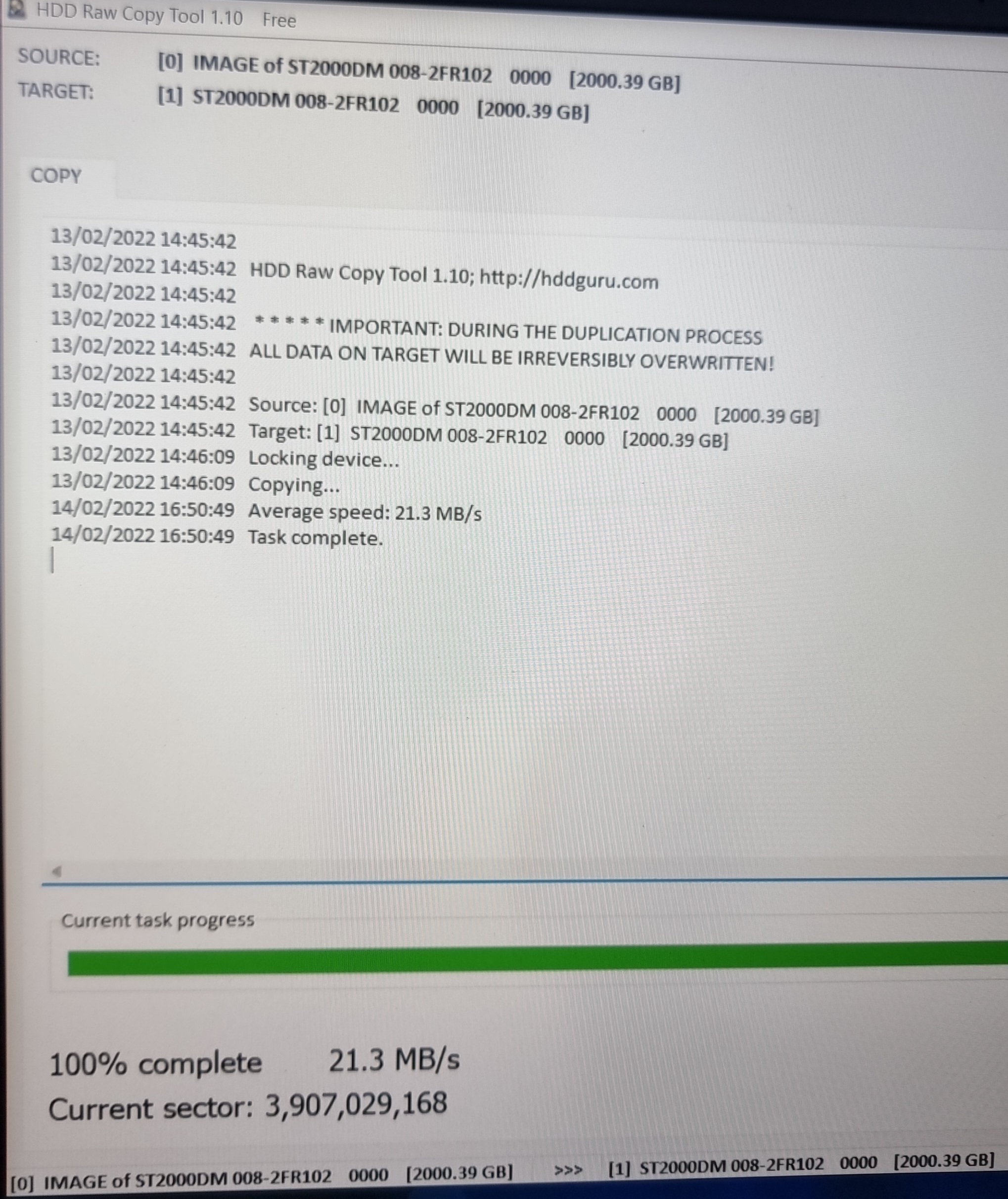

I'm trying to copy a 2TB image (.imgc) to a 2TB 3.5" HDD. Same model hard drive as image was taken from. My write speed starts at 50.0MB/s but slowly and gradually reduces. 3 hours in and it's now at 24.4MB/s. This is the third time trying to write this image. Any help?
I'm using a FIDECO SG3-PL03 adapter.
Thanks in advanced.

I've added a picture of the screen with details.
Was a 2TB image to a 2TB Seagate Barracuda SATA drive.
Eventually completed 100% after around 26 hours.

Ah I see what you were doing.
AFAIK the free version hddrawcopy is limited to 50mb/s max, so that explains the initial transfer rate. The ST20000DM is SMR which probably caused the drop off in performance.

The slow can also be caused by the source from where you read the image file.
I think this drive can full complete a sectors image copy at the limit of 50mb/s, but it have to also success reading at the right bandwidth, and it is also hardware independent with a right config to the right UDMA speed.

Sorry, I would say hardware dependent, but it's surely not UDMA config story as you start at about 50mb/s.
So I suggest you looking at what is going on with your source drive.
