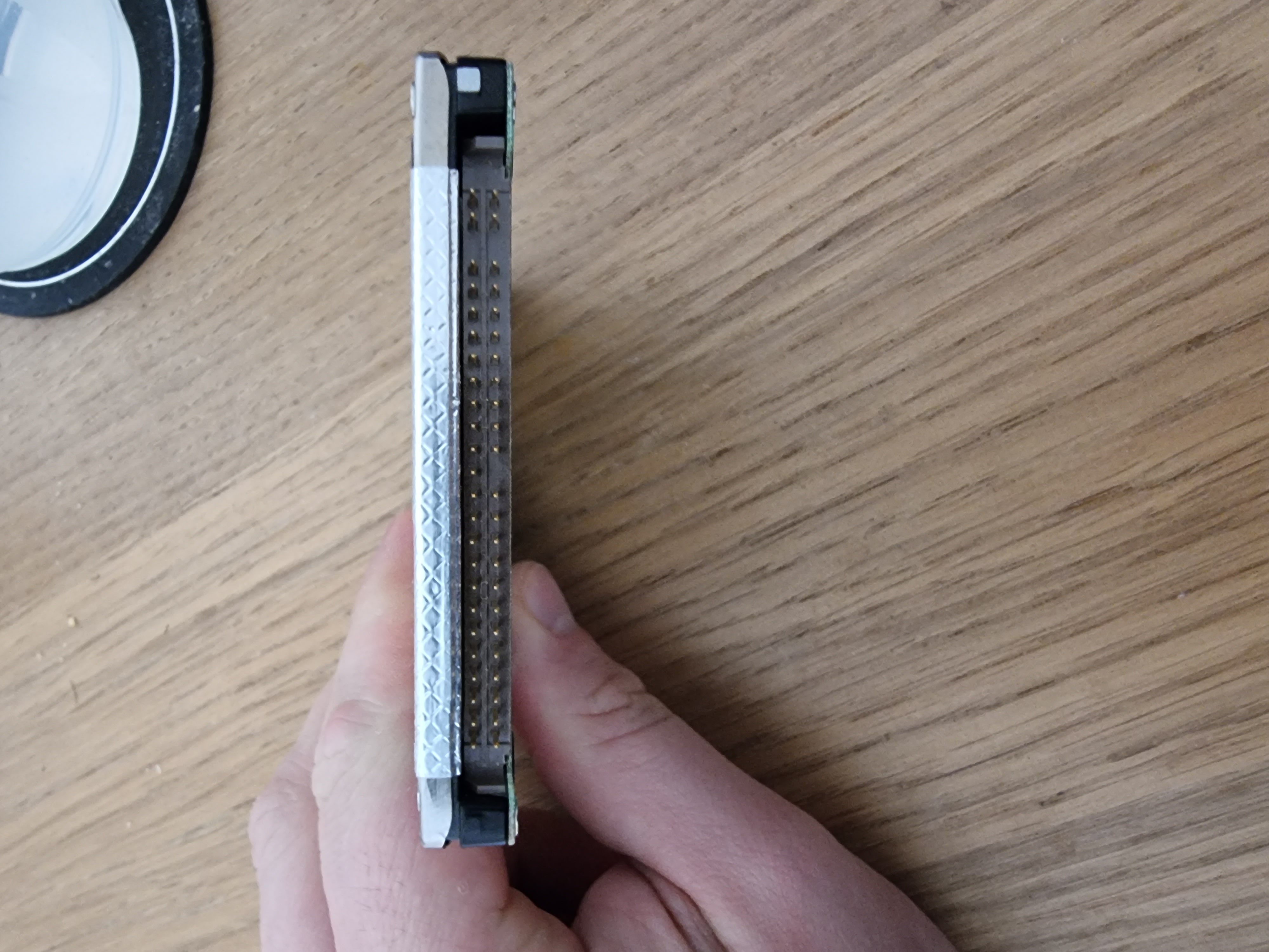

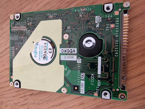

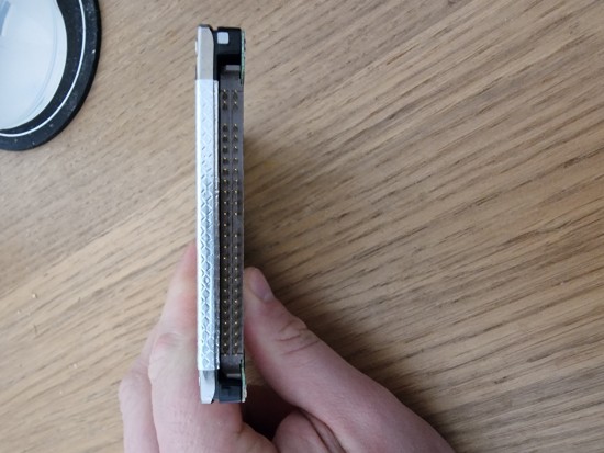

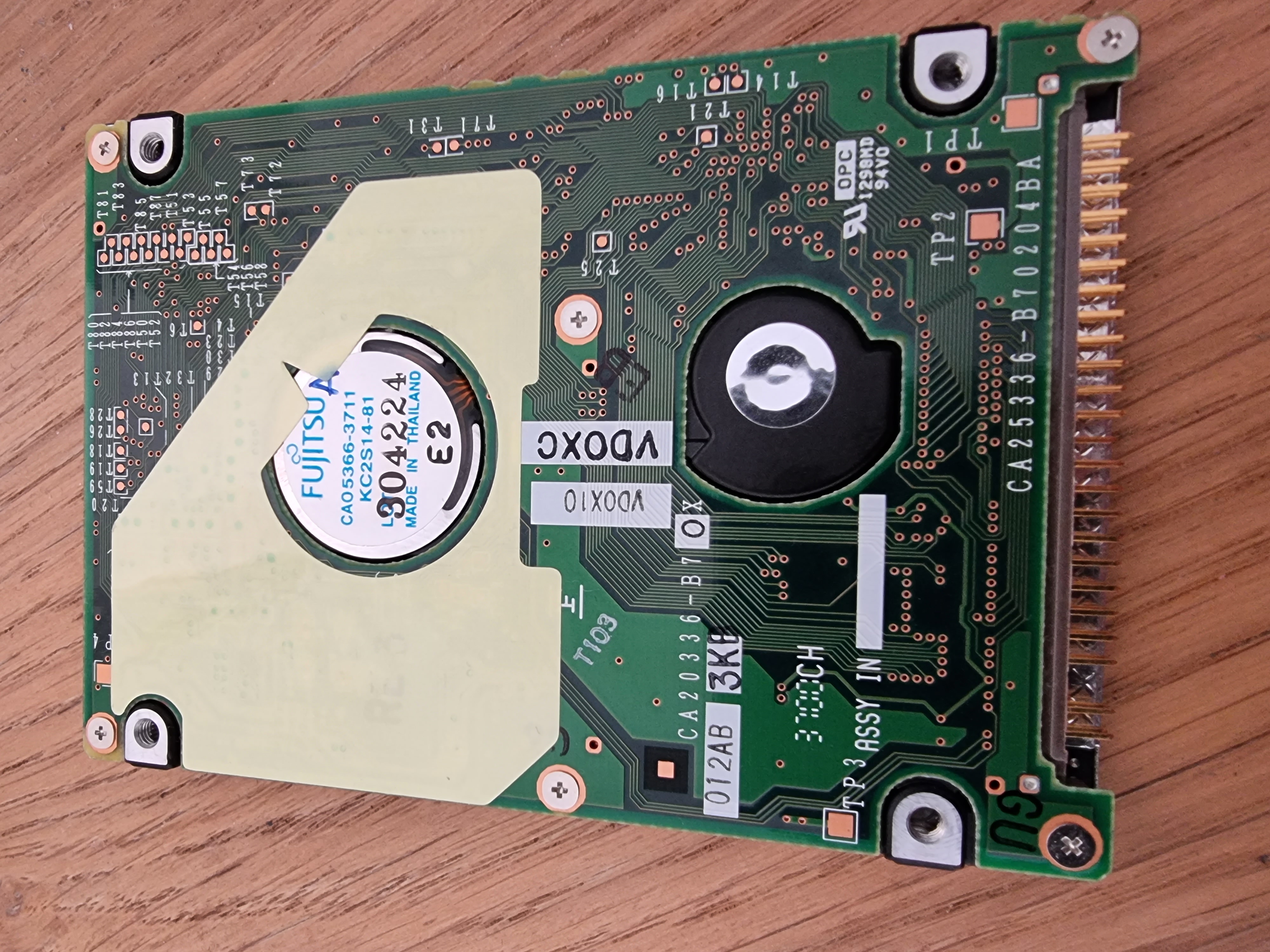

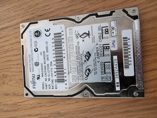

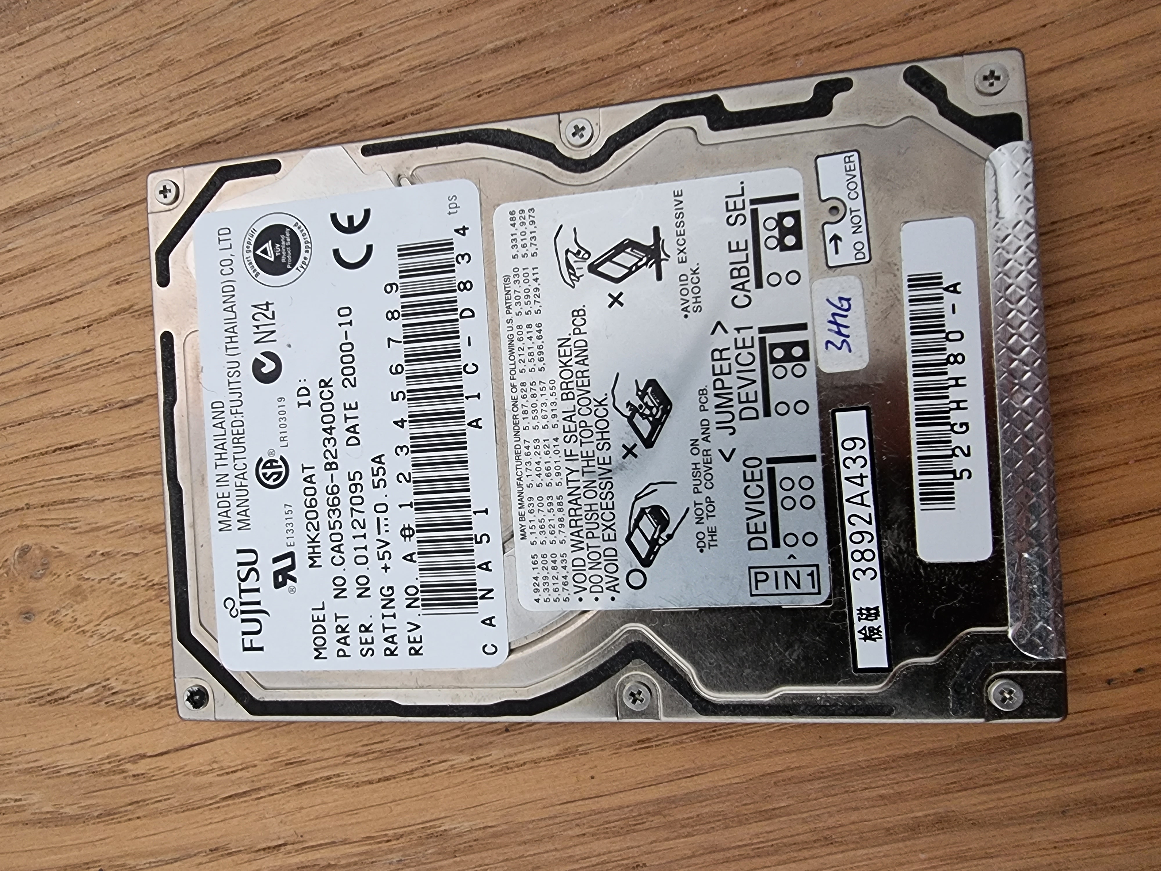

Hi all,
First-time poster to the forum so please be gentle.
I recently discovered my old Creative DAP6G02 Digital Audio Player which was in a bit of a worse for wear state. However, intact was the Fujitsu MHK2060AT IDE HDD. Sadly the audio player will never be able to restored however given the HDD is in a good state I was wondering what the likelihood of getting in running and seeing what information it holds is?
I've attached a couple of photos to the drive so you can see for yourselves should you need to:
I bought a few weeks ago a cheap USB to IDE converter but sadly I don't seem to be able to get anything from the drive, I'm wondering with it being a cheap mass-produced product whether it's the product not working rather than the drive itself?
Do you have any recommendations on products I could buy to test drive with and if so what the likelihood of getting this 22 year old drive running is? I should mention I don't have a jumper switch so would it be worth investing in that too?
Any help or advice you can provide would be greatly appreciated.

It sounds like the PCB is dead. I expect that a PCB swap is all you need.
 Post subject: Re: Fujitsu MHK2060AT Help
PostPosted: May 15th, 2022, 17:45
Posts: 17342
Here is your PCB:
https://i.ebayimg.com/images/g/MuEAAOSwPhdU45k0/s-l1600.jpg
This is the pinout of the IDE connector:
https://old.pinouts.ru/HD/Ata44Internal_pinout.shtml
Pins 41 and 42 (bottom left corner) connect to a tiny fuse and TVS diode. Measure their resistances with a multimeter.
