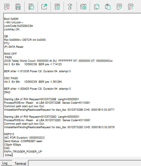

 Post subject: Hd 3 Err Blk
PostPosted: June 27th, 2022, 6:15
Joined: June 26th, 2019, 8:55
Posts: 43
Location: Indore, India
ST2000LM007-1R8174 SBK2
What is Wrong here ??
Reading starting sectors approx 20GB OK , And Most are showing Bad.
EDAC Value = 0000000018147566
Starting LBA of RW Request=0018149FD1  Length=00000A68

You have head problems at the minimum. These drives crash very easily and it's probably fast on it's way downhill. I would advise against running this any more before getting it to a data pro. Have to be careful with head swaps as only some replacements will be able to write to the system area well, others will try on power up and corrupt the SA losing unique translator data etc.

Actually , The Issue Resolved . I did translator Regenerator with writing original sys 28 35 back.
I got the Data 100%
