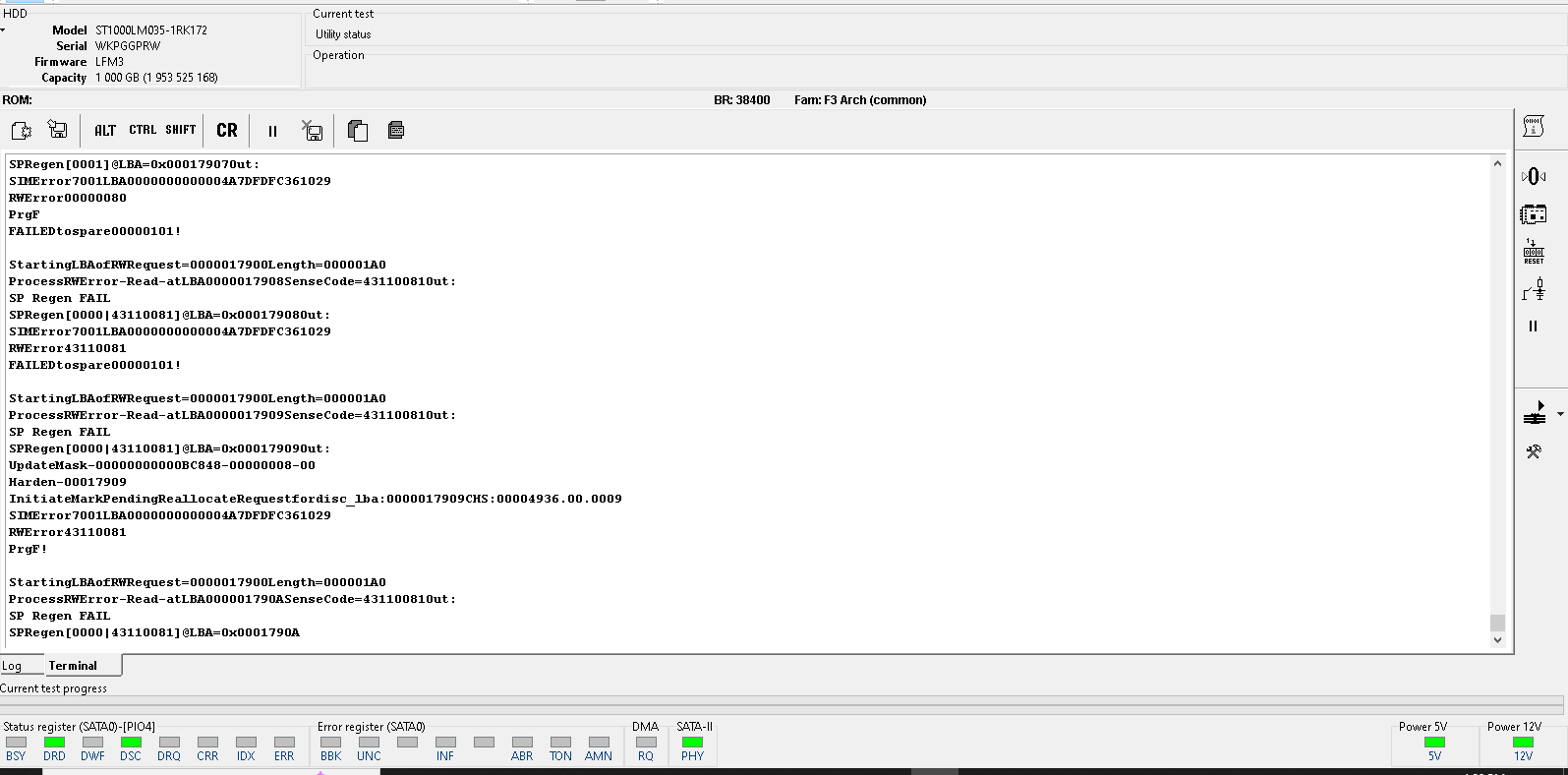

I have got ST1000LM035 , FW - LFM3 SMR hard disk .It stays busy but after some time gets ready. Terminal shows following messages.
What these messages means and how I should proceed for recovery.

FW backup, stabilize the drive by disabling function and block UA writing.
