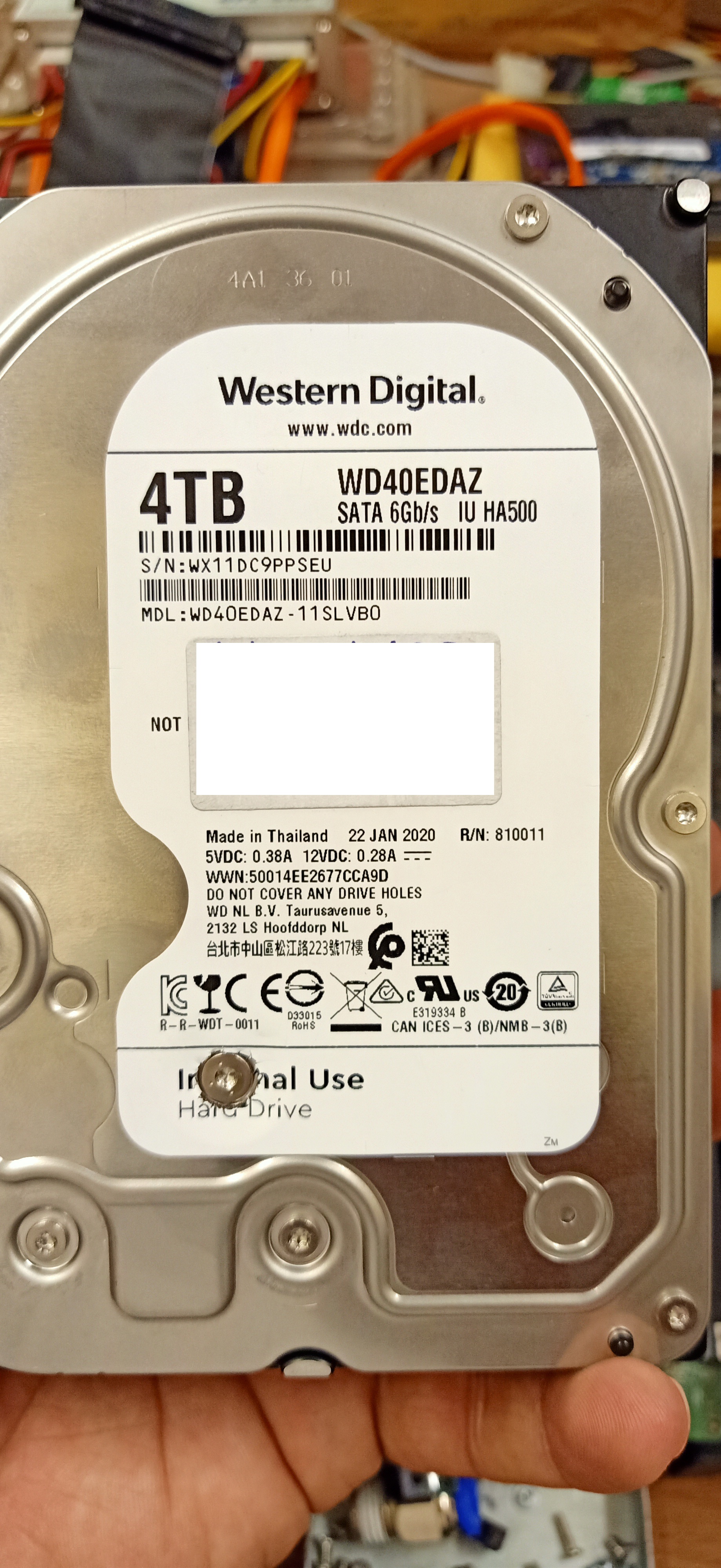

Hello Everyone ,
The HDD is Question is This
The customer says his kid dropped the hdd ,I do not remember if this HDD would click or the PCB would just not spin the HDD and get into ready state .Anyways yesterday i took another HDD of the same family and swapped heads .I would like to inform all of you that beware of these HDD's ,I have seen these in the following combinations
1 : 2 platter 4 heads bottom platter and heads missing
2 : 3 platters and 6 heads
3 : 3 platters and 5 heads with lower platter lower surface head missing
So the utilities from which we get head info are all misleading example it says heads installed 4 used 4 ,We assume lowest platter to have 2 and one up to have another set of heads making it 4 ,But it could be lowest platter is missing and we have middle and top platter used .I took the ROM Code out from the patient SED locked board using a programmer and programmed it on unlocked board using PC3K ,Board No is 8.....11 .Once powered on the Status registers in PC3k would go busy and immediately get ready state ,The HDD would not spinup .I have seen this happen in some other case also which i had done .The ROM is Attached To the post for anyone of you to analyze and help me .The file is renamed as a .zip though its .bin . Anyways i just though why not try ROM of the HSA donor HDD ,I programmed it into the ROM of the unlocked board and the HDD spinned and i was able to access all modules and even data .The data looks encrypted .I then programmed the DONOR HSA HDD Rom Code into patient ROM and resoldered it into the patient SED locked HDD PCB .The result was same Data is encrypted .Does a ROM make a difference to data encryption ,I do not have doors to work on these drives but i was having a though might be decryption keys are in MCU " Not Sure Though " thats why i tried Patient PCB . This is a External Casing HDD so i though might be the USB board has encryption ,I then used DONOR HSA HDD ROM programmed into Patient ROM and This ROM installed on patient Board with The WDC 3.5" USB To SATA Board on Deepspar Imager ,Result DATA is encrypted . I tried several other things which i will post in the evening possibly to this thread , Donor ROM is also attached to thread as .zip File .BTW both ROMS are different Versions

I would use original unlocked ROM / original PCB and let DE take care of USB bridge encryption if pressent.

In My case there is no spin with original rom and original pcb , so de is out of the question ,BTW sometime DE does not work with encryption of bridges
in rare cases

Ahh understood. Then you need to repair pcb or transplant MCU to working board. Else outsource to someone who can decrypt MCU encrypted data.

Nothing is wrong with my patient board other then bad rom code or modules IMHO , Please read my initial post once to understand my issue

Case Solved phewwww........
